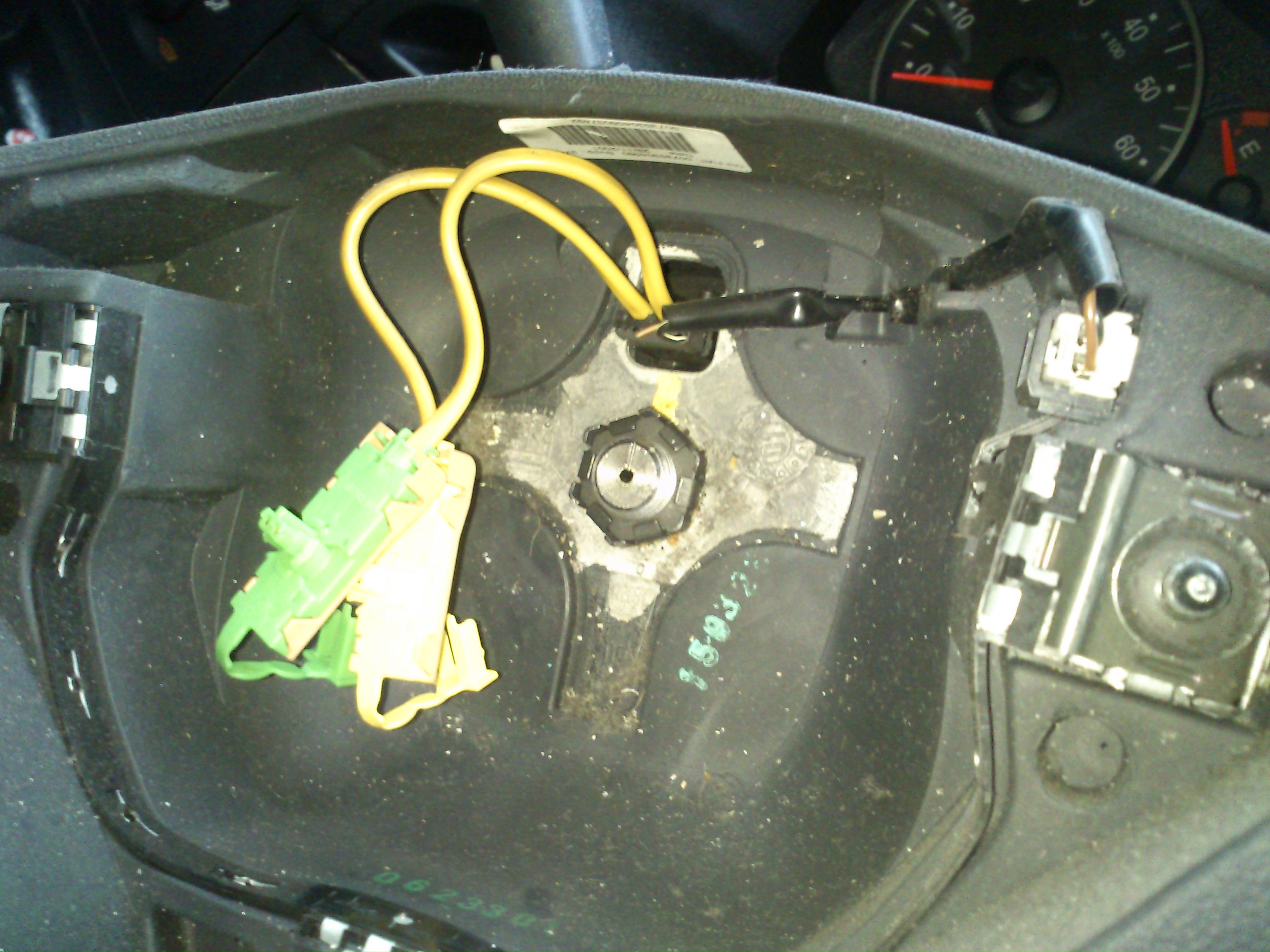

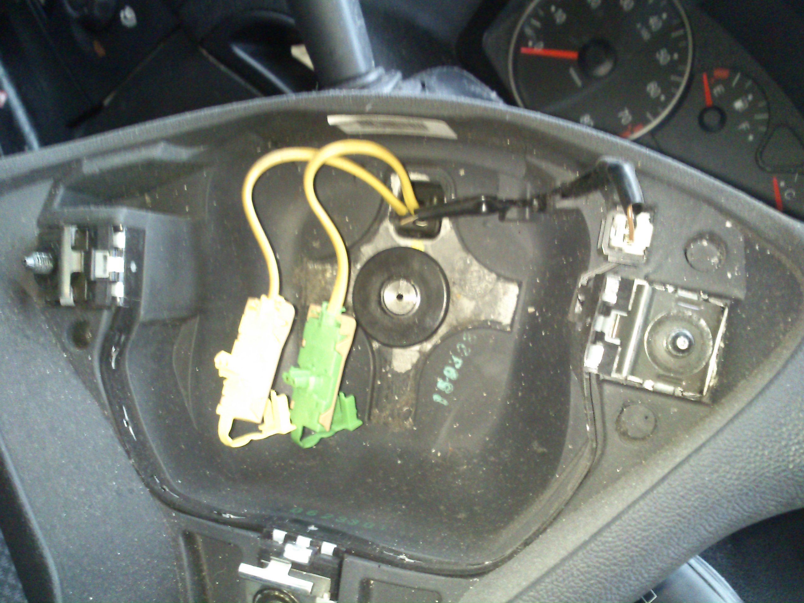

After you have undone the screws slowly pull the horn/airbag away to reveal 2 clips (green and yellow)
Place 2 finger nails under the yellow tab and lift it should unclip do the same with the other one and simply pull the plugs off

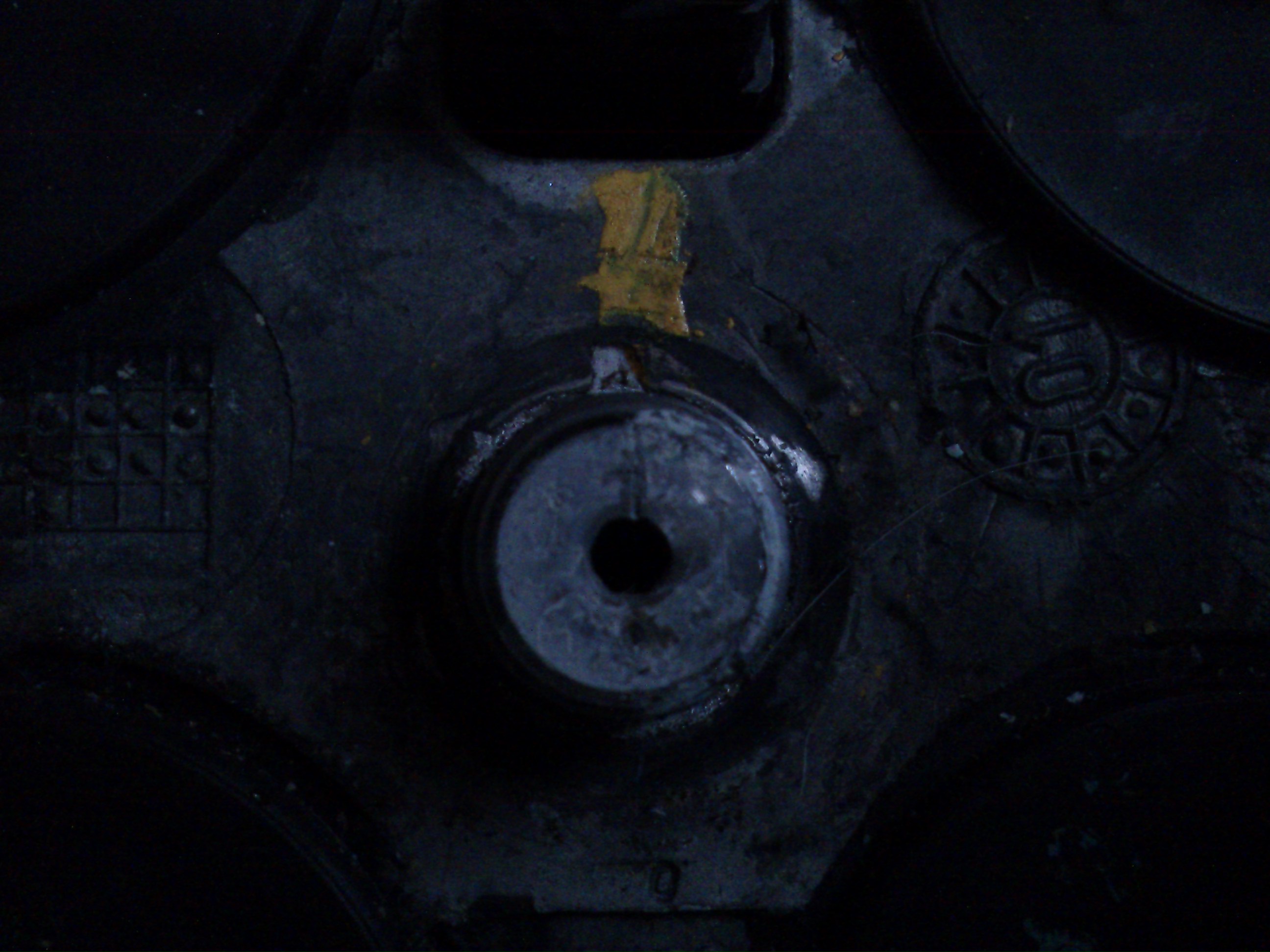

Remove the black tab cover in the centre of the steering wheel and it will reveal a bolt (next pic) use your ratchet, extension and the 24mm socket to crack it off and unplug the horn clip and slip off the steering wheel
when attaching the new steering wheel make sure to like up the line on the wheel (yellow mark) with the mark on the center circle after that just reverse what you did and your done.
