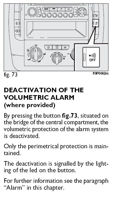

I have a Scudo 2.0D with an alarm that works off the remote key.
Does anyone know if its possible to turn the internal movement sensors off if the dog is in the car and the doors are locked. And how t0 do it?
Previous cars have had a routine to disable these internal movement sensors.
Any ideas appreciated. Thanks.
From the Scudo handbook:
