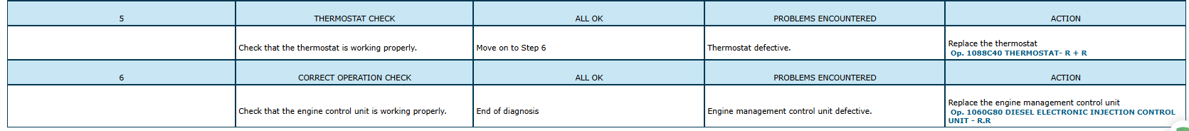

Here a Picture - where in the car is it?
WOW, thanks! I found them! All the help i dreamed of!!
I used An obd bluetooth device and "Car SCanner" on android. I also have similiar error codes on Diagbox. Could you look for this operation on the picture?
