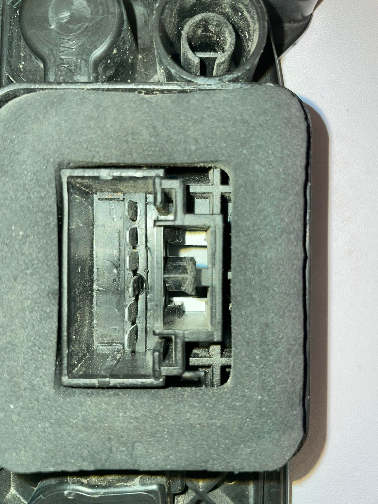

Hello, sorry for not answering sooner. I solved the problem by buying new holder for bulbs. Because near one pin plastic was melted and electricity didnt go through, so it went different way and caused the problems described above. But after a year it happened again. Again melted on the same spot. I dont know why it keeps melting but i deciced not to buy new holder and just wired it around the melted spot. Thanks all for answering!
Yes, everything coming from car was okay. I am posting image of one bulb holder that i have in shelf. Same issue happened to the second one. If you look at it, you can see that plastic around fourth pin from top is melted. And that caused the issue.
