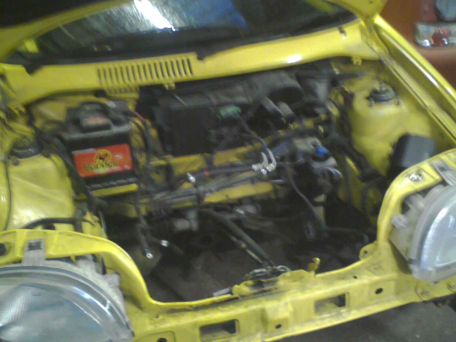

pah been pissing around past 2 days down the unit the engine in the yellow one was completely ****ed, i put the newly skimmed head on but was missing like a bastard and popping like the timing was out, cylinder 4 on the block was so badly corroded inside the block its got basically 2mm till its into the piston bore so i scrapped that engine and used my other one i had laying around which has done under 10k so like brand new.
got a oil pump for my 1.2 engine many thanks to Zak (slosei) for bringing it up for me.
thought instead of getting the yellow sei running by usign the standard engine now im just doing the swap between my 2 cars straight away just to recoupe money spent on the new sei by getting my old one done and sold.
spent most of day building the engine up and its now ready to be fitted into my old sei.
few pics of the rolling shell of the yellow one, still waiting for my drop kit and powerflex so i can get the cars suspension done + brakes.
few pointless pics for now :\
