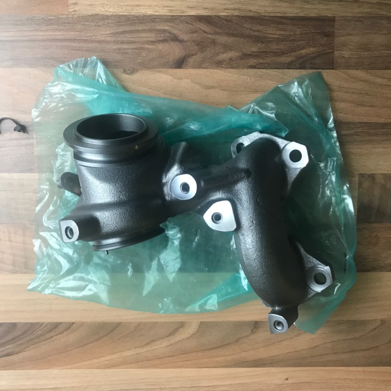

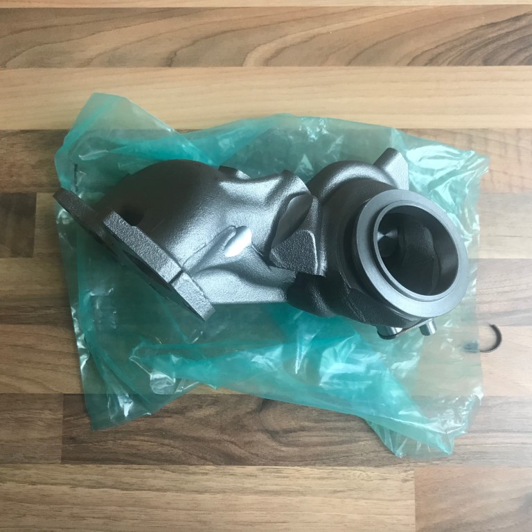

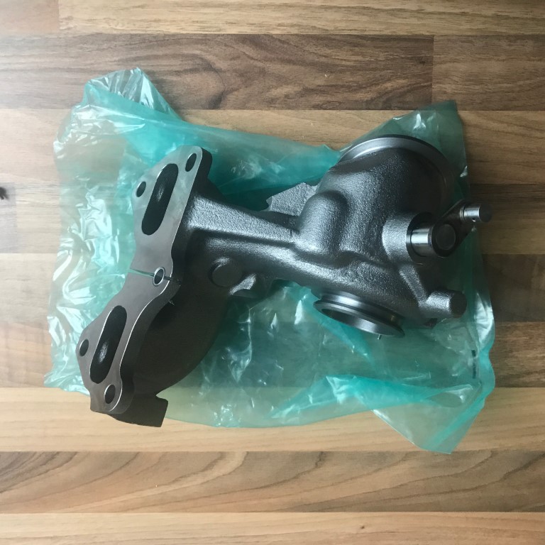

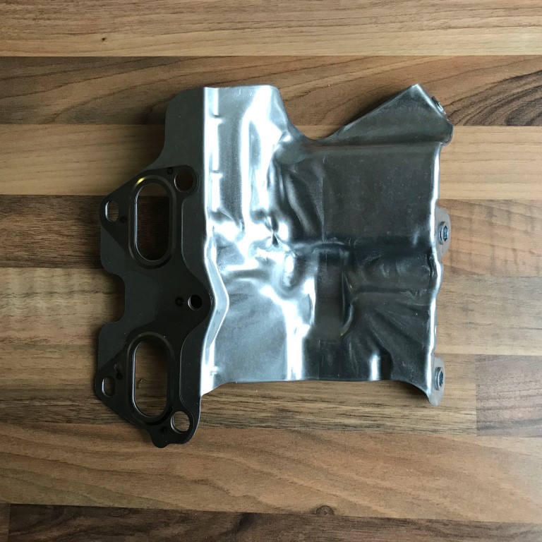

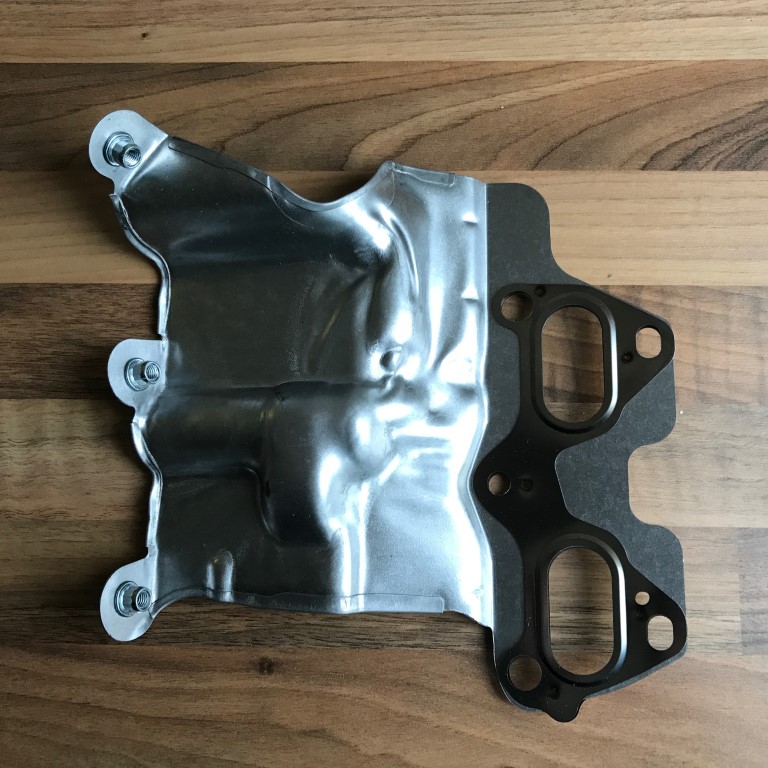

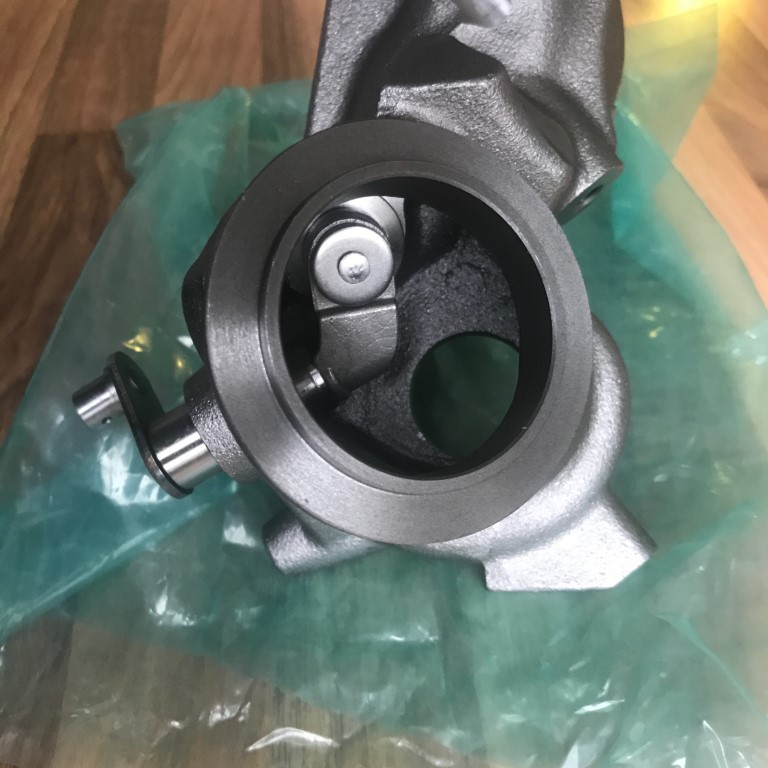

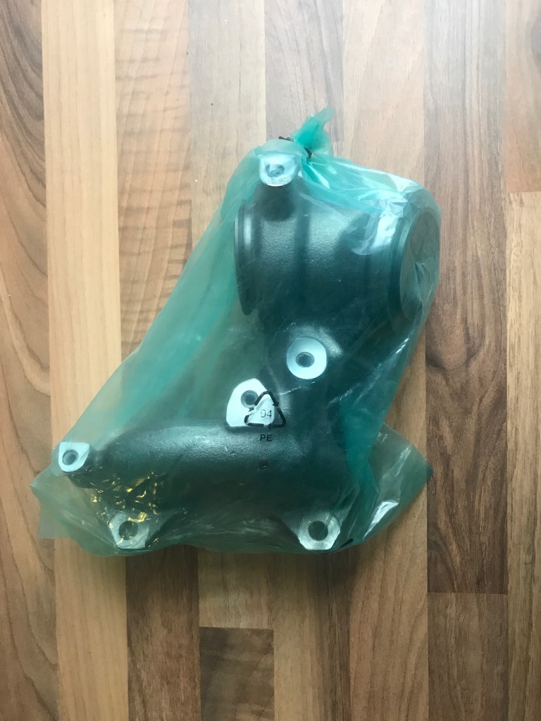

Yep, Famous first Generation 85 TA turbo problem.
Had the same problem with my last 85TA, at ± 57.000 Km, i did a Turbo revision/overhaul with a new original Mitsubishi turbo part.
Revision/Overhaul did cost all-in € 860,-
I suspect the wastegate spindle is furbar myself which has caused the actuator clevis to wear like it has, but the OP is saying it's just the clevis that is worn oval.
If it is just the clevis, seems a lot of money to spend if the clevis isn't in the kit!
Whatever, it makes sense to start cheap.
Replace the clevis first if they can and see how it goes after that.
I would be tempted to drill the clevis out round again and turn a small bush for the spindle to take up the slack.
