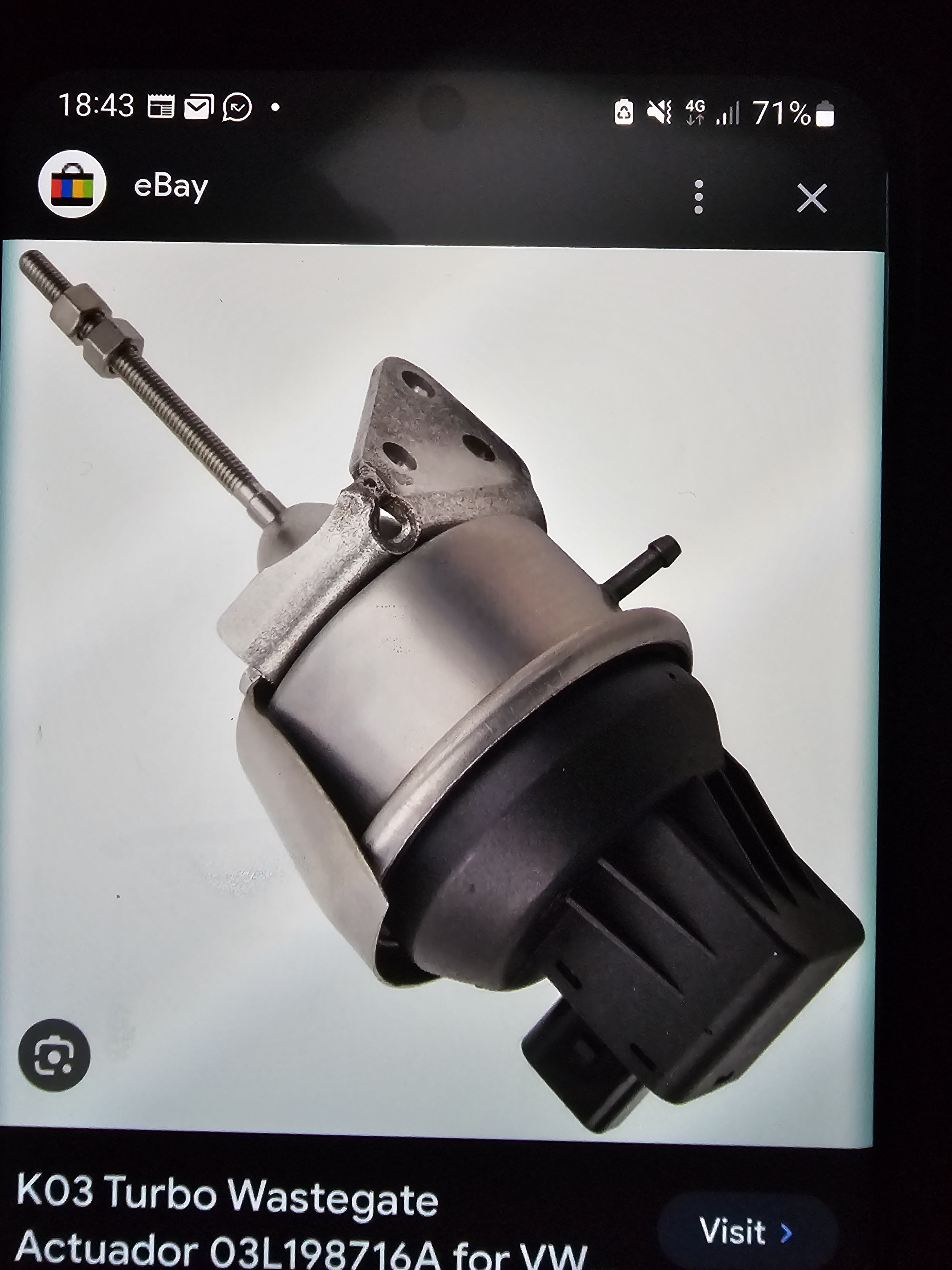

Thank you. We have now bought and fitted a new actuator. However, we are now having a code come up for overboost. Seems to be one problem after another at the moment.
Do you know how to calibrate the actuator? Unsure of where the bolts are supposed to sit.

Is it possible if the previous owner was stupid enough to blank/tape over warning lights,maybe he played around with the turbo boost position it's self, so need correcting on the new one rather than using same settings as on the old one as you would expect?
Yes, that's what we are now thinking too. Off to the garage again today, hopefully it'll be sorted 🤞🏻
