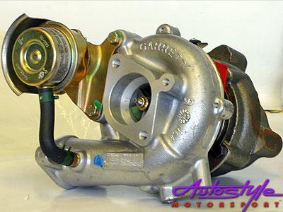

0.8bar? On stock pistons? No way - they'll either need machining or bespoke ones made up.
The 1108 and 1242 are more or less equal in terms of reliability.
1242 has much less meat on the pistons so would be harder to drop the CR to run decent boost.
i spoke to VAD and they confirmed spacers on the head lead to shorter gasket life.
originally VAD skimmed the OE pistons so i would be looking ot turbo the 1108 with skimmed pistons or custom if budget permits
Thanx for replies.
Don't want to put spacer bet gasket, can get a 3mm copper gasket made, as standart gasket is 1.9 mm. thus this will drop the cr to roundabout 8 - 8.5:1.
what boost can I run on standart pistons?.
want to put mpi on the 1108 or 1242 with standalone management for fuel and ignition.

All Im gonna say is learn to read the compressor map, understand it fully and you will know what engine it'll work on best.
Going off vAD, It should be ok on either though...although I personally dont like the way theyve done things, and as a result, there is part of me that questions their turbo choice.
