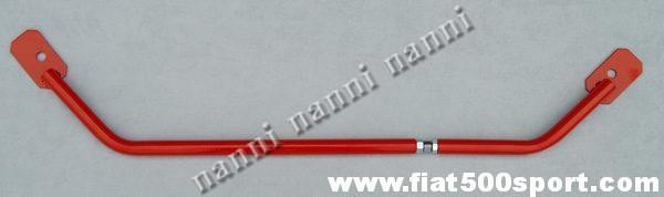

Just for interest, did the previous owner fit a brace-bar between the top of the front damper units? I am looking at doing the same front suspension mod and have a pair of the GAZ coil-over units sitting in my study waiting to be fitted when I can find somebody who will supply me with JUST the cross-link and the lower wish-bones.

Copy of your question - Just for interest, did the previous owner fit a brace-bar between the top of the front damper units?
No I don't think so, both n/a & o/s are totally independent to each other.

The brace-bar (if fitted) would fit across the front luggage compartment, just in front of the fuel tank and goes from damper top to damper top---you would see it as soon as you opened the bonnet. The Weber 40 is a big carb, and often difficult to jet well---I have a Dellorto 32/28 on my (tuned) 650 engine--easy to set up and a good starter hot or cold. I have a 35/75/75/35 cam in my engine---goes very nicely, pulls well and a pleasure to drive.

Hi based in Bedford uk I will try & upload some photos. Definitely not got a brace bar fitted but it would make logical sense to fit one as the stress from the wheels go straight into the top of the wheel arch. I cannot see how they can charge £70 or so, it would be an easy job to make one up.

Something like this.
Here's a challenge for you "ClassicFiat500" (sorry, I don't know your name)---if you can make a good version of that (adjustable) brace bar for less than £70, put me down for one please! It has to be adjustable in order to get the tension correct and it has to be that shape in order to go around (in front of) the fuel tank. I am just outside Chester---but INSIDE Wales (Flintshire) by 200yds!
