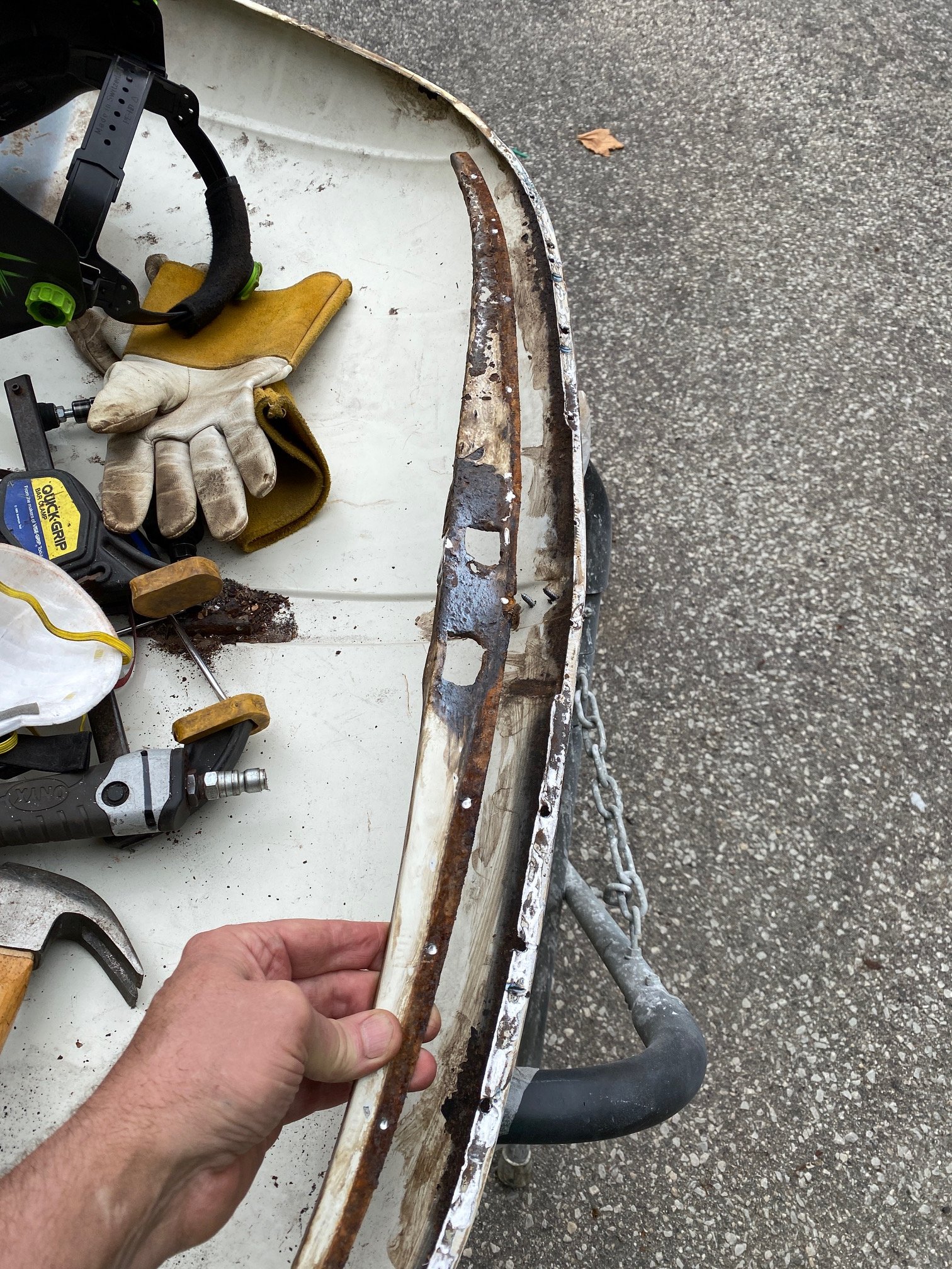

I need to replace the front brace/latching panel on my 500L. Does anyone know if this is offered as a separate part from the vendors? Thanks.
I need to replace the front brace/latching panel on my 500L. Does anyone know if this is offered as a separate part from the vendors? Thanks.View attachment 474114
I have had a look through a number of sites, and that individual part does seem to one that is available. I had a look at a number of 2nd hand bonnets, and most of them suffer the same problem as yours. I also looked at the price of a NEW bonnet, and they are cheaper than that being asked for the 2nd hand
ones! (Motobambino in England---£120, part number:---BP0011). The 'safety-catch' IS available as a separate part. Alternatively, why not weld in a flat plate and then secure it with a couple of well spaced rubber catches, and use a pair of little rubber 'buffers' to prevent the bonnet rattling and give some tension to the catches. If you would like to contact me direct ( [email protected]) I can send you a photo of my car where I have done this.
Thanks for your response. Lots of sheet metal available but not the trunk and engine lid braces. I don't need to replace the lid itself so I may have a go at trying to make one.
