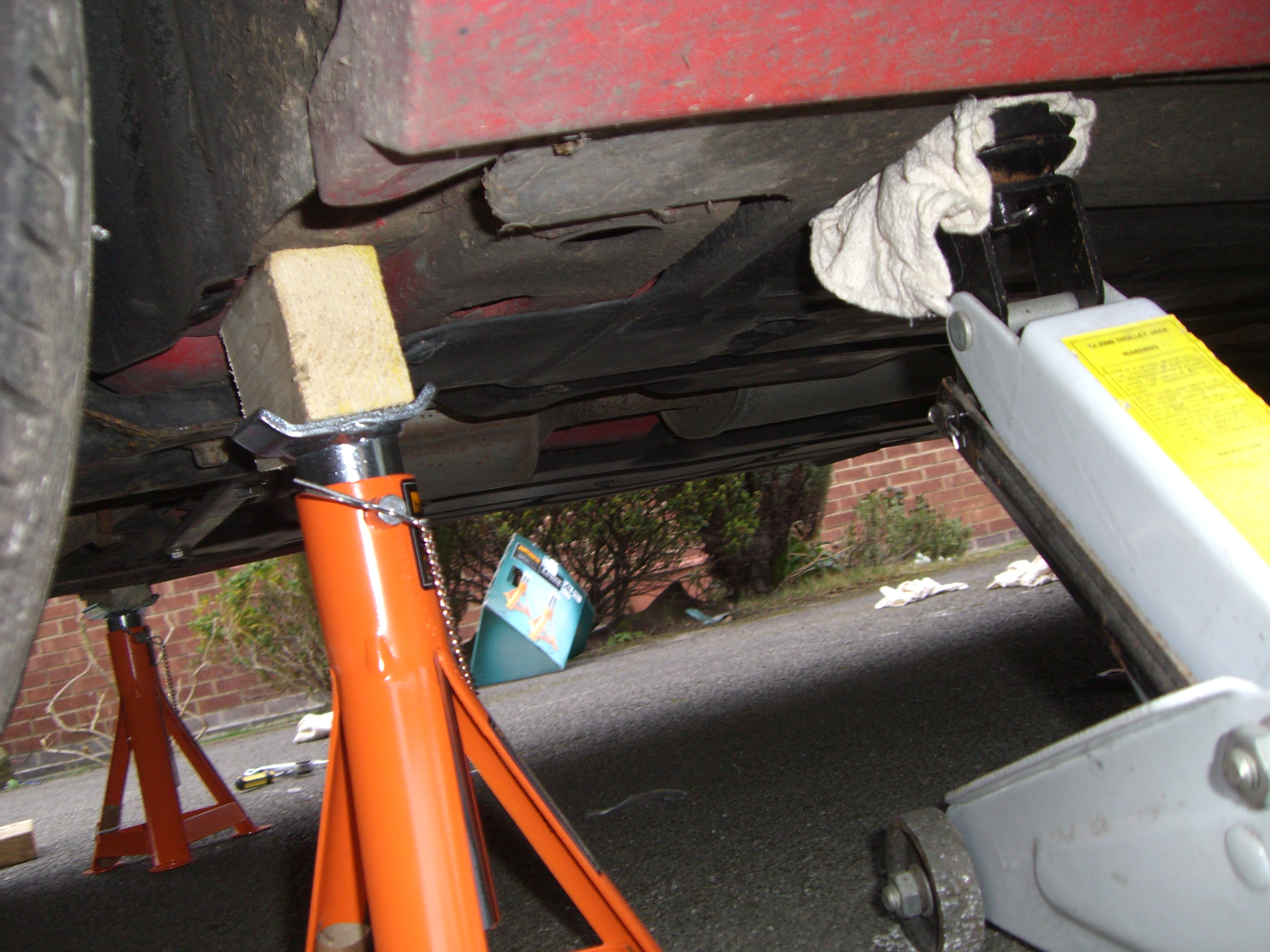

I have certainly jacked the daughter's car with a trolley jack on the actual recommended jacking points (the downward-pointing flange where the three thicknesses of steel that make up the sill are spot-welded together) and they haven't bent. You do, however, chip the paint in doing so. More often, I use a block of wood on top of the jack, with the grain going ACROSS the flange, otherwise there's a danger of it splitting. I put axle stands along the sill too - as close to the jacking points as the jack will allow.
