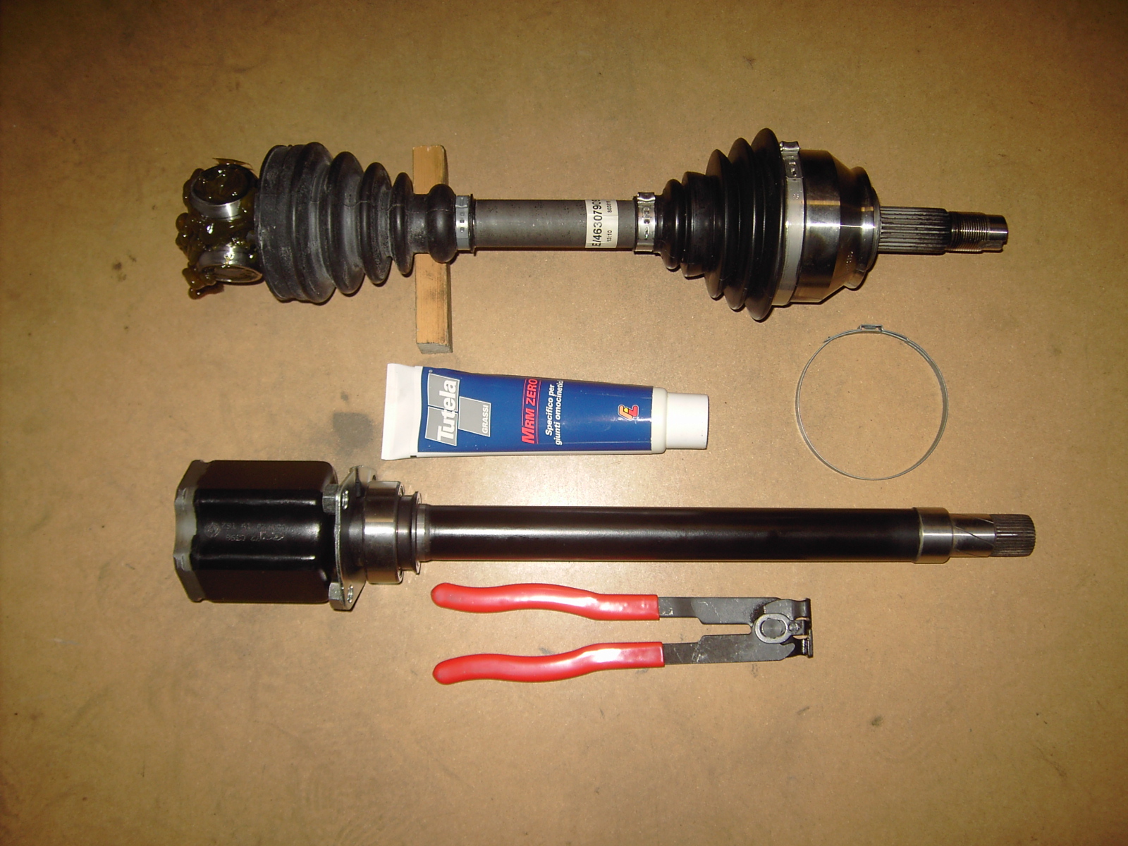

I got round to fixing this. It was a lot more straightforward than I was fearing.
To remove the driveshaft, I just had to undo the suspension damper bolts vs the hub and then the track rod end (all 17mm bolts). I also removed the brake caliper and tied it out of the way.
I also planned to remove the driveshaft from the hub but my 36mm socket (for the wheel nut) is a thick "impact" socket and didn't fit inside the nut housing.. so Plan B was to leave the driveshaft in the hub. There was enough free play to pull the spider out and rotate it out.
See what I found here:
https://www.fiatforum.com/stilo/452867-bad-vibes.html?p=4300835
The spider is held on with a circlip (the type with "ears" rather than the annoying "snap-ring" style so came off easily with a regular circlip pliers.
The old spider surprisingly came off the driveshaft with a few taps of a mallet. I guess it wore some extra room for itself on the splines when it was all juddery and vibrating... but anyway, nice and simple.
The new Spider was an Original Birth.. looks okay and just £22. It was a tight fit to get into the shaft. I had to double check the number of splines but it was the right size, just a tight fit. There's a concave face and a flat face. The concave face is the end that goes on first.
I had to drive it on using an old Imperial socket of about 25mm in size. The shaft is 23mm so the socket had to be big enough to just sit on the (flat face of the) inner casting. When it has on far enough to show the circlip groove, I refitted the circlip.
Then I cleaned out the cup and the gaitor. The old needle rollers and pieces of them were all over the inside of the cup and the gaitor, so I removed all the old grease and cleaned out all the crevices of the gaitor.
Then I stuffed the new spider back in the cup and lubed it with some CV joint grease... before reassembling the Track Rod End and the damper.
I managed to re-use the gaitor clip and the gaitor was very good so I left it on there. I had a spare gaitor and clip just in case it looked any way worn out, since changing the gaitor later would be a spider-off job... and it's a lot tighter on the driveshaft now.
I also had a look at the CV joint. Just removed the gaitor and had a look inside but that looked very greasy and in good condition, so I put it back and left it alone.
The car is miles better now... almost perfect. On right hand bends I can now feel a veeeery light and occasional vibe from the nearside driveshaft... :D so early next year (after the MOT/once Doctor Death has had an input) I'll probably fit a new spider on the nearside too, since it's done the same mileage as the one that failed, so might be similarly a little tired.
The two remaining rings on the failed Spider have "some" but not much wear in the bearings... so on the other hand, apart from the one that failed, the spiders look in really good nick (original 2004 Fiat parts and 150,000 miles).
I've had a rummage around for the MRM Zero (or the similar-spec' sounding Star 700) and it seems to be the proverbial rocking horse poo.
It looks like it has to be a NLGI 0 spec' grease. The regular greases available are all NLGI 2 (including the CV joint grease I have used) which is just thicker/heavier. If it was summer, I'd be inclined to leave it.. but it's winter now, so the beast needs thinner grease that won't turn to paste at (I'm expecting) colder-to-sub zero temperatures.
Spider does seem to want 140ml... which is about 40% of a Coca Cola can.. I probably didn't pack mine with that much.. :eek:
