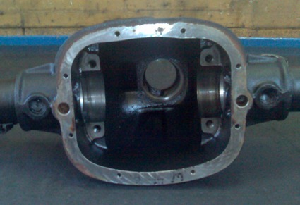

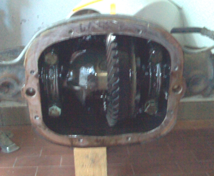

Hello :). Again me:). I want to ask you guys something again. Have somebody some detail photos of rear diff. and axel from inside?
I start to planing diff. lock and befour I dismount all axel and find out that it´s total stupidity I want too see that it´s bit posible:).

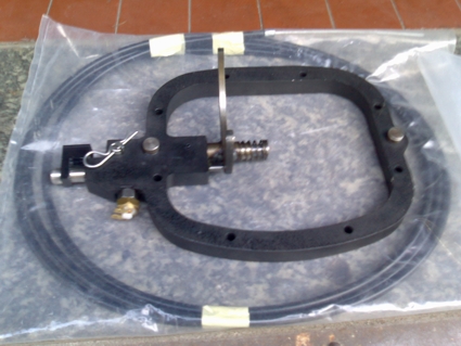

Well Martin, I found this onto Italian 4x4 Panda Classic forum, into section diff block. I think this Panda have normal handbrake, but this two small commands (I think they comme from -two engine powered boats, as a acceleration wire commands). Each small side bar is connected (by wire) to left or to right rear hand brake command bar (for each wheel separately). This two extra commands have to be pulled forward for a little (to driver seat direction), only one by one (depends which side rear wheel have to be stopped temporarly), and I see some front bar to choose which side bar has to be activated at the time.
Its a pitty that this is only one picture, without any textual explanation.

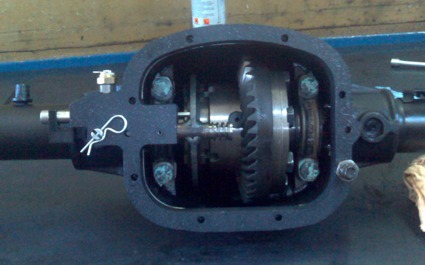

Onto this Italian 4x4 theme I found few pic of aftermarket diff blocade and his components, but I am not so familiar with engeenering matters.
I just think you can find one more Idea as a alternative to very expensive original diff blocade and very complicated diff blocade components.
Best regards
Aca

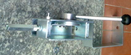

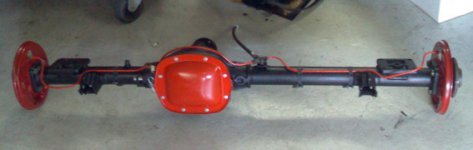

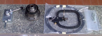

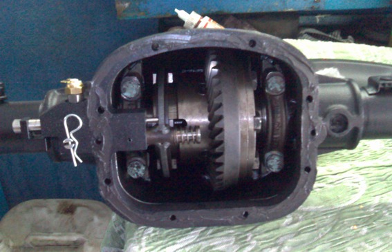

But see this pic. You may have some ideas

I´ve seen these photos. this that solution for rich people which costs 600 or 700€:(. There is completely changed diff. and added that black thing which is controled from that lever. I just need to buy another axel and try my plan on it. If it will be right I will use this axel and write it there. But I can´t say when it will be implemented:cry::cry:. But if I will be succesfull be sure that I will wright it I will give there some drawing of it.
