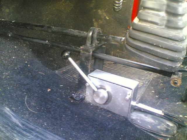

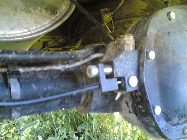

Martin, I have good news for you(y) I searched italian Panda 4x4 forum and I found a thread "Blocco differenziale posteriore" which means "Rear diff lock". The thread has 24 pages, with lots of photos. I asked in english "Is it possible to mount diff lock?" and one of italians answered "Sure it is":) So all you must do now is to learn italian, register yourself on italian forum, read everything and make a diff lock:D Two photos below as a proof.
Sutjeska
BTW: Did I say that italians are the best in the world in off-road tuning? Yes, I did!

Martin, this thread is in the "Fiat Panda 4x4 I e II serie (Old panda)- L'officina", not in "Preparazioni Off Road". You can read it(y)
Sutjeska
Thanks but little bit late:D. I´ve found it:). But thank you. Now I am starting to learn Italian:D
