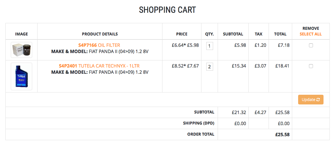

The owners manual and S4P as well as many transmission oils have EP in the spec so I can't see it causing harm?
Shop4Parts have assured me (with screenshot) that according to my VIN number that Petronas product is compatible, so I'm ordering it tonight. I've been talking about this long enough!
Wonder if it'll make the gear change any smoother.. either way I'll be 'convinced' it does regardless but is there any technical reason to believe for or against that phenomenon?!
Finally ordered.. £35 altogether though.. Hit with the £7 shipping .. maybe because I'm in N. Ireland but well, I've been talking about it long enough time to get the gear box oil changed!
