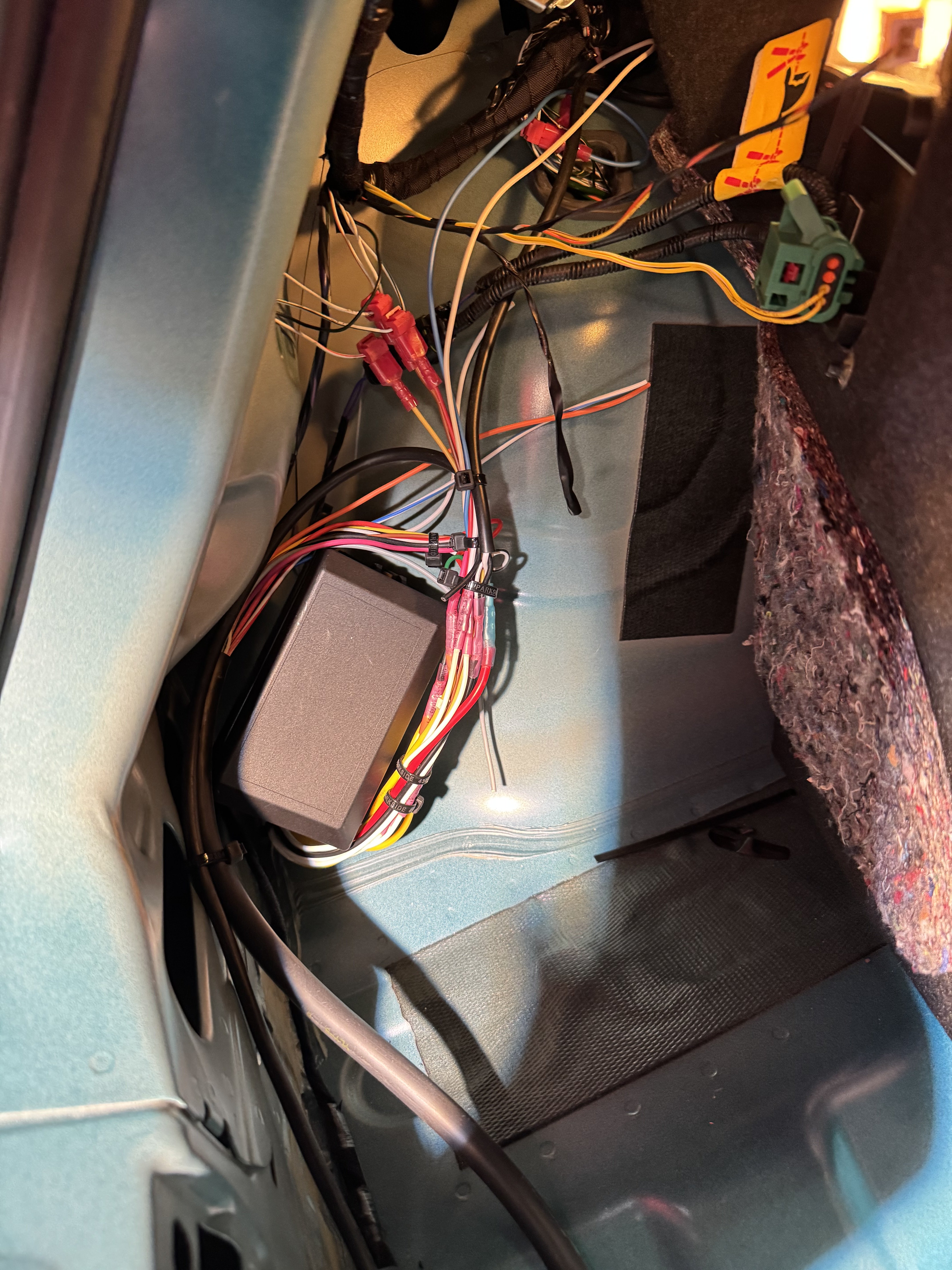

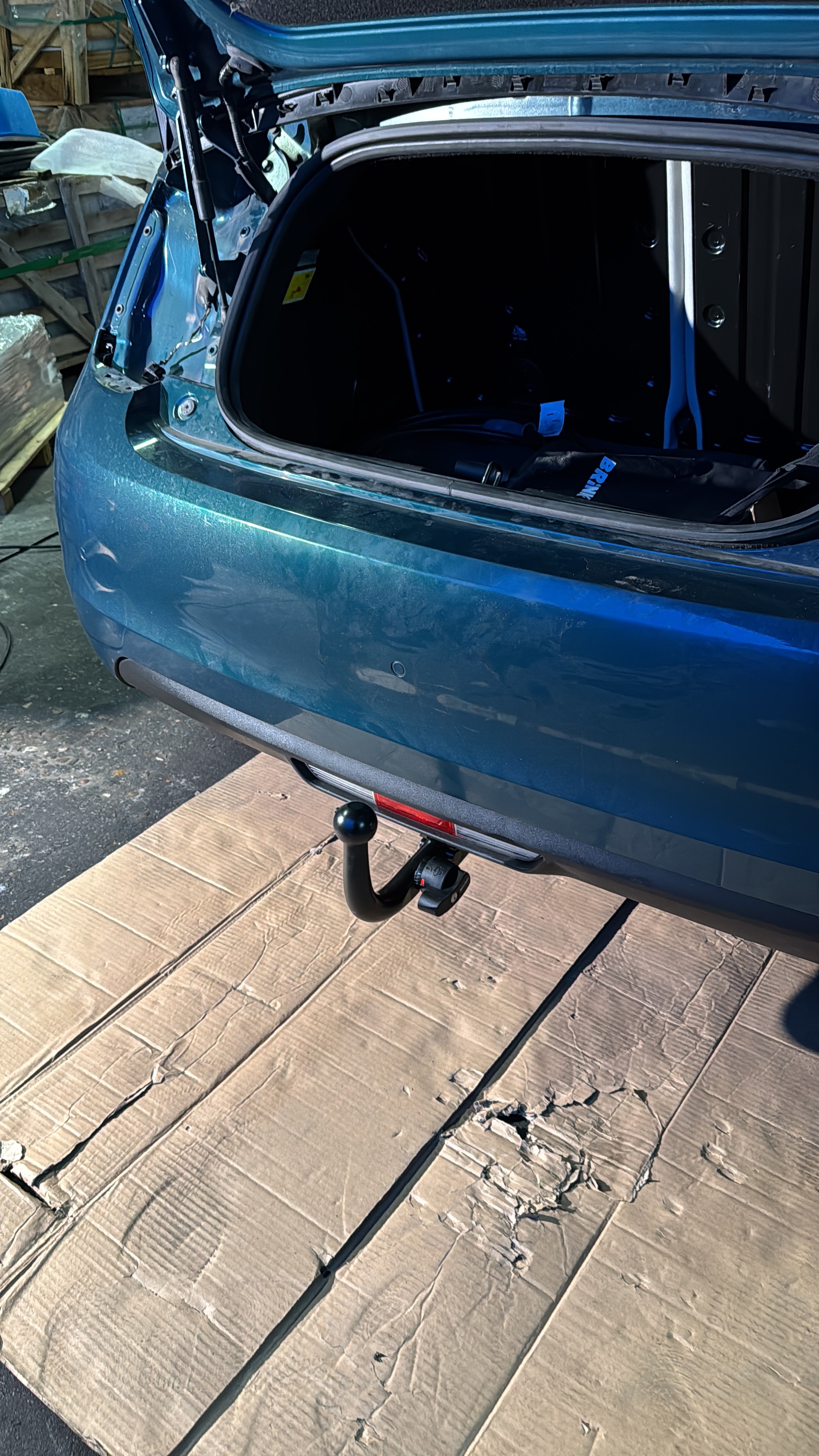

Hello,
I have bought a trailer hitch for my fiat 500e laprima 2020. I am going to use it to tow something small om private property. I would also use it for a bike rack. Does anyone have experience with the wiring of the socket? I cannot find any diagrams of where to connect to or what wires go to the back lights.

UPDATE i installed the hitch, and made the electrical with a 6 way relay and fuse box.
Works like a dream, enjoy the pictures and thanks for the help
