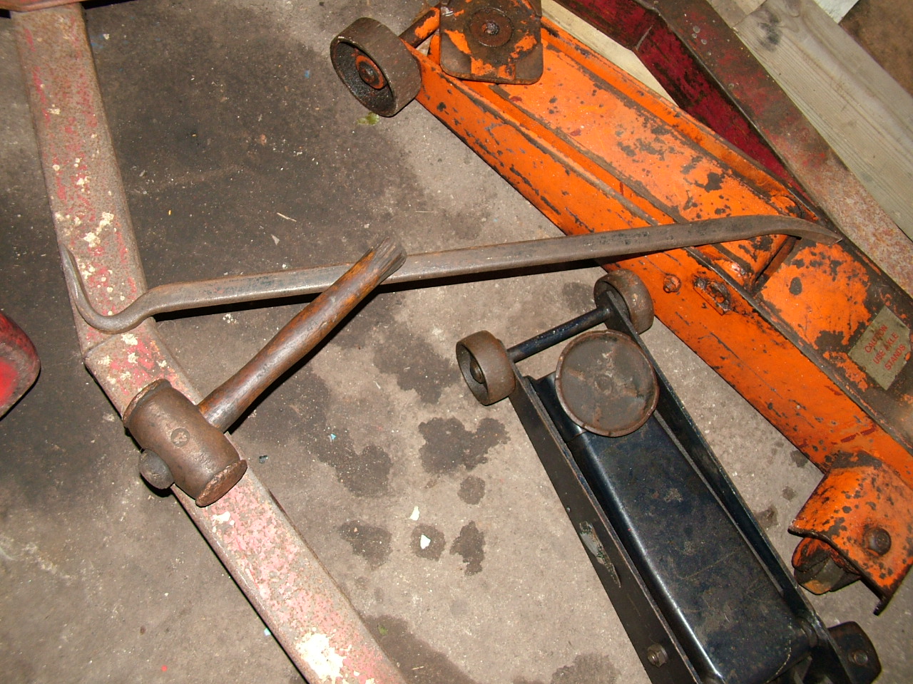

Working on my own often I have perfected a technic of standing on the crow bar whilst swinging the mallet, the crow bar is important as it encourages separation at the point of impact. In the photo is a Number Four Thor copper mallet and one of my crowbars, the orange jack is a 6 tonne commercial one I originally bought when working on a boat I had. Those tools have worked on 3.5 tonne Iveco Dailys and Fiat Ducatos and many others over the years.
Though nowadays at 70 if I couldn't break the taper with the first two blows I would have to sit down.:)
If you are replacing the ball joint I think you will even if you manage to undo bolts in place the taper will be harder to shift as arm will move more.
Note I don't spend much time polishing my tools as garage is damp and the "patina" is a rust preventative, honestly.;)

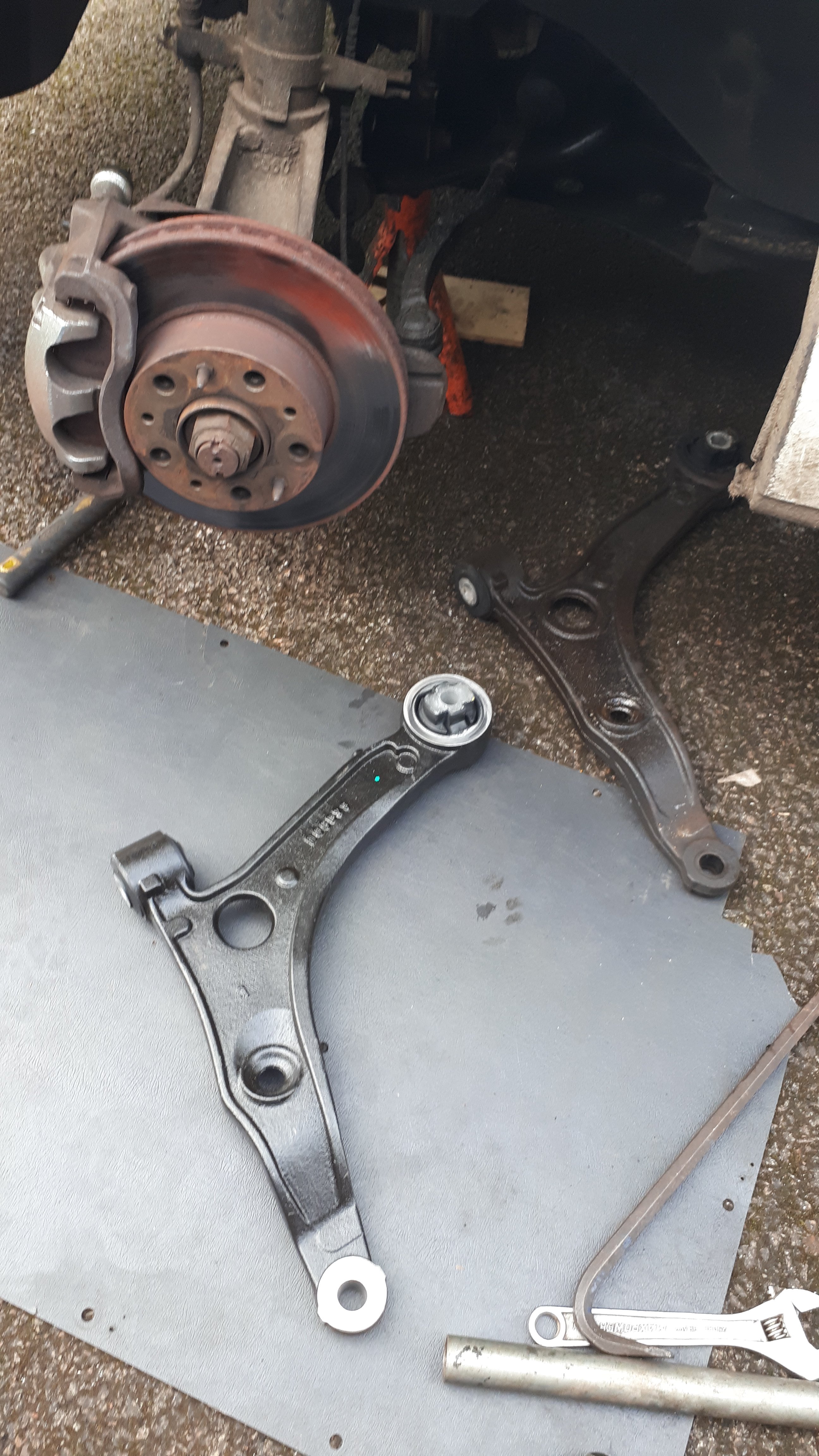

I'm actually replacing both wishbones.
Thinking I can pound a wishbone that's off with both hands, all the cold hard fury at my disposal and at a healthy distance from my kneecaps.

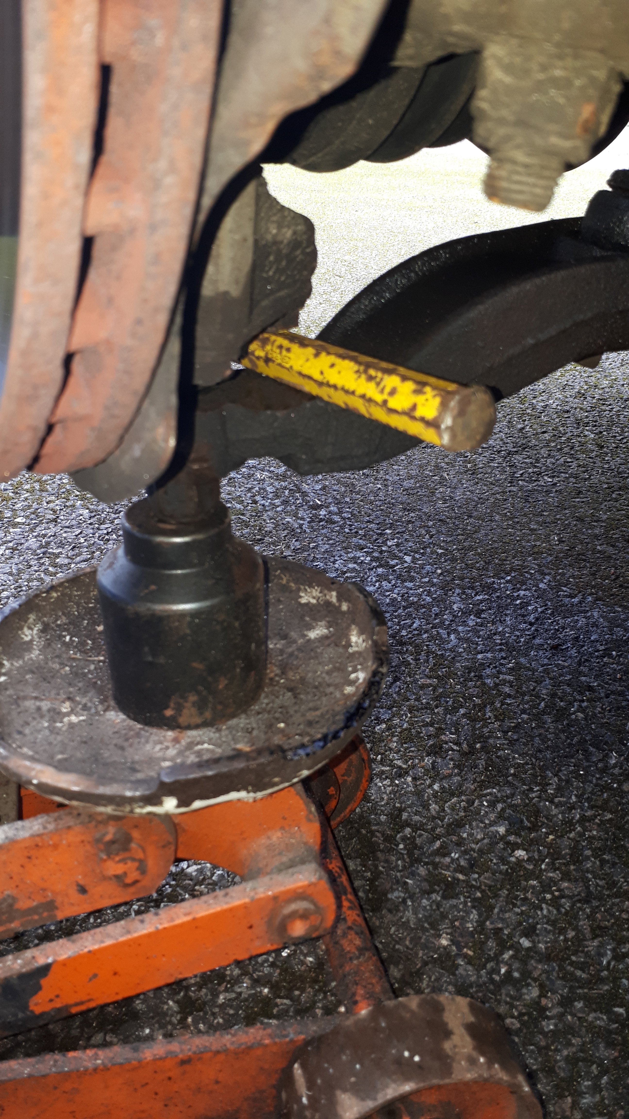

Right, here's what happened, folks.
Got the van up on stands, turned the steering to give good access, slackened off the nut a few turns, got a jack under the nut, and raised it till the nut was bearing most of the weight of the van.
Couple of good swings with the wee sledgehammer and did it separate?
Did it ****!
I had no means of bearing down hard on the wishbone so there was no real separating force at play.
Just before I gave up and went to buy a big joint splitter, I had a last search on youtube and found THIS technique:
Jack under the nut, raise until fully laden, insert a steel wedge (chisel) between wishbone and balljoint flange - then lower the jack...
BANG. Joint split! No hammering, sweet as nut. ❤
