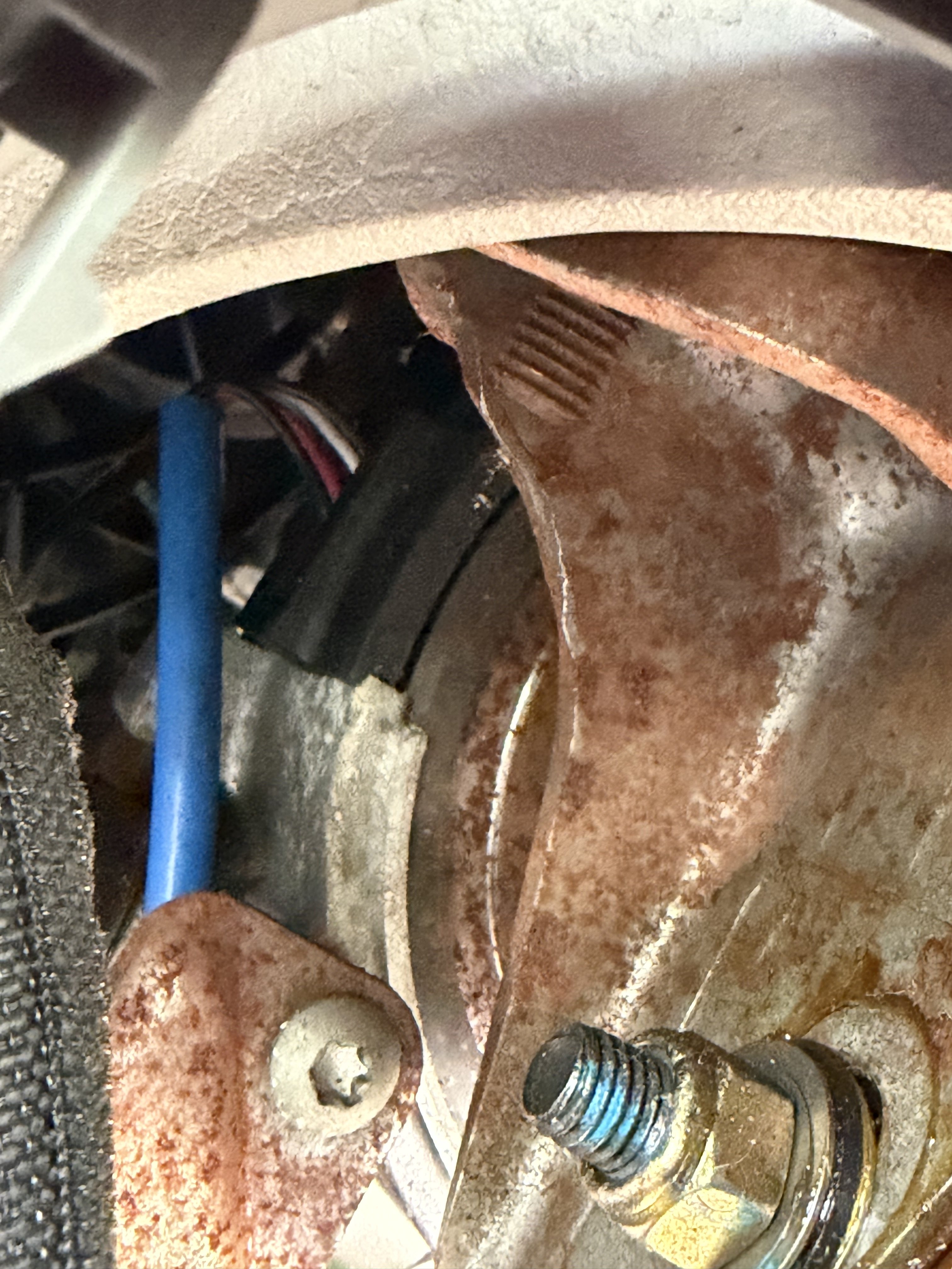

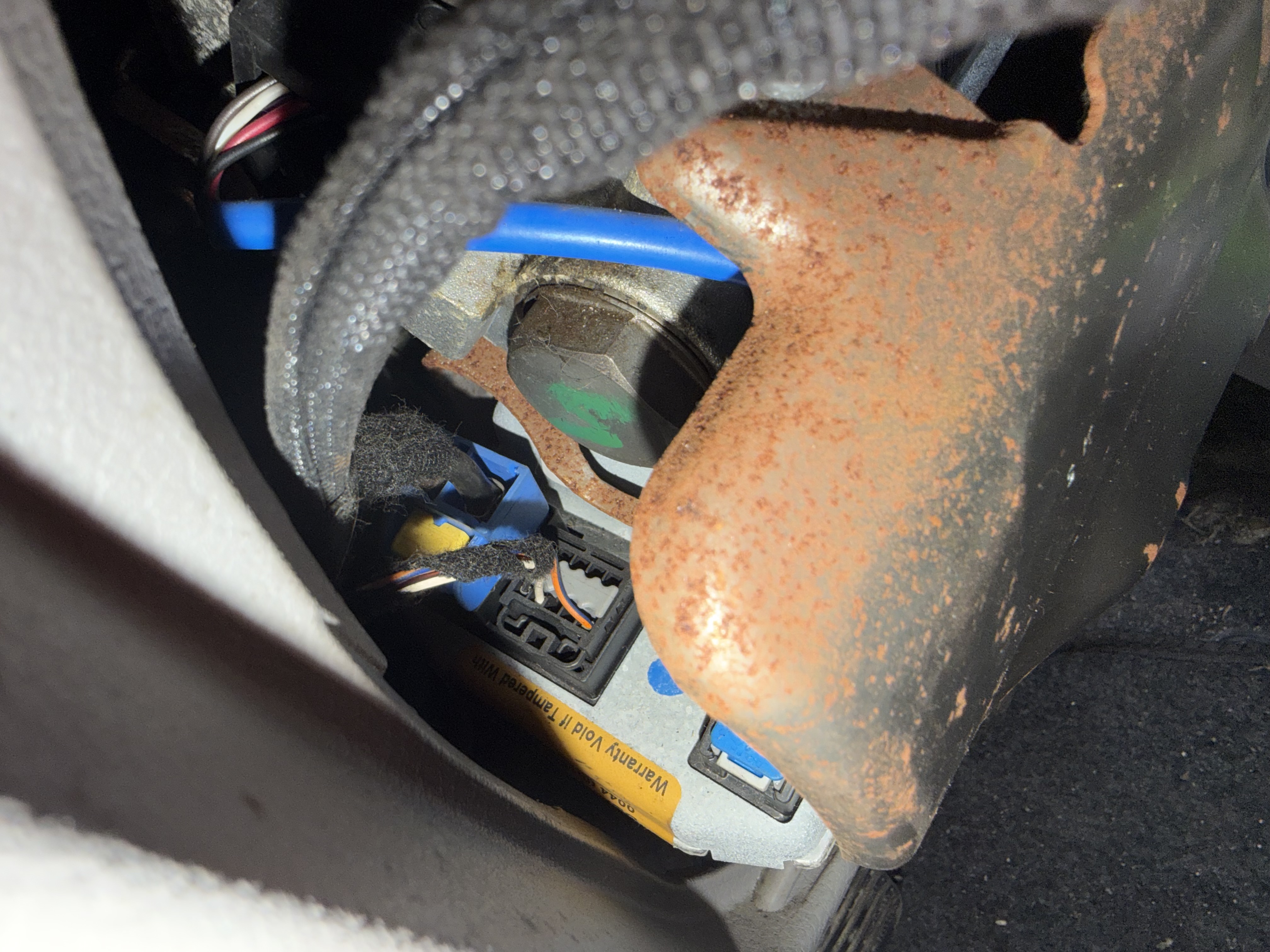

Whipped the cover off today to see which colour I needed to order. (Blue)
It is a bit rusty back here.
Photo 1
Blue sheathing
Follow the blue wire back
It should end in a squarish connector like this
Before you order a sensor unplug it and plug it back in
It fixes a percentage, if its oxidation on the pins
Only if that fails order a new sensor

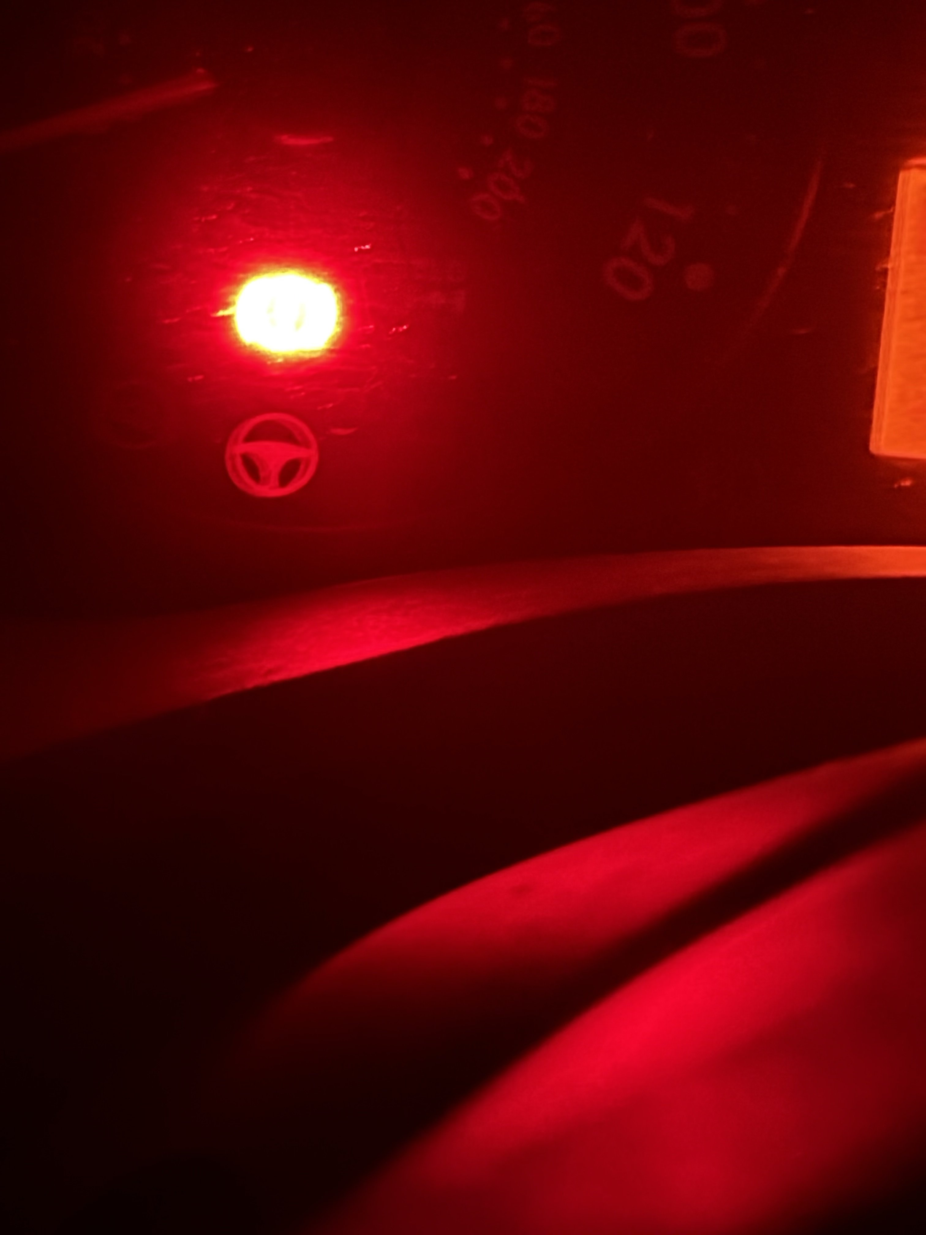

It will not fix the dash light though
Dim LED warning lights are nearly always damp got between the PCB layers
There's no easy fix
Send it away, dearest option
Replace second hand, has to be lower milage
Live with it
