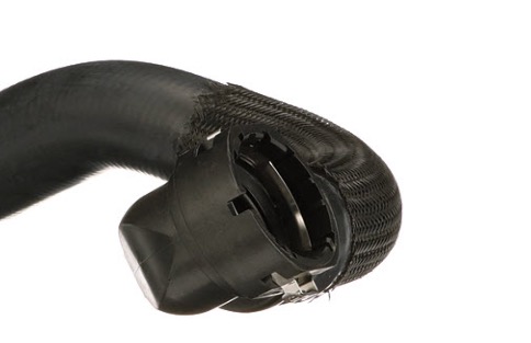

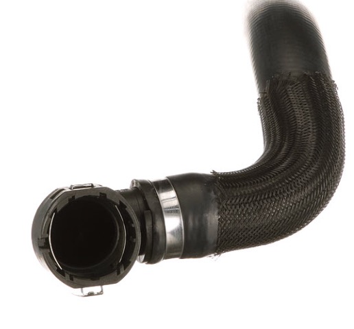

A photo of the type of clip / fitting may help.
I had problems with 2010 1.6 Doblo with the plastic elbow with a rubber inner seal and the wire clip arrangement.
In the end I made new O ring and lubed it up with silicon grease , then was able to firmly push elbow into place locking the clip arrangement securely.
I then pressure tested to be sure.
Fiat have used various types and it forces you to use their expensive hose arrangements.
I started making my own O rings from a Loctite kit after Fiat charged me £37 odd for two O rings, which came in a Fiat sealed bag marked PRC (Peoples Republic Of China)!!!:(
Good morning thanks for reply it’s driving me crazy now this is lol I’m thinking of getting another hose to go straight to rad and use a jubilee clip lol
Good morning thanks for reply it’s driving me crazy now this is lol I’m thinking of getting another hose to go straight to rad and use a jubilee clip lol View attachment 453861
Providing the plastic groove in the radiator is not damaged, try and see if the clip secures the elbow with the rubber sealing ring out temporary so you know it has pushed all the way on.
You can usually see by the way the wire parts of the clip sit in their grooves if that is the problem.
Afterwards try refitting the elbow with it's O ring and well lubricated ideally with silicon grease, if it will push on all the way and you can see the clip lock in, if so and you can't wriggle it off then refit the hose and jubilee clip and test as before. I agree they are a stupid idea, probably done to keep cost down and quick assembly in the factory when brand new!

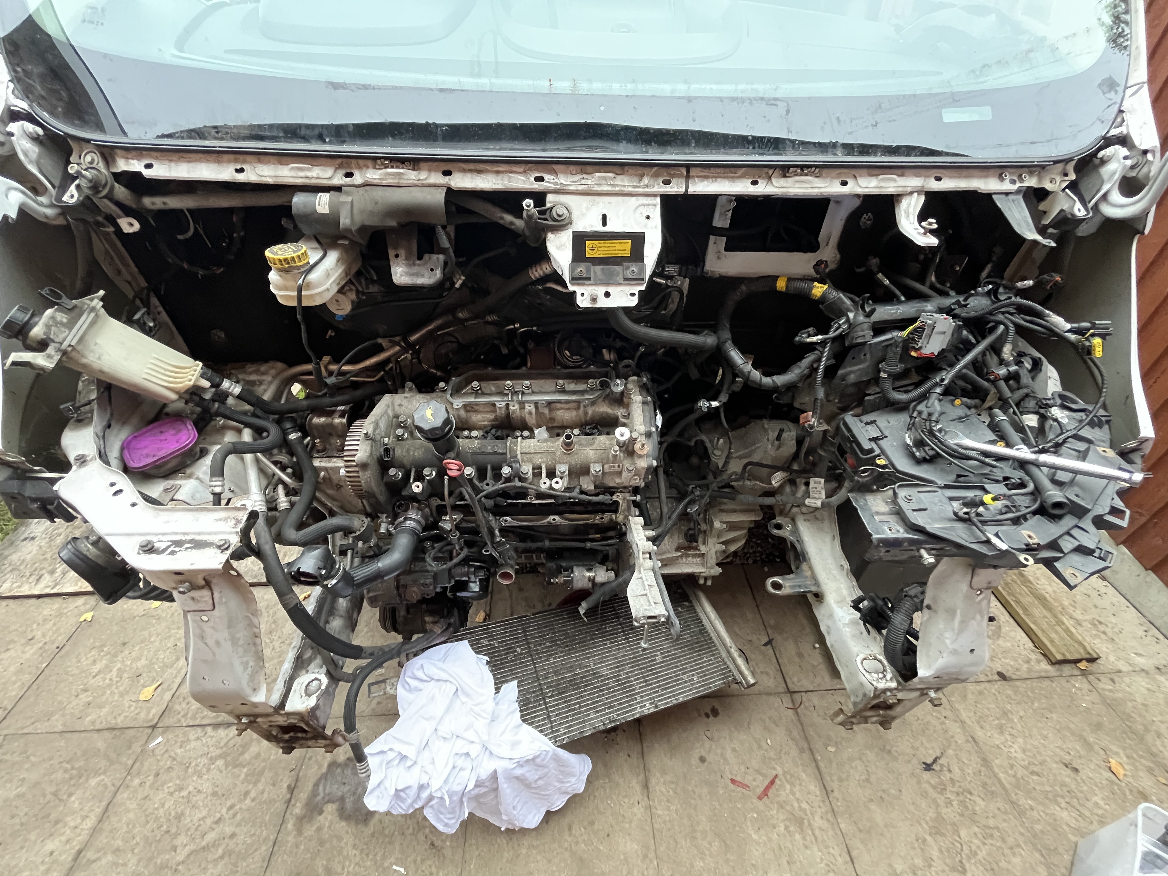

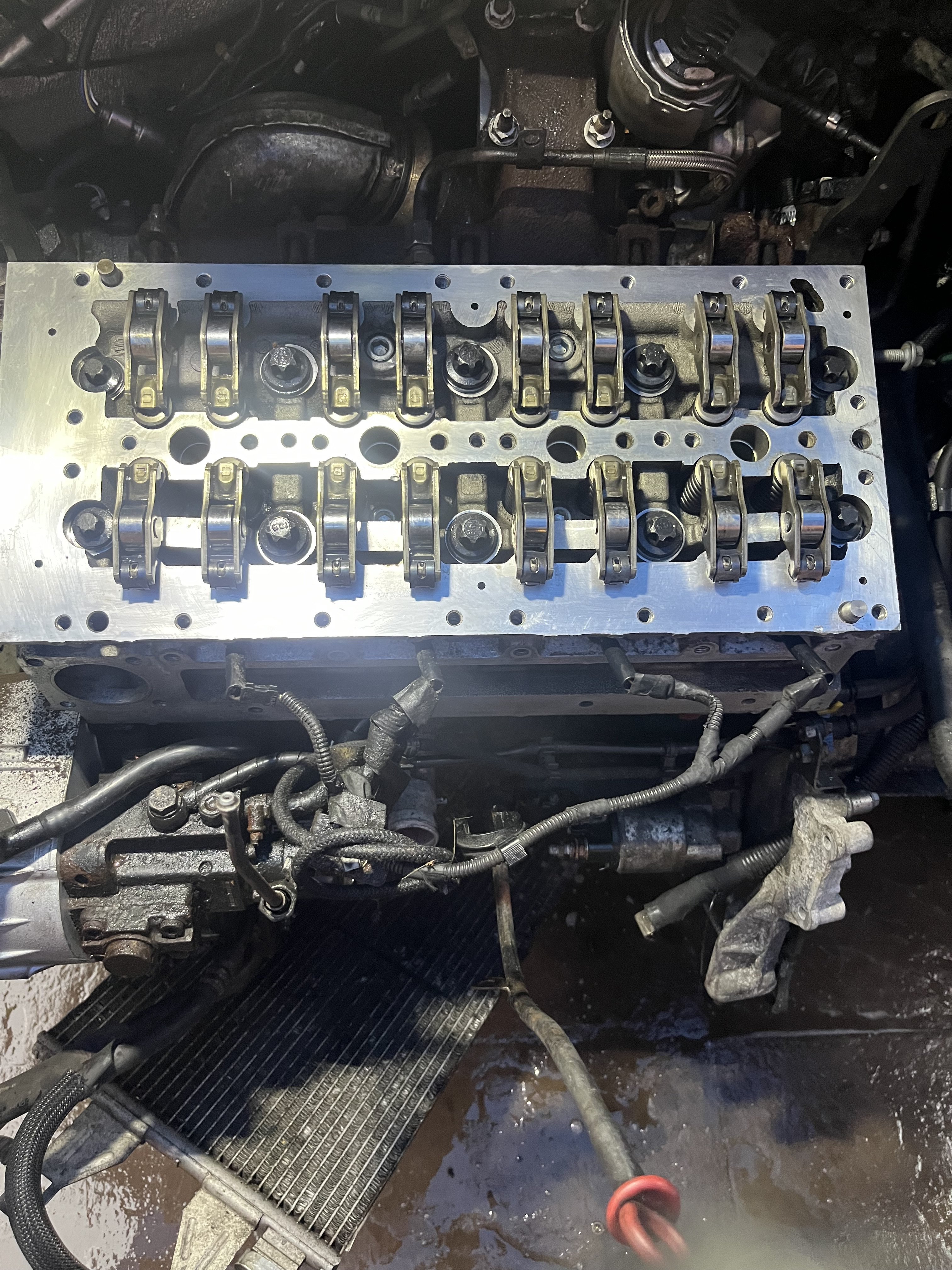

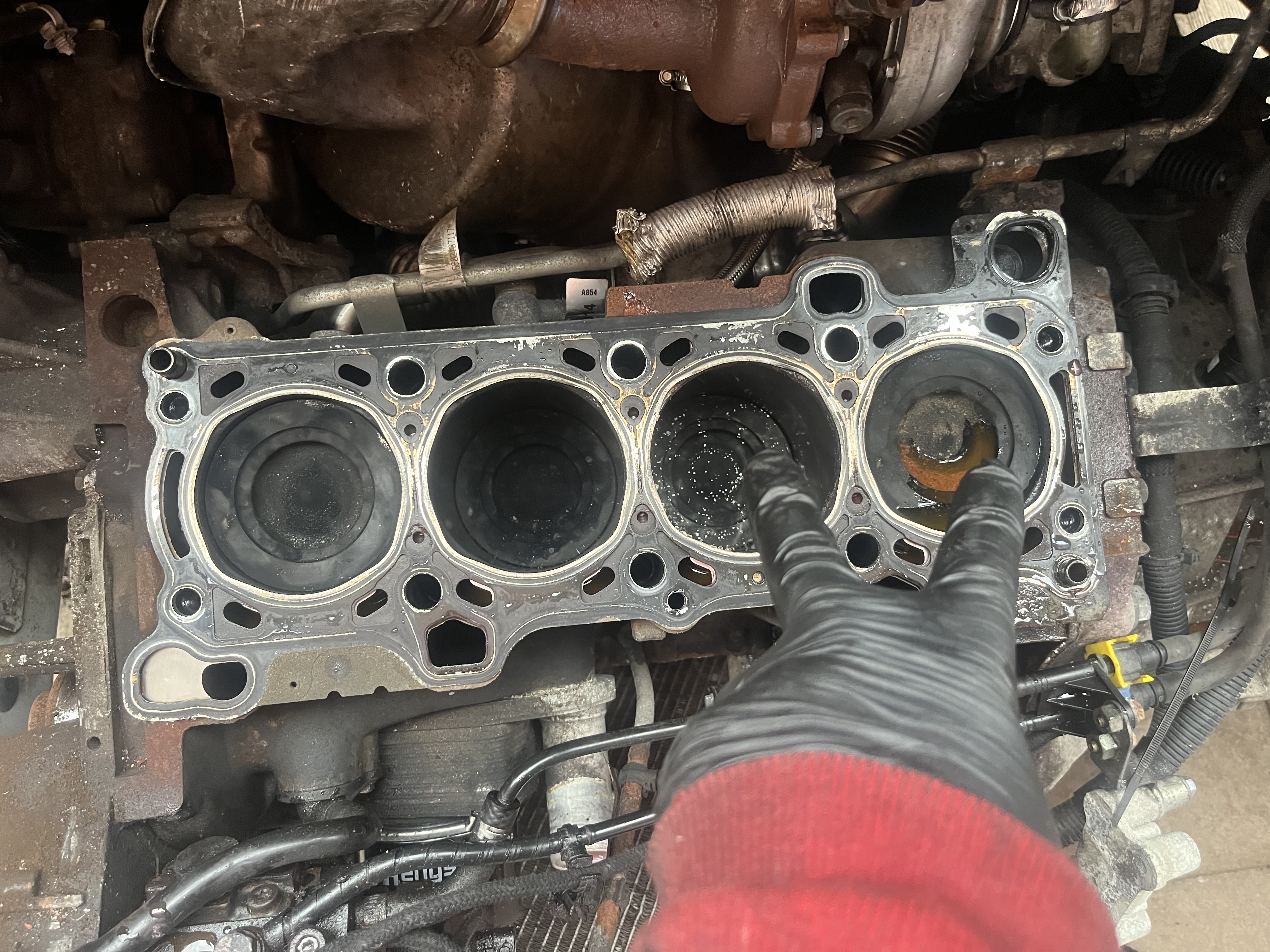

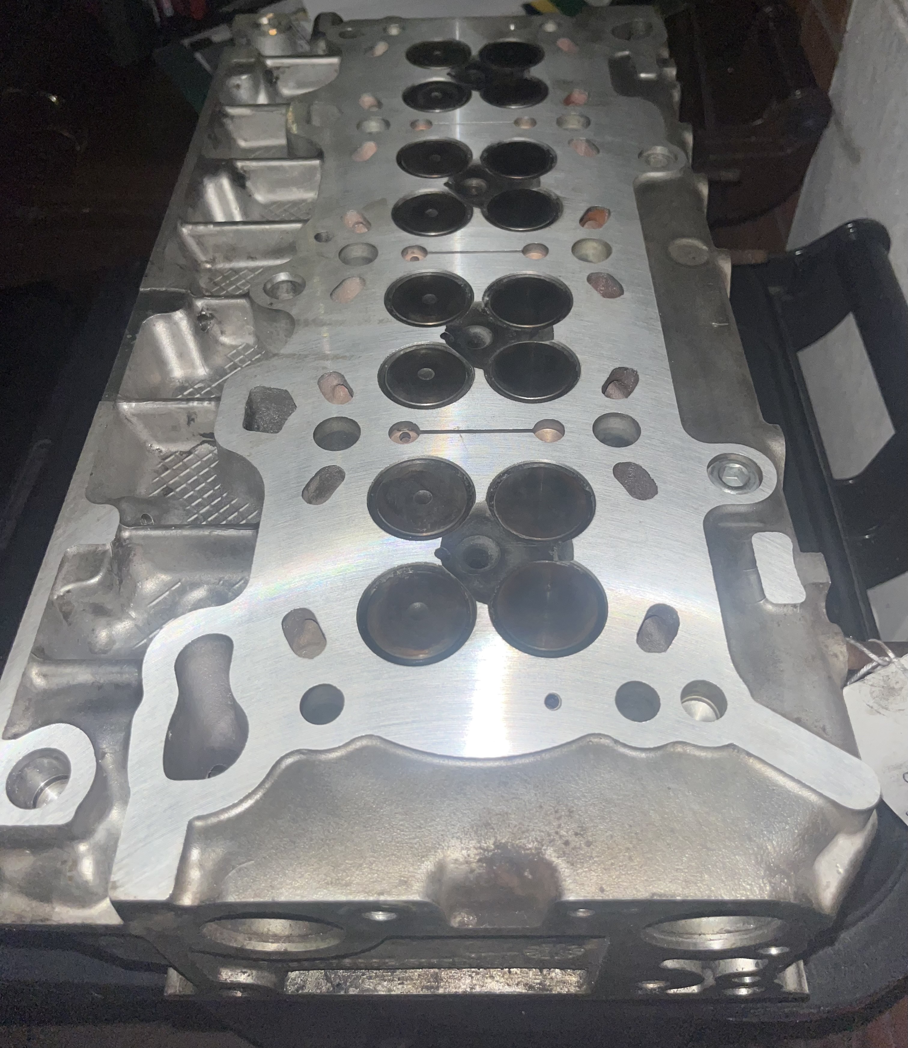

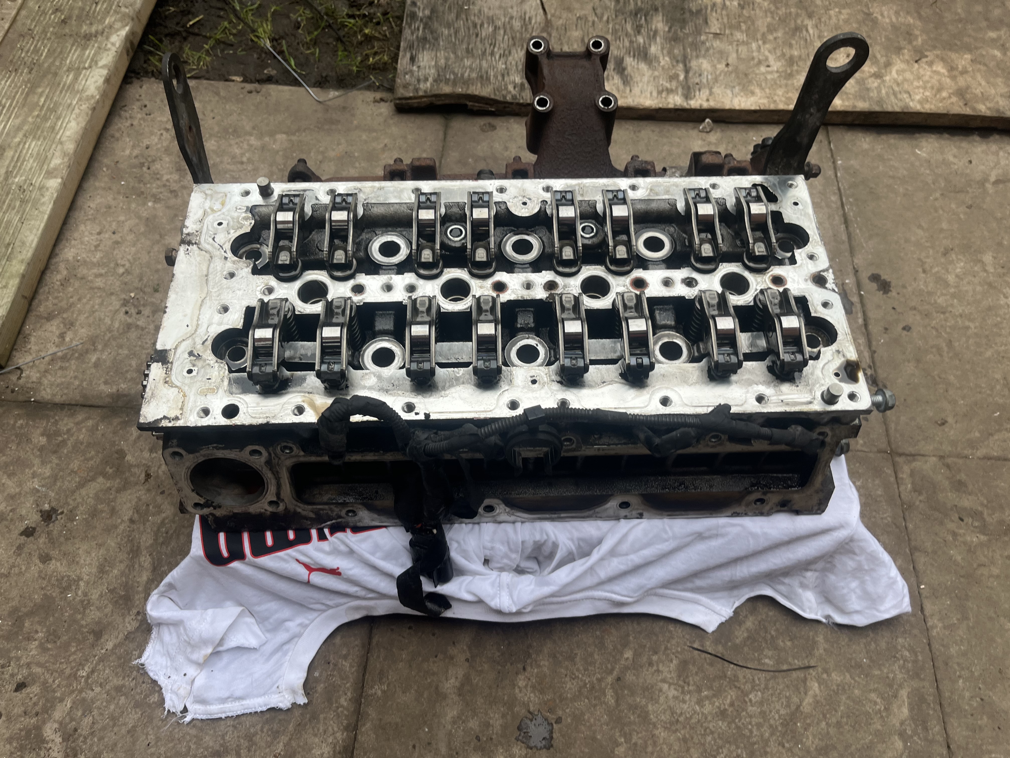

Sorry for late reply been flat out with work but the truck is all back up and running with no issues ,, had to get head skimmed a little and also got it pressure tested, I’ll add some pics you can see where the water was leaking into cylinder
Good job:)
It is nice to have a definite fault when you remove the head, some times it is such a slow leak that only something like the leak test I mentioned will accurately show which cylinder the fault is.
Good job:)
I had a feeling it wasn’t going to be nice tho as is was the back pressure that was popping the hose of rad which is so weird same hose back on and stayed on lol
