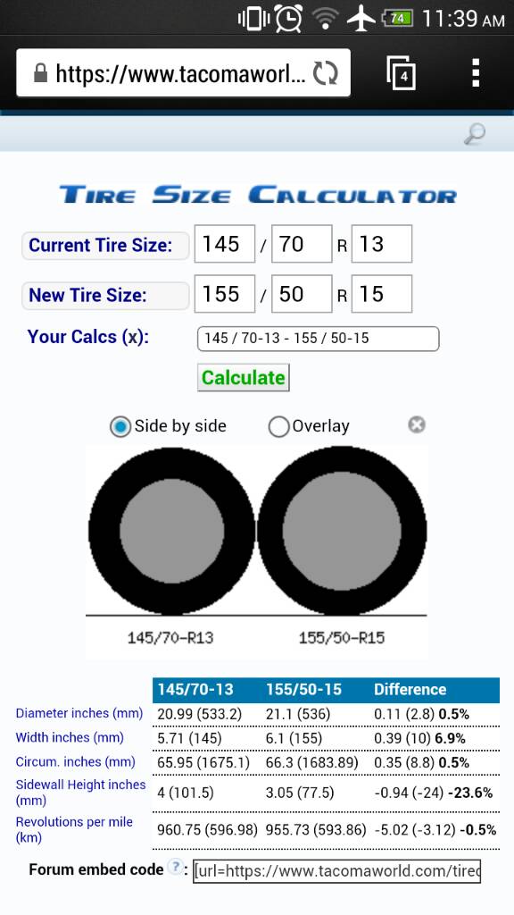

Tommy, do you have any idea if I would have problems with a wheel upsize from 13" to 15" or alteast 14" .My current tire size is 145 70r13
i've not tried it but i would imagine you could easily get 14's on it with out any problems.
15's might be a squeeze but some low profile trye should be okay.
try this website its pretty could. http://www.willtheyfit.com/
I have 14" on mine, initially I had 185/60 14 tyres, but they rubbed, especially at the front, so I`m on 175/65 14 now (& the speedo is very accurate, I think it would be 100% accurate with 175/60 14`s.).

Any idea about the Speedo correction.I don't want to use too low profile tyres cause the roads in India suck.
It should say on the website, or you can work it out by divide the current circumference of the tyre by the new circumference of the tyre and that ratio will be the speedo error. Are there many unos about in India?
