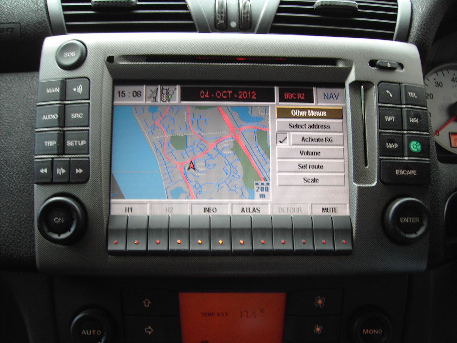

I've only seen a Connect Nav+ and what I believe is a Connect Nav. The CN+ has a large full colour screen that shows mapping and has full voice control. The CN has a small black and orange screen that only shows direction arrows. I don't know if it has voice control.
My car had a CN+ fitted from new and I've used it regularly for driving to Greece and Romania. I bought all 19 map discs for Europe. Voice control is good if you can learn all the words you need to control it with. I only use it for dialling phone numbers, everything else I use the buttons.
Main problem with it is that the hardware was designed 14 years ago, so is outdated and quite slow to plan a route. Also, the latest map discs available from Fiat or Navteq are 2010/2011, and it appears that they are not publishing any new updated discs. Not a problem in the UK because we don't have any money to build new roads, but I've finally succumbed to using a TomTom when driving abroad.
If you get one, look closely at the buttons. They have a thin rubber coating that can wear off, as seen in the CN picture below.

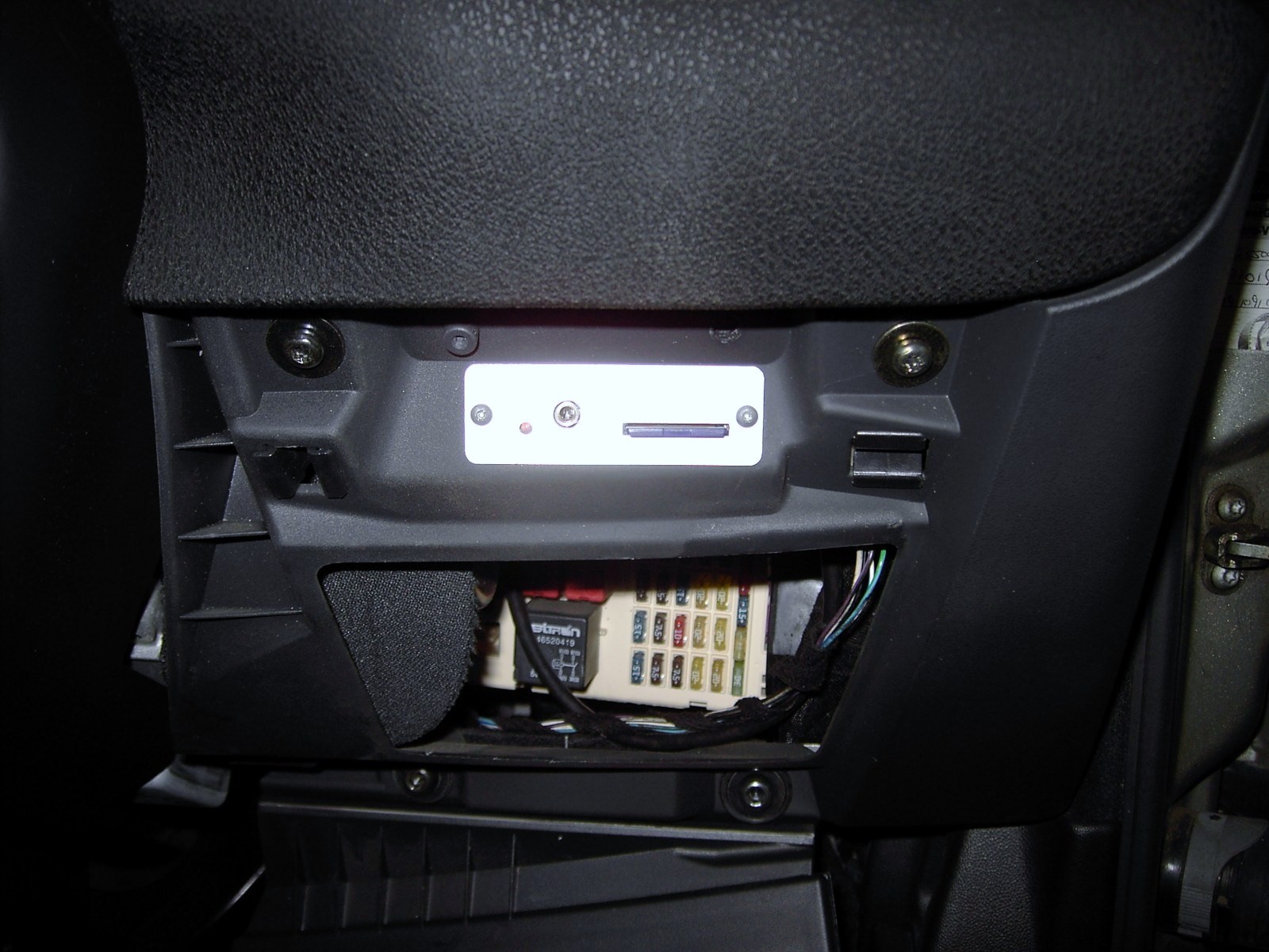

I have a LoudLink CD emulator fitted to mine. Just about enough space above the dashboard fuse box for it.
