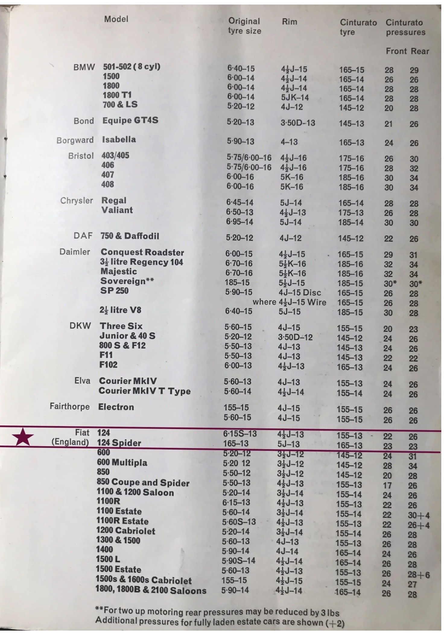

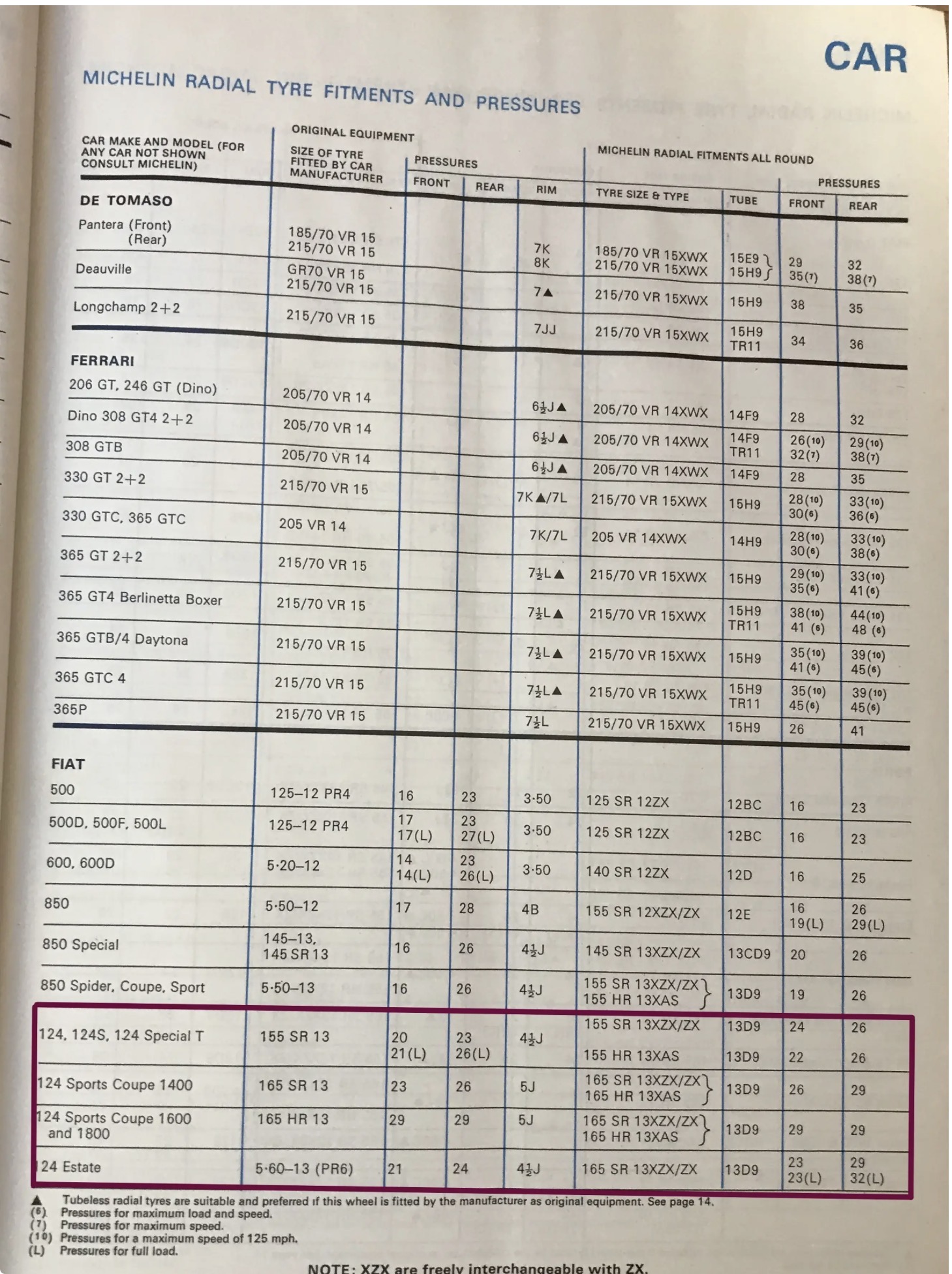

I’m just getting to know my new toy… out playing in the garage, fiddling with minor tweaks… so I thought I’d check the tire pressure… and I have no point of reference…
I found these references from Longstone tyre and Pirelli.
23 psi front/23 psi rear
Is this about where everyone is running their 165 r13 tires?

For a Fiat 124 AS Spider running 165 - 13" radial ply tires the Fiat factory manuals specified 22.75 lb/sq.in (this was Fiat's conversion from 1.6 kg/sq.cm), front and rear. I noticed your car is fitted with Michelin XAS 165HR13, (i.e. equivalent to original fitment) so 23 psi all round should be fine.
As regards the figures of 23F/26R shown in the Michelin list above for the 124 Coupe, the Fiat 124 AC Coupe is longer and heavier at the rear than the 124 Spider, resulting in the tire pressures being 23 psi front and 26 psi rear.

23 psi… just didn’t sound like enough… I keep forgetting how light these cars are…
