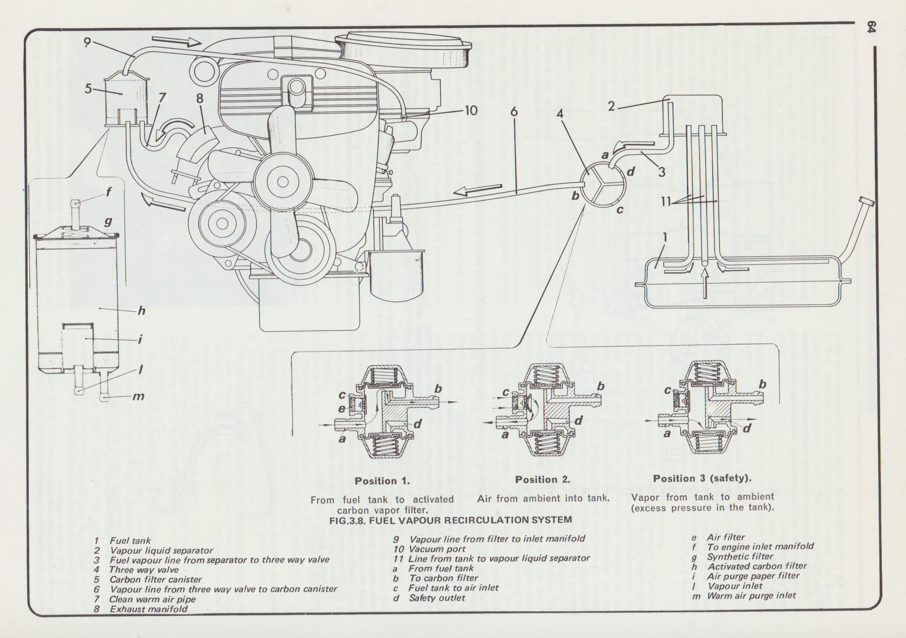

I came across this schematic of the Fuel Vapour Recirculation System used on some Fiats - it seems the 3-Way Valve includes a safety function to vent excess vapor pressure in the tank to ambient in the event that there is a blockage in the vent pipe to the canister. It also shows what is inside the charcoal canister including 3 types of filter, this suggests it has to be replaced, rather than be serviced.
Of course this info may be very different to what remains of the 'smog' gear on your particular car but it might give you some idea of where to check to sort out the issue with the fuel tank building up pressure.
124bc1, thank you! , I will look for the 3 way valve back by the tank, I wouldn't be surprised if it's not there though, I'm pretty sure it's not in the engine compartment.
It's easy to see the lines where they come out of the tank, but trying to see where they go, especially from the engine compartment end gets tricky.....
I'm going to start with the line that's still in place between the tank and canister by first looking if there's a one way valve, then trying to check for a blockage, next might be tearing in to the canister to see what makes it "tick" ....if I can't get it figured out I might need to see if I can make some kind of simple vent myself like "macGyver" might do, I drove the car several hundred miles before I parked it for those years and it didn't seem to have the problem then, perhaps it's another one of those things damaged by sitting... :)
