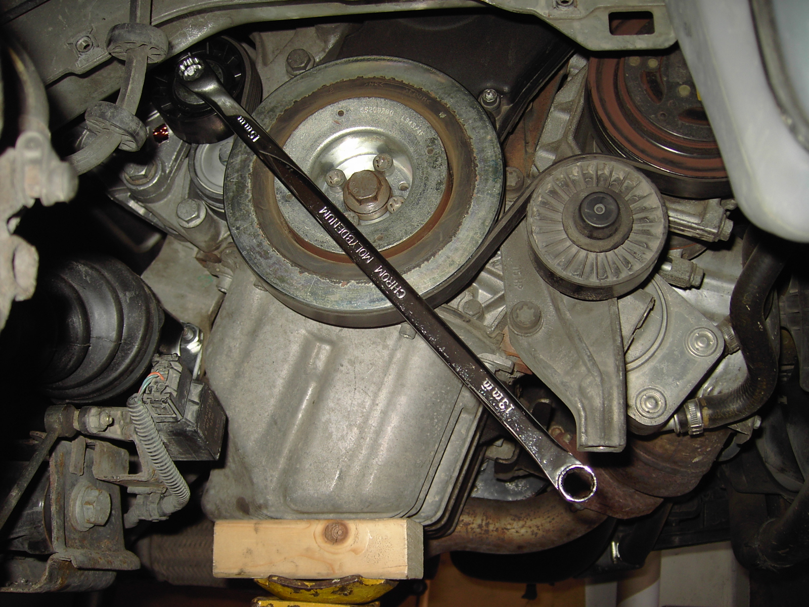

Anti-clockwise is the only way I know of loosening tension of the automatic tensioner.
You will need a long 15mm spanner to release and hold the tension. While holding the spanner anti clockwise, remove the auxiliary belt from as many pulleys as possible then release the spanner slowly.
Hi Davren, as always you delivered, thank you for the reply and for the attachment.
I guess that's the way i'll do it, the only thing i was afraid is that if i put enough force on the spanner i'll end up undoing the bolt that holds the bearing in place, instead of moving the hole tensioner assembly XD but i'm guessing it's holding pretty tight and wont give in to the force applied, only the spring. Fingers crossed.

The bolt could easily by a reverse thread to prevent this
Or done up so tight that the spring gives way before the bolt starts to loosen
Yes..I suspect it is a LeftHandThread..
(Chances are the roller actually runs CCW driven by the belt..)

I had to remove the Crank pulley to swap the broken tensioner for a new one.. there is no space
Just prepare with a Hex.15mm ( NOT bi.hex)
And wear strong gloves ;)

The key to fitting the aux' belt is to get as long a spanner as you can. That gives you a lot of leverage and (assuming you raised the car enough for the spanner to not touch the ground as you turn it) makes this job very simple.
I bought a flat Aviation spanner, made by Bergen. You can rotate the tensioner round until it touches the end-stop with one of these:
https://www.ebay.co.uk/itm/183230041432?hash=item2aa95c8d58:g:vOUAAOSwsE5ZlWbT
It's flat, which helps. There's no room in there for a swan neck or any other profile of spanner, or a socket.
The Bergen jobbie is a fair bit of cash for a single spanner, and I only use mine for the belt tensioner, since it's too long to use for anything else.... but it's one of those "best things I ever bought". You'll wonder why you didn't buy one sooner.
Don't faff about with the tensioner itself. You can remove the pulley to remove the belt.. but that's no better than just cutting the belt off.. since you'll never be able to refit the pulley with a new belt on there.
