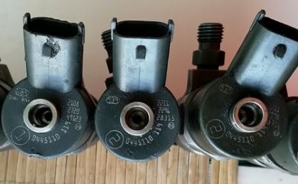

I take that back...there is a slight difference. Original I grade 2, new one is 2C...is that going to make a difference do you think?
I've never seen a JTD injector (Bosch part number 0445110119) with a number and letter in the circle, just a number 1, 2 or 3.
A few examples in the pic below.
