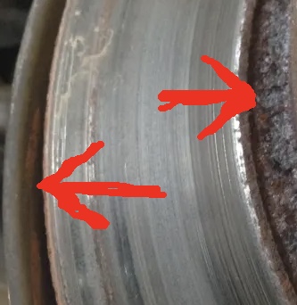

I suspect a good visual examination will reveal something
These lips start catching after awhile
