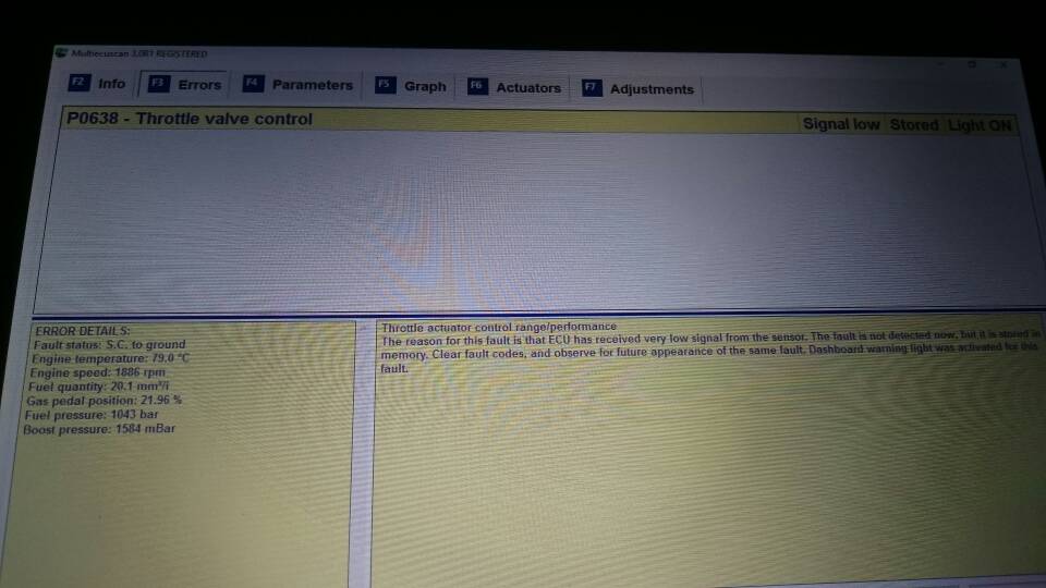

Hi, my 2009 x250 2.3 throws an engine light every so often. Forgot to write the code down but is described as low reading on throttle control valve (short to ground in the explanation)
Happens every few hundred miles and self extinguishes the light after 5 clear runs.

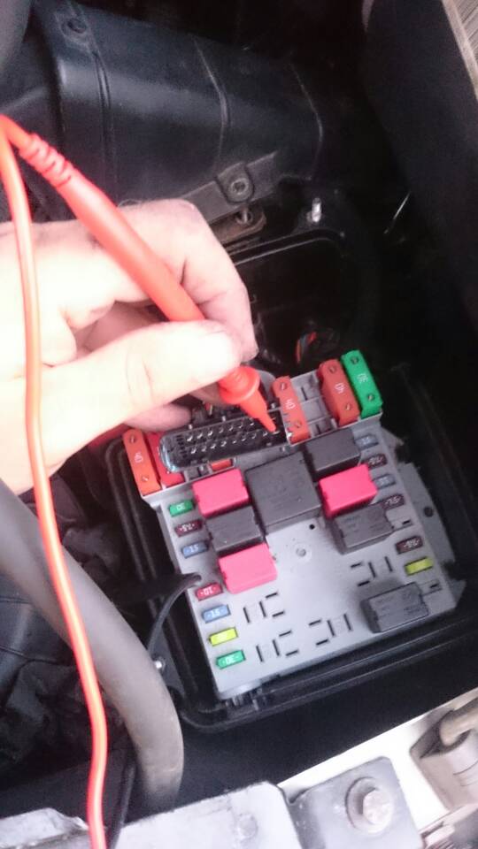

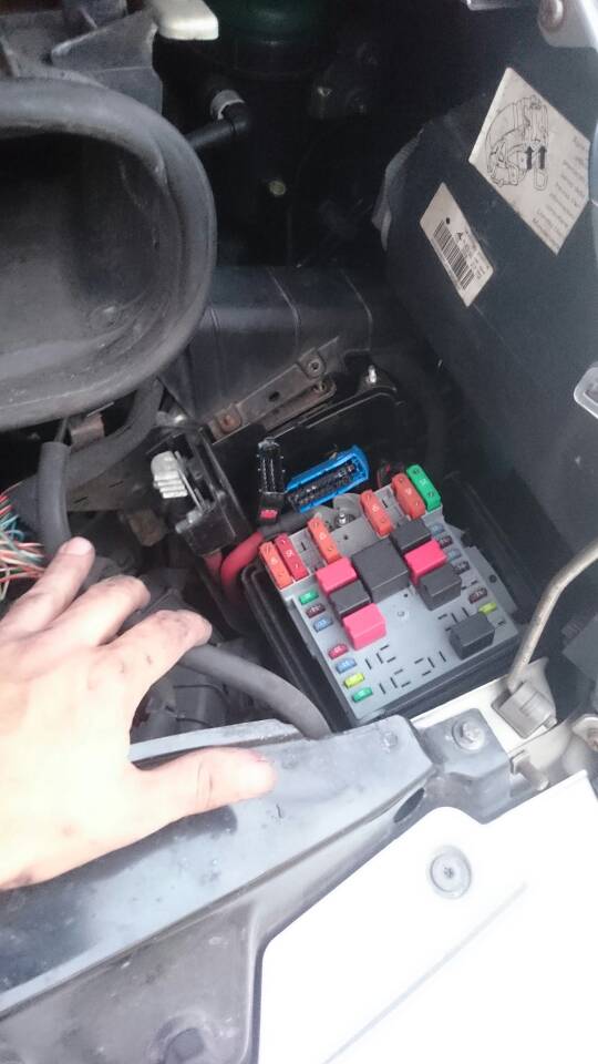

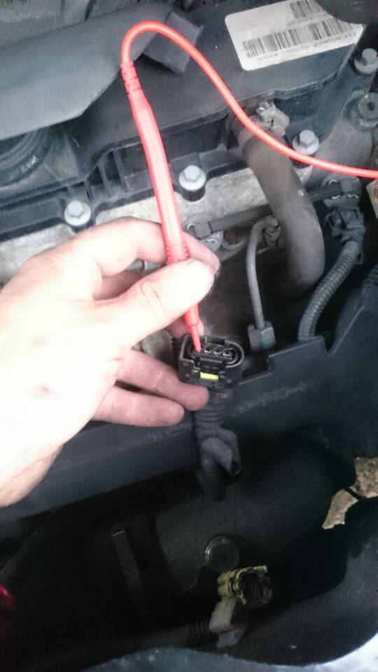

So had a good look at this tonight and have found a failure point and fixed it I hope :). Error code is P0638. It was getting a little worse with engine hesitation under load. There is a multi pin connection buried in the fuse box next to the air filter. The wires from the throttle valve buzz to there. The connection is likely to have sat in water over the years as is at bottom of plastic tray. Open up, find corrosion, scrubbed up and hopefully fixed. See pics. Likely a cause for other issues!!!
Had to follow the engine loom and it divides, one spur to a connection on the Ecu, the other spur loops round into the Base of that box and the connectors you see pulled up.
Andy diver, quick question, how did you separate the blue/black connector block, struggling a bit and don't wish to break it! :bang:
There was a blue part which wraps round the join line. It has a wedge action if you slide it to the side the connectors are prised open, opposite to close.
Thanks Andy diver, that worked a treat, the pins and sockets were all ok, cleaned them any way
Cheers
No worries. Do you have an issue with the van or are you being pro-active? The loops of cables under the light in that area have been reported to have chaffing issues also.
Oh and the big connections to the Ecu next to that fuse box might also be worth opening for a look. The plastic lid / lever on the top of the connection lifts to prise them open once you have removed the splash cover

Yep, that's how mine was. Check the connection at the throttle body there is a short loom dropping from the long plastic wiring box at the front of the engine. I could just pull it out my hands are average size, you have to squeeze one side to release it.

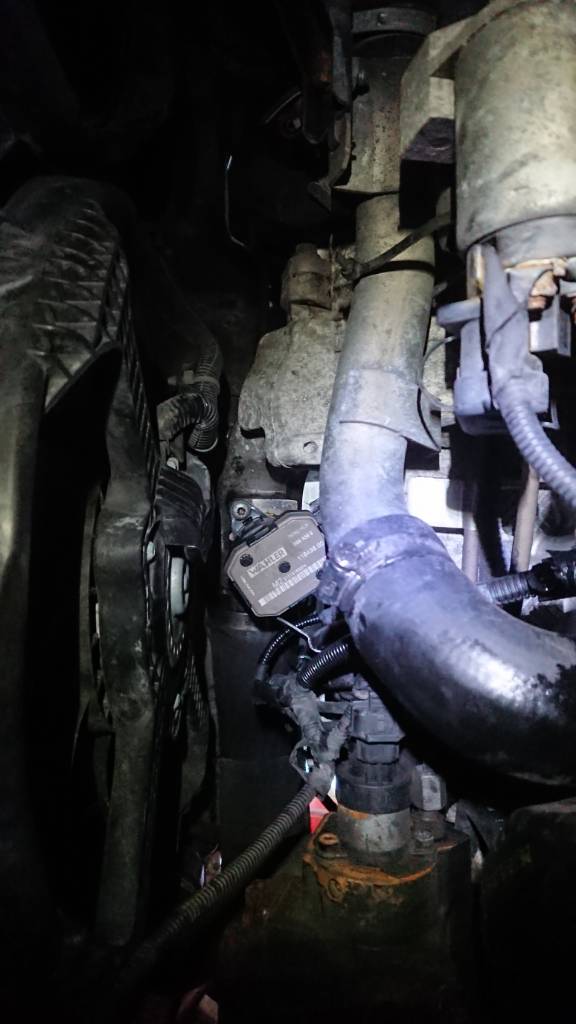

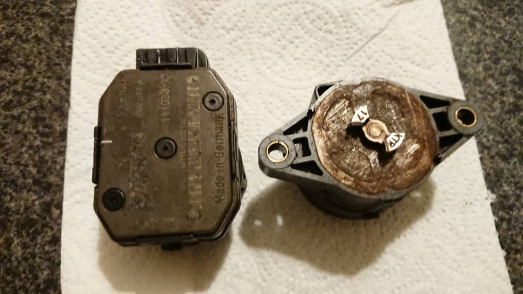

Update.... fiddling with the connection to the solenoid unit on the throttle body stopped the error for periods, then it comes back. Decided to fix once and for all. Not prepared to spend money, or take the front off to replace the whole unit, figured that the solenoid unit can be dropped off from underneath. Found the unit had too much water damage to feel comfortable to clean and put back. Found an old style replacement on ebay with the same throttle solenoid and have swapped it onto mine. I made up my own spade connections to it and potted them to avoid the now useless old connection. DSC_0237.jpegDSC_0238.jpegDSC_0233.jpeg

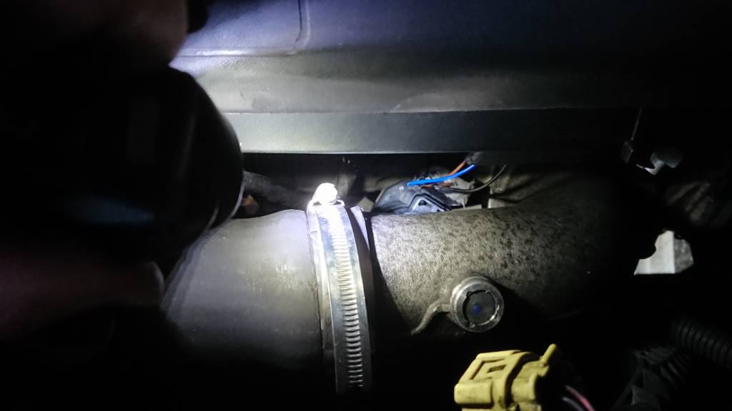

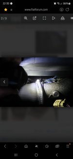

Hi, I know this is an old thread, but I have that yellow connector that is in one of your photos, and it is not connected to anything, do you know where it connects too please?
Thanks on advance.
