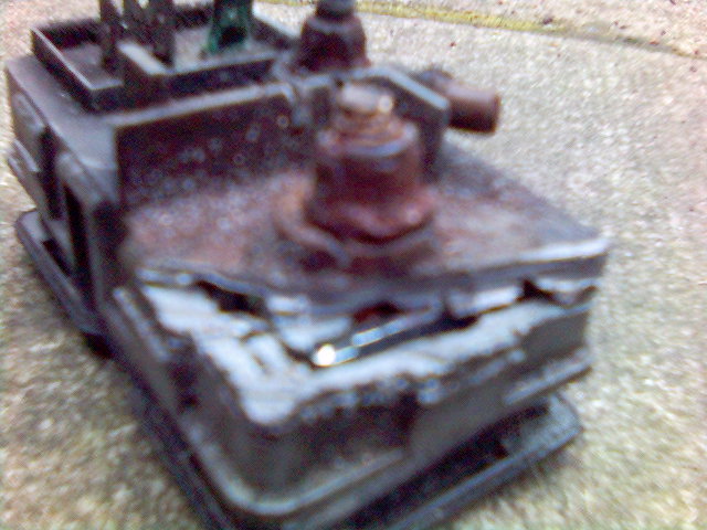

The problem with old cars is that - not just the engine wears out. This was typical. The gloplug ECU live wire connector and terminal was badly rusted and snapped when disturbed. No repair proved possible, had to get a new unit, and rebuild the multiplug. New terminals are caked in vaseline. :D

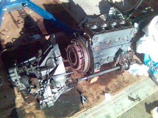

Alot of time was cleaning, this gearbox was filthy when it came out. (n)
Constructed an engine trolley to wheel out the engine from under the car. Completely useless.

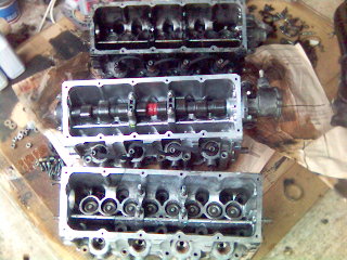

The big one...when learning how to use a spanner last year I must have mixed up camshaft caps. Tightening them down to the correct torque this time resulted in a stiff cam. The timing went to pieces as I cranked the car. :bang: I don't want talk about the bill, even making 1 x good head out of 3 :eek: plus a wasted head gasket.

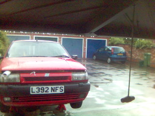

Raining again :cry:

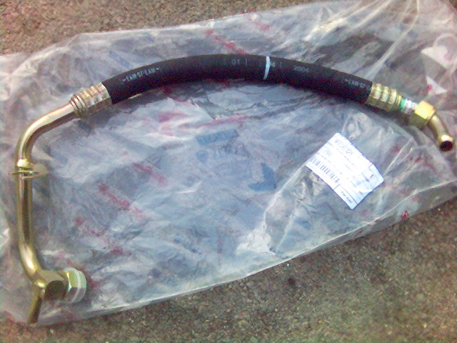

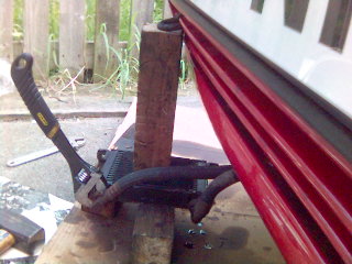

Worst teething trouble, a leaking 2/nd hand oil cooler (my last engine was missing a cooler) It took the weight of the car to get the hoses off it, which took the cooler thread with them.
Despite my efforts to clean them up, they b:rolleyes:ggered the thread on my new cooler. This had to be repaired :eek: and what I tried to avoid all along...2 new gold plated pipes from Fiat. :worship:

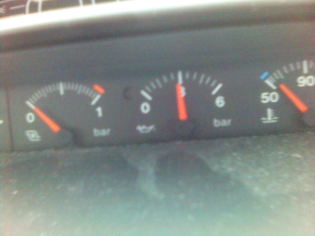

Oil pressure! So this gauge wasn't broken, just my old engine was knackered.....:D
