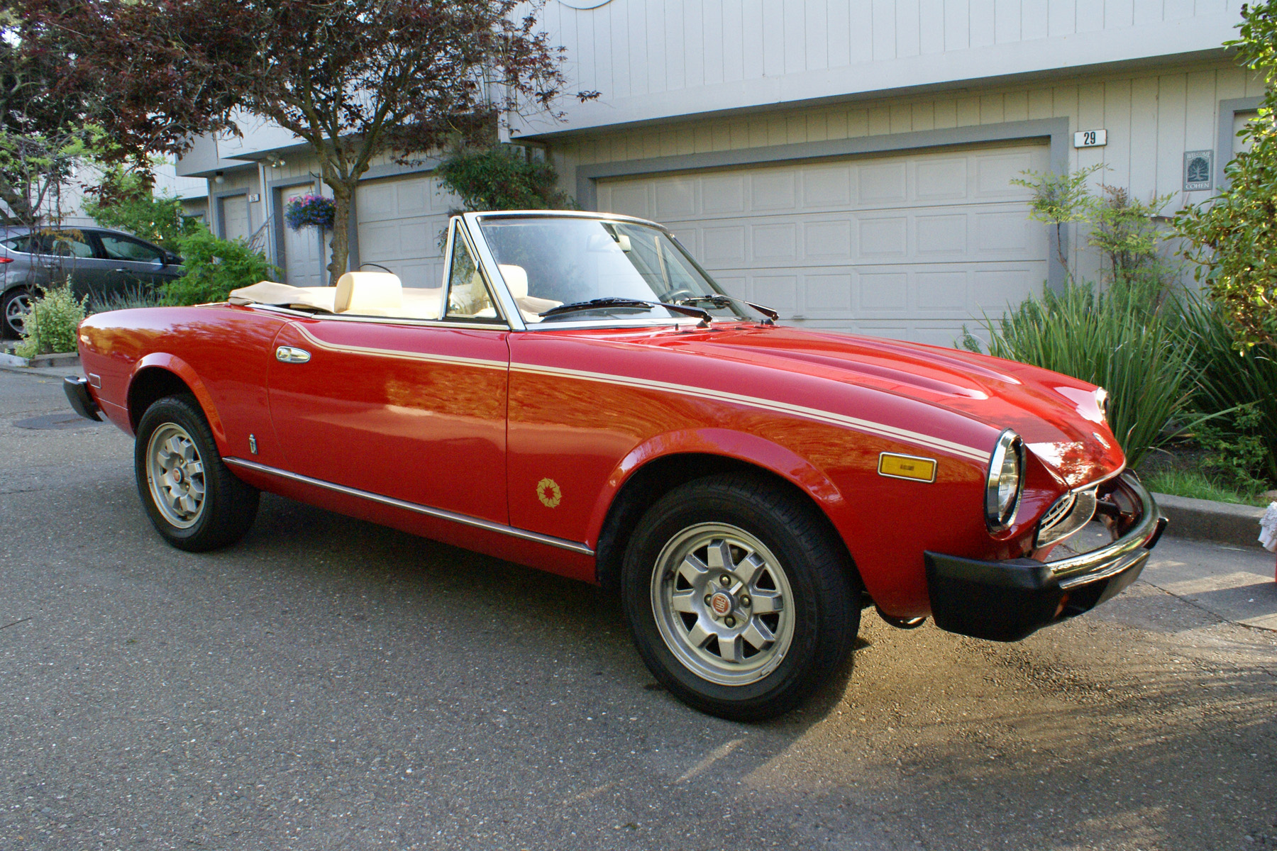

Thanks for the welcome. Just trying to figure out how to navigate the site. I have a '81 2000 Pininfarina Spider.....was originally a Turbo but the turbo was removed when the engine was completely rebuilt a few years ago. That is fine as far as I am concerned.....seems they were always the source of issues.
