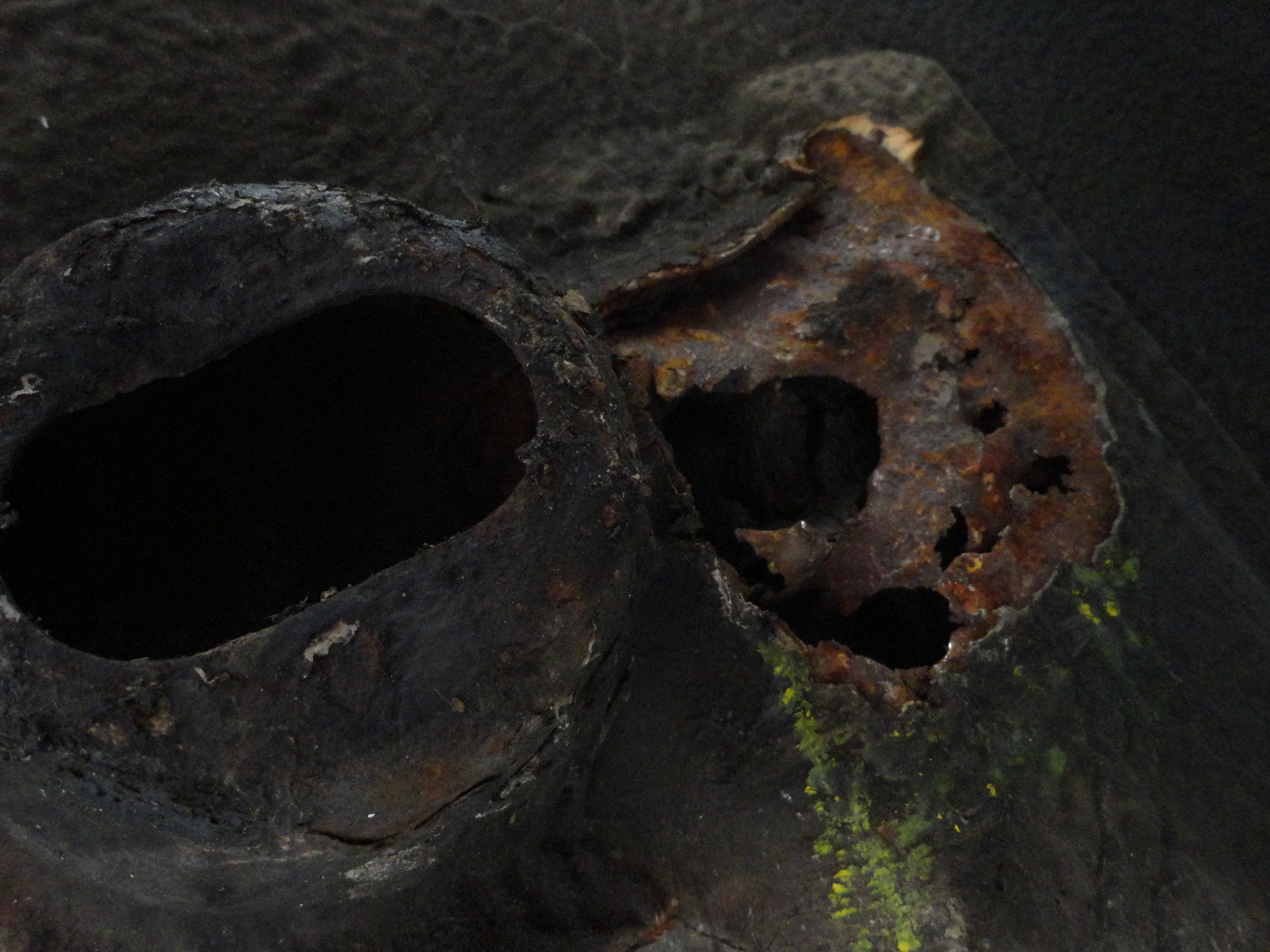

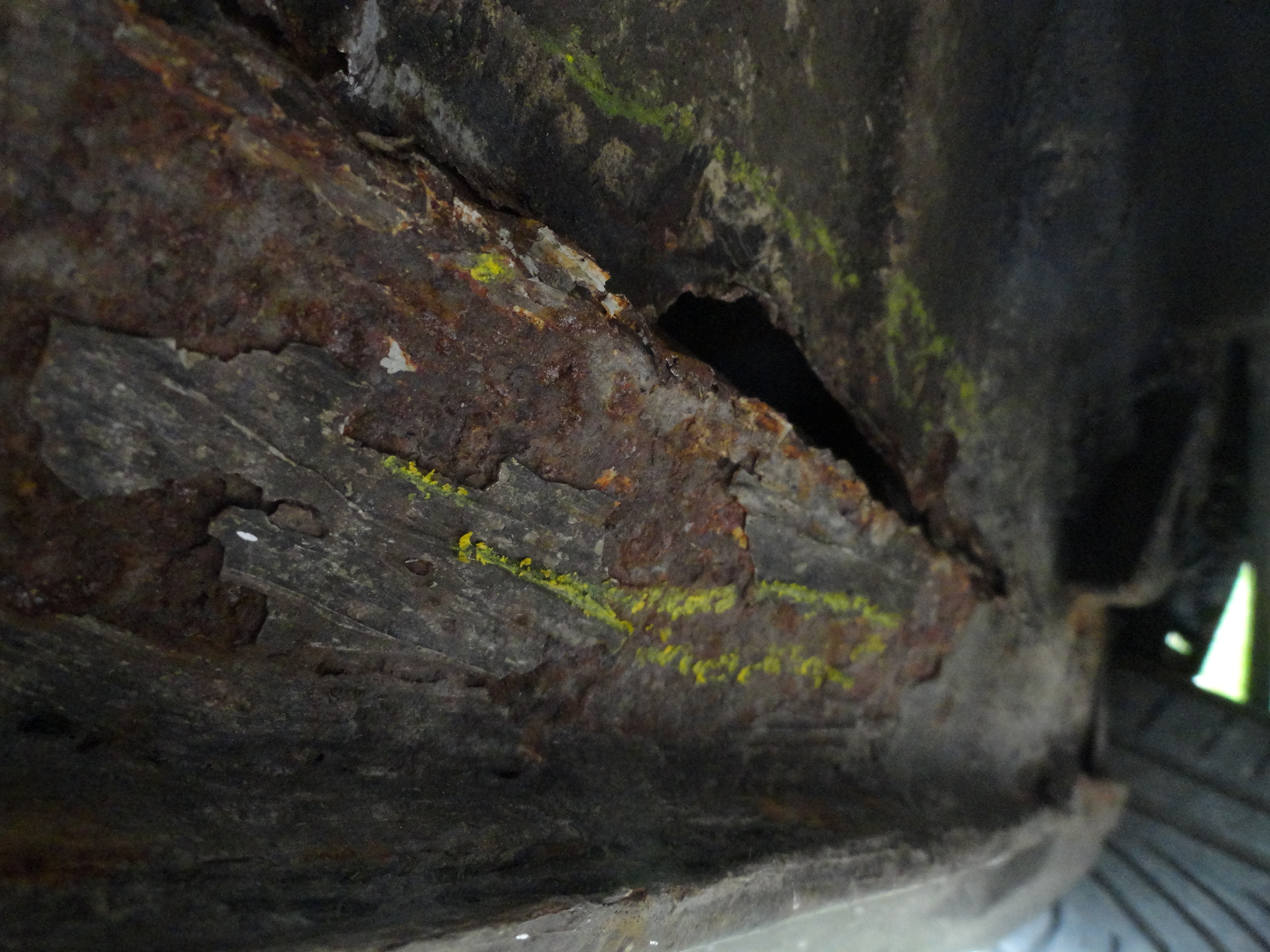

On Monday I took a peak under the car to see what the floor was like as last year the MOT tester may have been lenient and passed when he could have failed it .
I poked a screwdriver through the floor near the sill on the drivers side ,so I knew it was going to be a fail this time .
I took it in today ,way earlier to get the extra 4 weeks on an MOT and same tester managed to poke 6 holes ......3 on the drivers side , 1 on the passenger side and 1 each in the rear arches .
I rang and eventually spoke to a local company who did the last welding for the 2017 MOT and they seemed to be chaotic with work and also said their welder was broken ,sounded like a feeble excuse to me not to want my business.
I ended up taking the Ferrous Oxide FIAT to a mates and ex colleagues bodyshop and left it there for him to quote me .

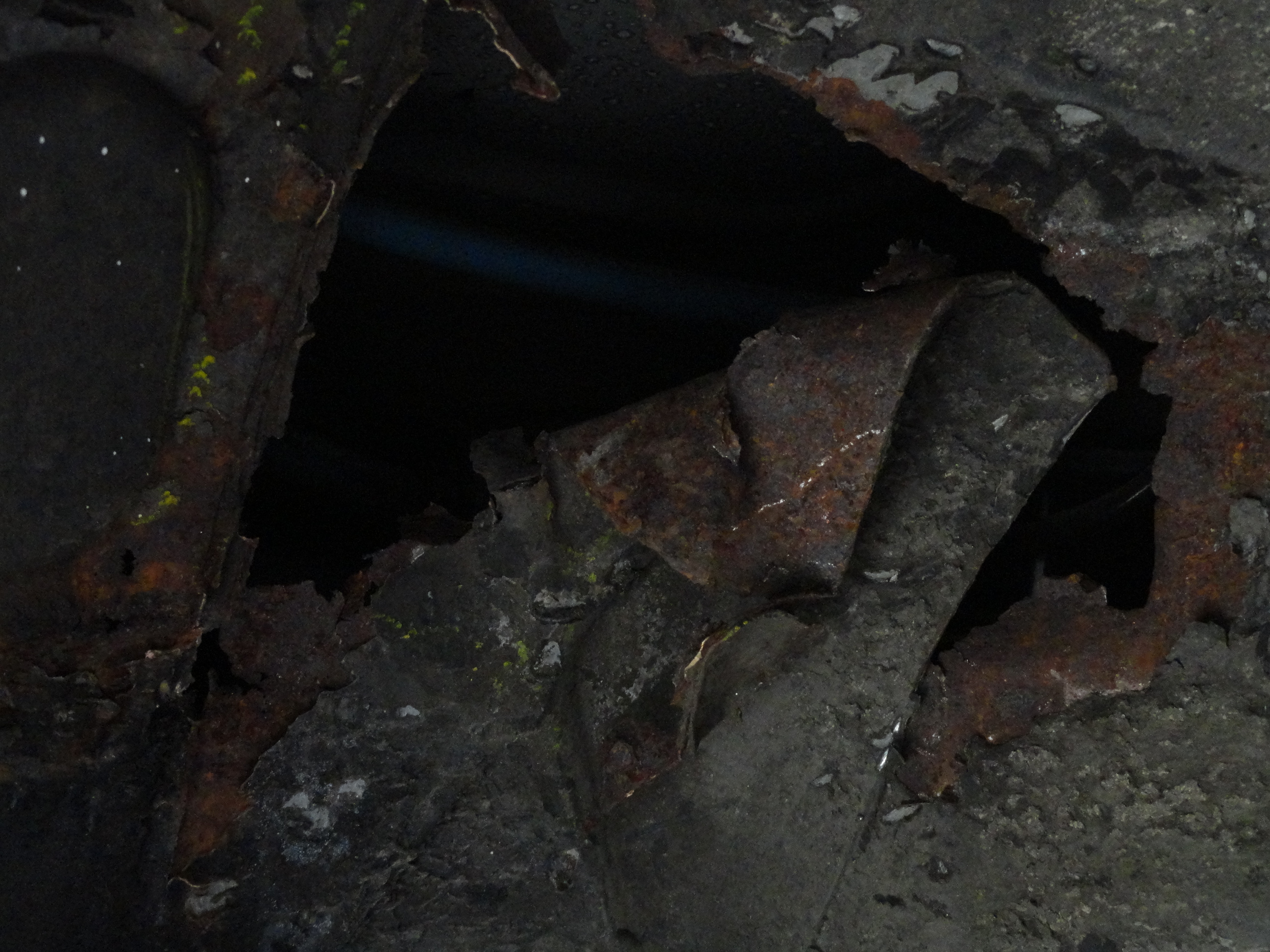

Couple of hours later get a text with awful pics of holes WAY bigger than expected .
After removing the rear wheels and a piece of plastic liner ,he basically pulled lumps of metal off the car that the underseal was holding in place .
As many of you know ,an MOT tester is not allowed to remove any bodywork pieces to check behind them .
My mate threw out some figures at mates rates ,still way too much and frankly the underneath of the car will be plates welded to plates and not enough of it originated from Italy in 1997 .

Now the pics no one wants to see .
It's a sorry mess .

Despite the "B" having quite thick steel and the extra reinforcing to compensate for the lack of the Punto's "A" to "B" to "C" posts and roof linking, meaning it should fare better than Punto of the same era, the dreaded tin worm is just to too all consuming once it gets hold.
All/most of those pictures look like floor pan and inner sill corrosion and probably due to years of damp and water under that horrible one piece moulded floor covering/mat, coupled with the way water can so easily get in and under it and never be seen.
I've only ever had to strip out the rear section of our "B"s flooring but if I had to strip the whole lot out (eg for a heater matrix replacement) then I think might consider getting some other black carpet covering specially made. Something that was easy to diagnose dampness, easy to lift in sections, did not retain water like a sponge, etc.
