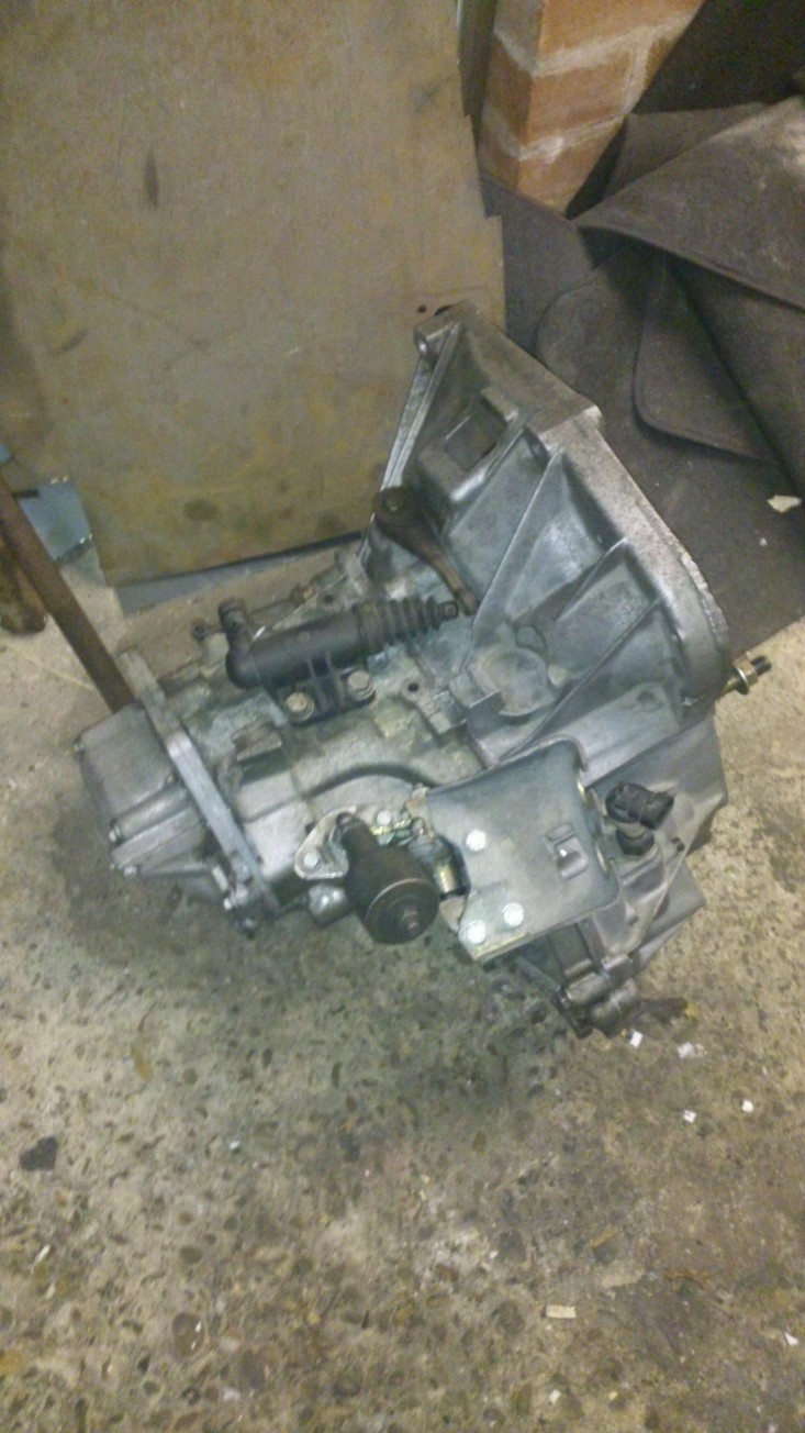

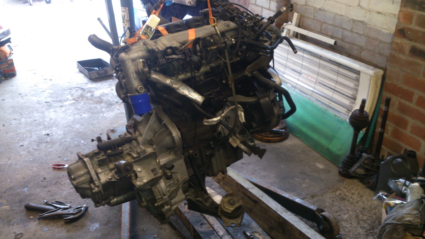

Engine is now stripped, head in pieces and having a soak in petrol to clean the carbon buildups off. However when I dropped the gearbox off the engine I discovered it was FUBAR. I don't really want to part with a sizeable chunk of cash for another JTD gearbox that i'm fairly sure will go bang with the power I want to run. I had a Coupe 20vT gearbox sat around doing nothing, so thought i'd try it on assuming it wouldn't fit (googling turns up nothing). So far i've got it bolted to the engine, starter motor fits, the coupe centre driveshaft seems to fit (with new multipla sized support bearing pressed onto coupe shaft), clutch is hydraulic so easy, gear linkage works in the same direction as far as I can see. Just need to fanny about with flywheels and clutches to get a working combo. If it doesn't work it's not cost me anything apart from 12 quid for the bearing, so no big loss, and worth the effort for a stronger box with LSD.

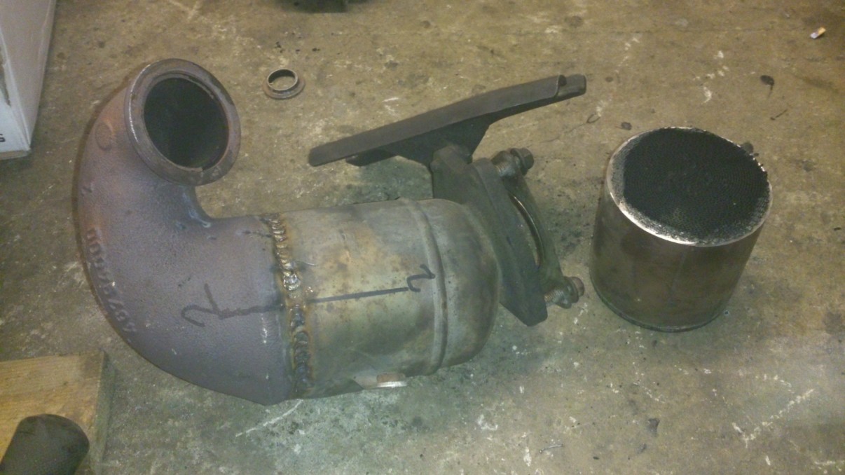

Fiddled with a cat. Seems legit.

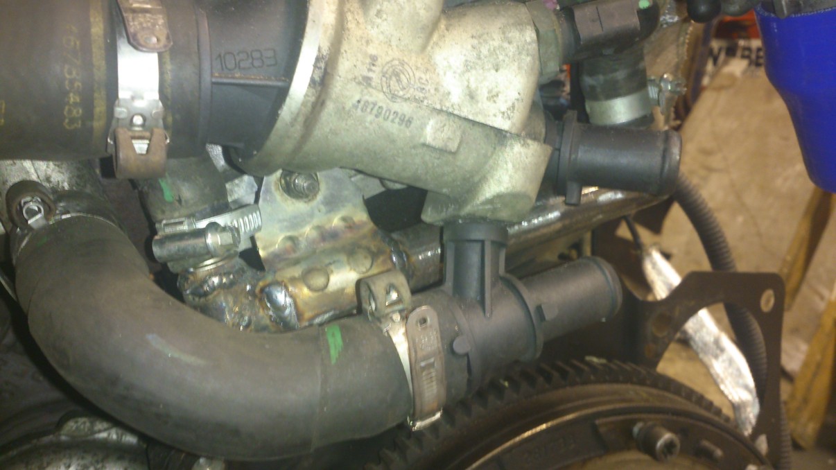

Made a water rail to go inplace of the EGR cooler.
Fits here.

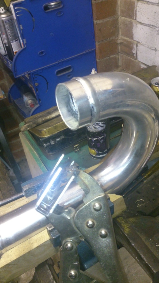

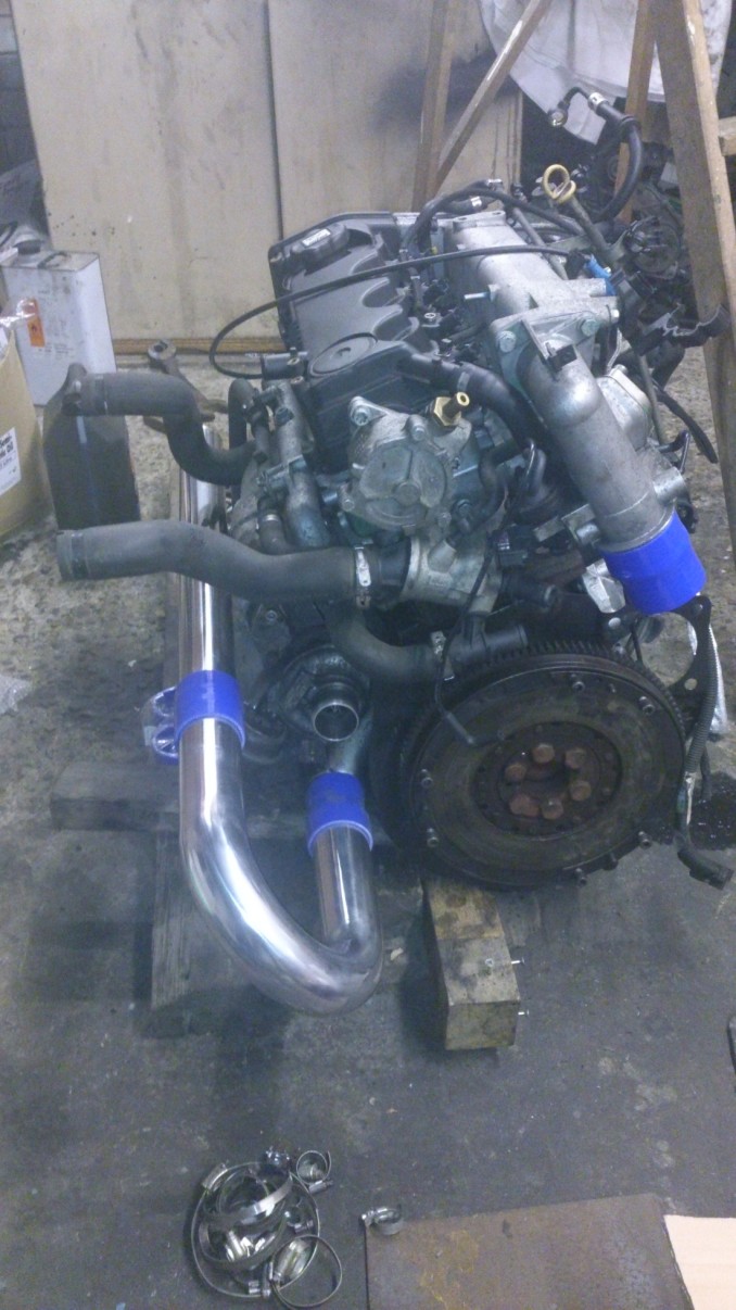

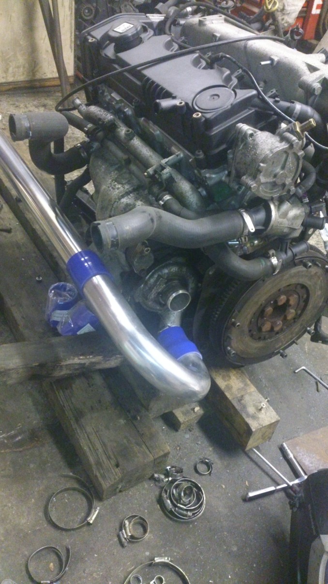

Started working out the intercooler piping. Gonna run it like this as i've got some kiln liner to wrap it in which will mean it'll not heat soak whatsoever. However the straight section before the U bend to the turbo was unnecessary.
So I modified a pair of mole grips to make a bead roller so I could cut the pipework down.
Which leaves it like this, about 6-7" saved which could make all the difference to lag.

Finished up the last few bits on the gearbox. Tempted to quickshift the linkage whilst its easily accessible.

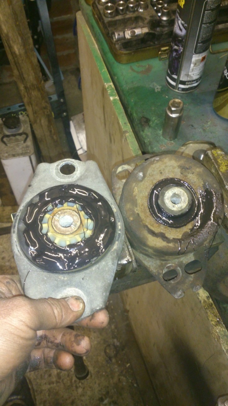

And then squirted my goo into some dirty old bush. They were pretty loose but after I squashed my goo in with my finger it's tightened them right up.

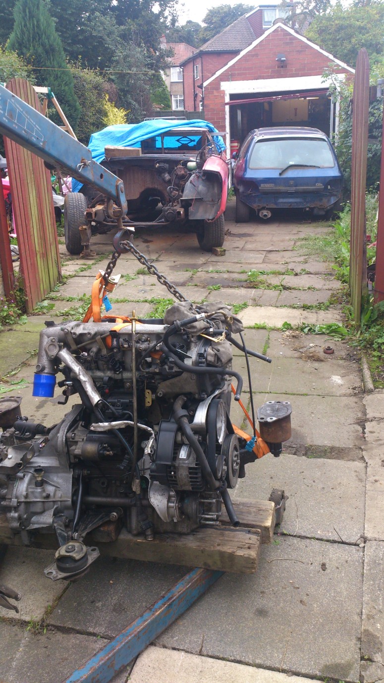

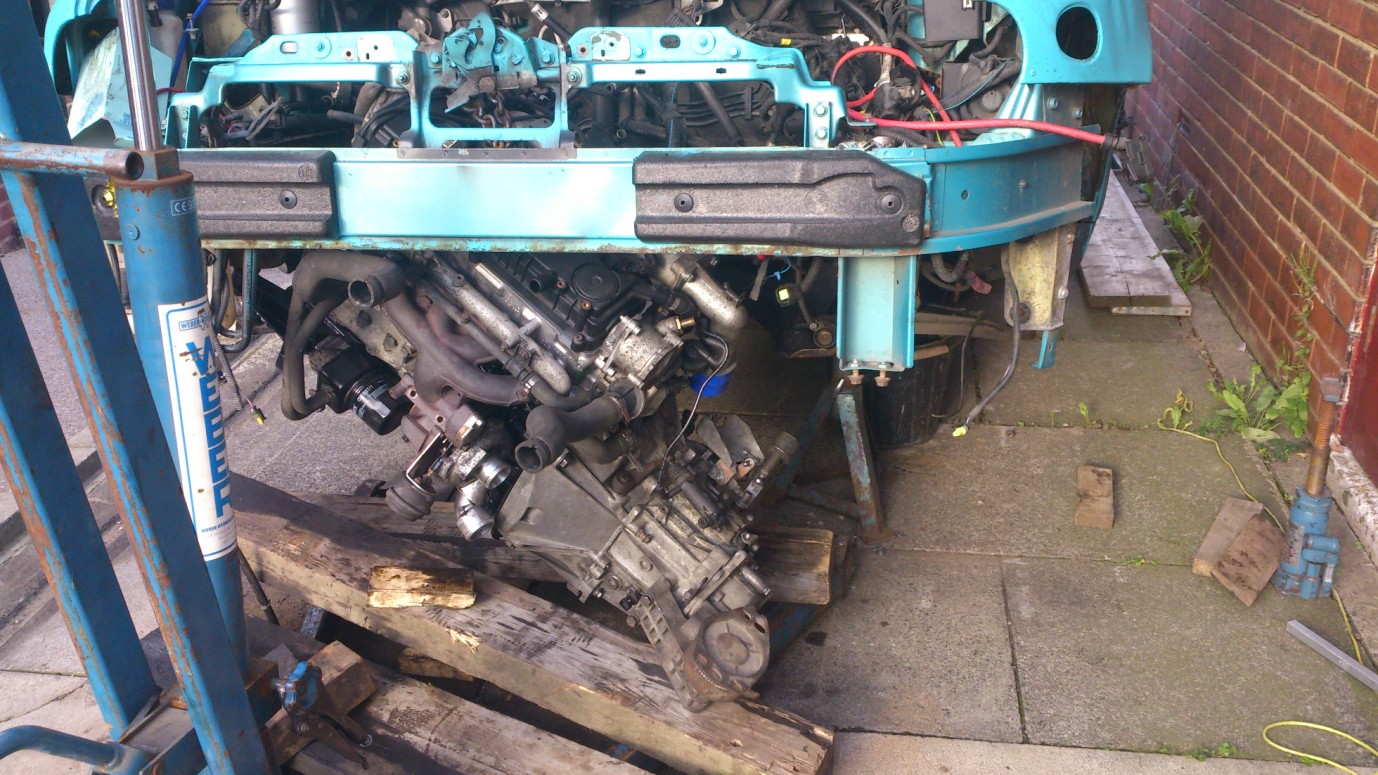

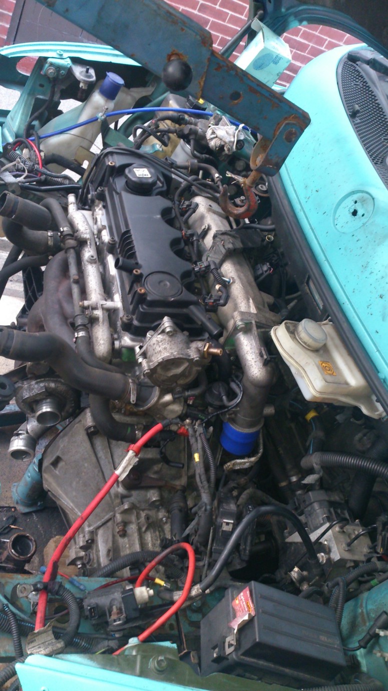

Mated engine and gearbox back together and bolted the rest of the bits on.
3 hours later it had traversed the assault course of my garden and was nearing the car.
Started lifting it in, then the strap holding it broke. Luckily my mate James broke it's fall, luckily causing no damage to himself or the engine.
And IN

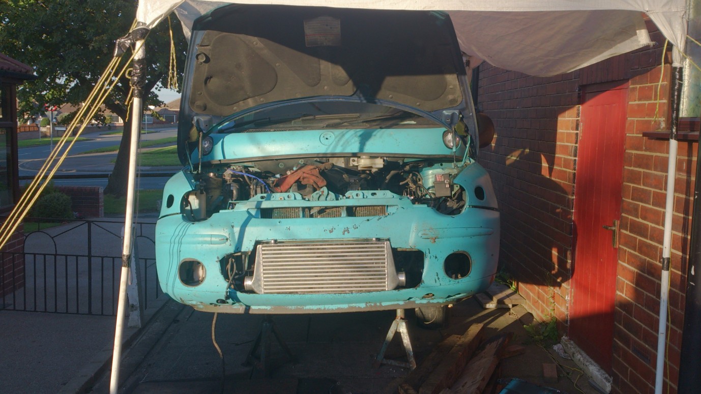

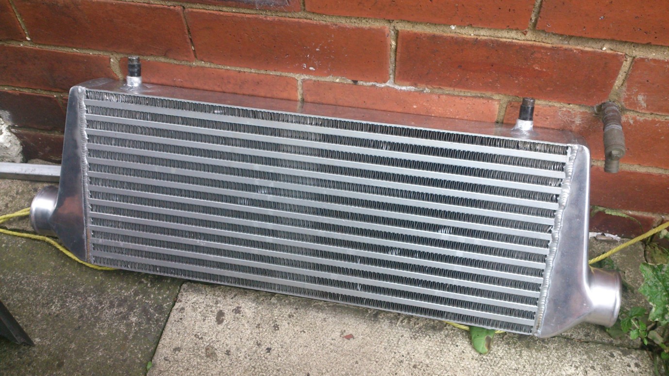

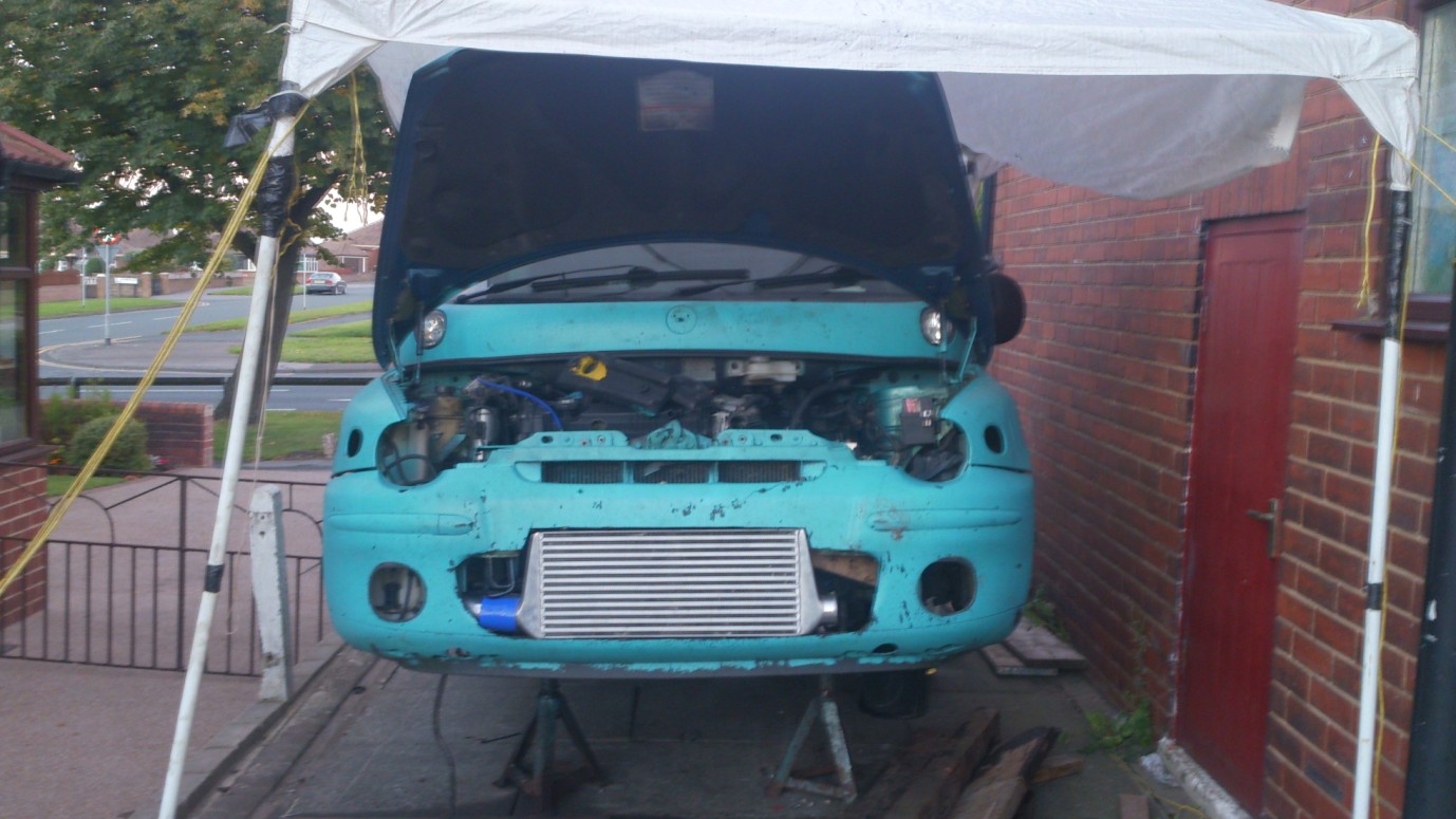

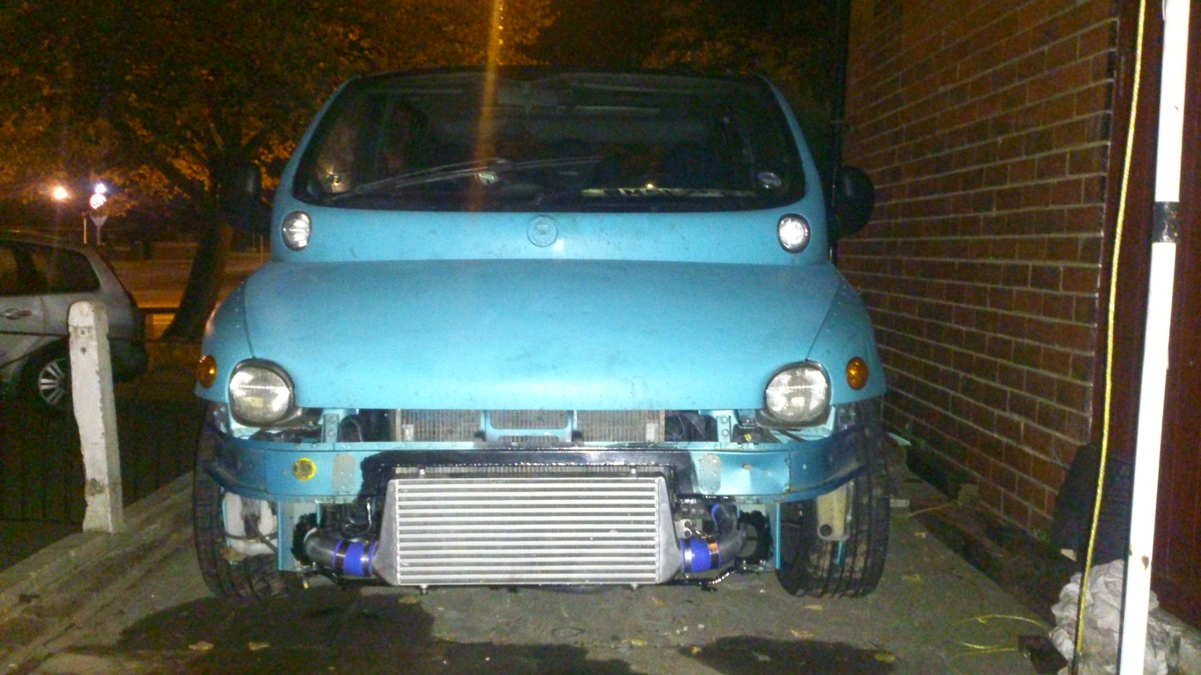

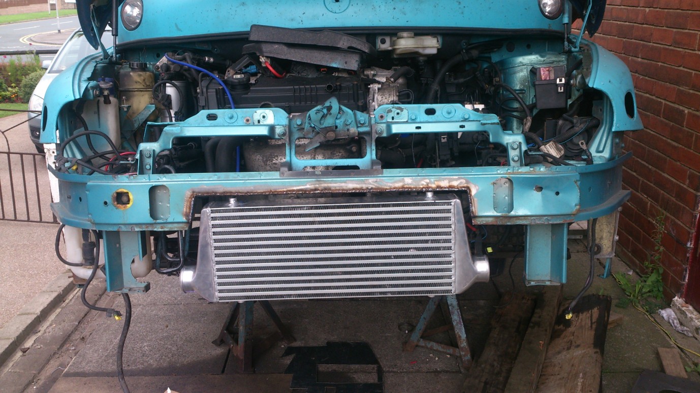

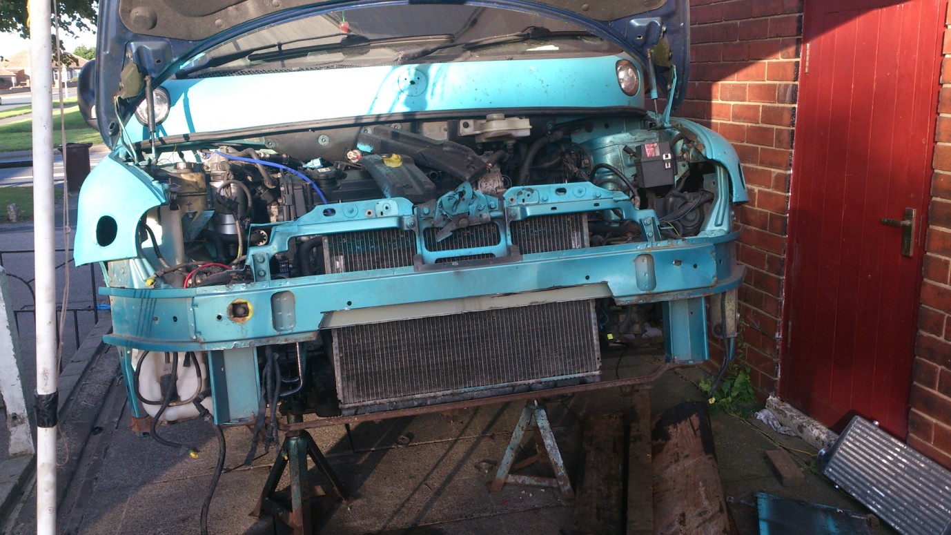

Next up - FMIC. Started trimming.
Still didn't fit.
Trimmed a bit more. Now it fits.

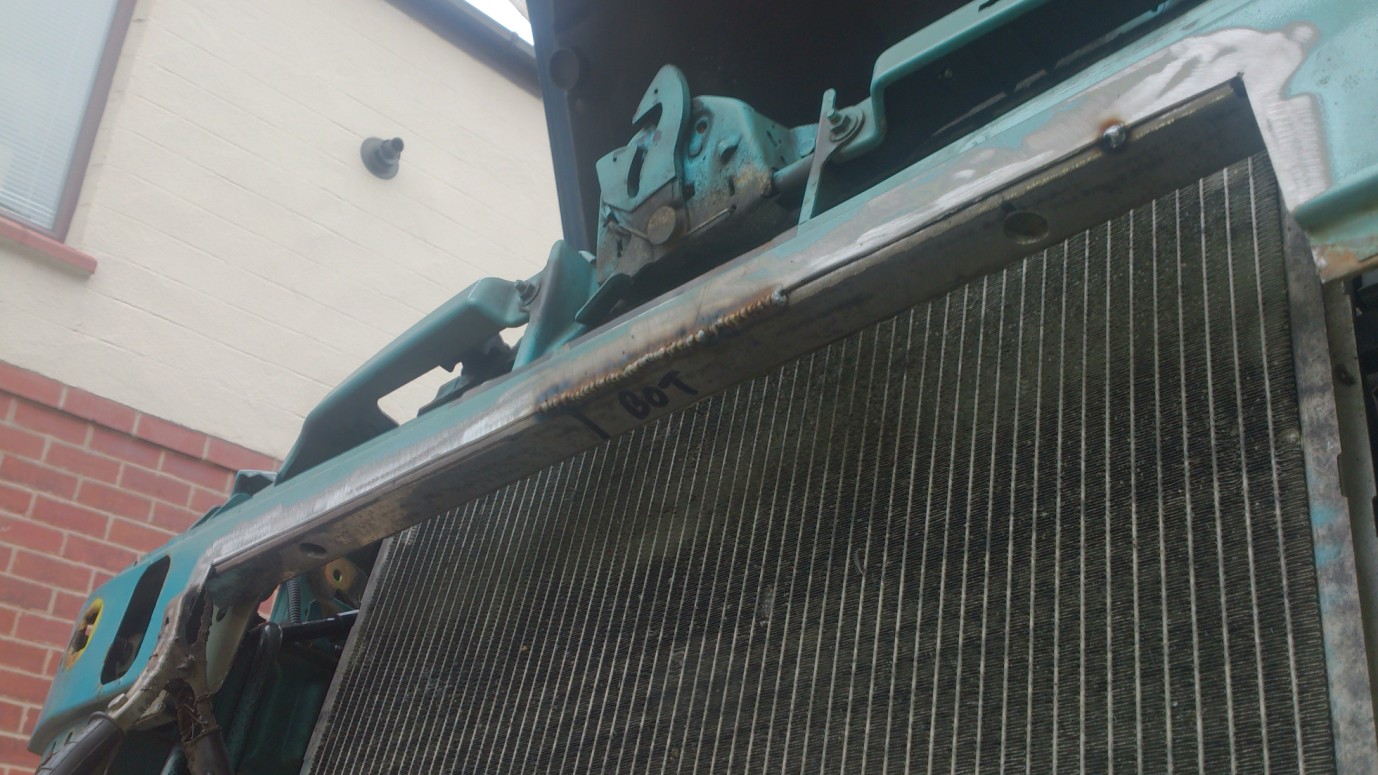

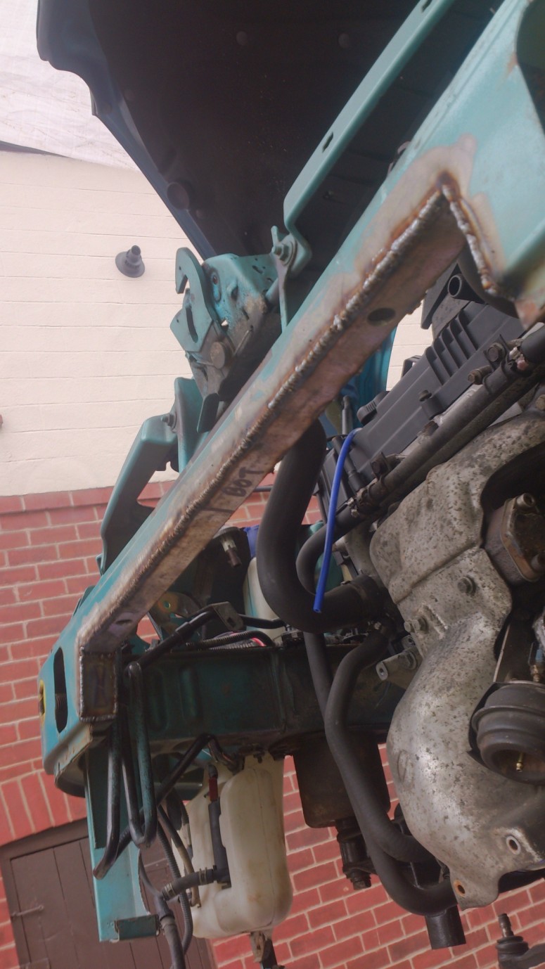

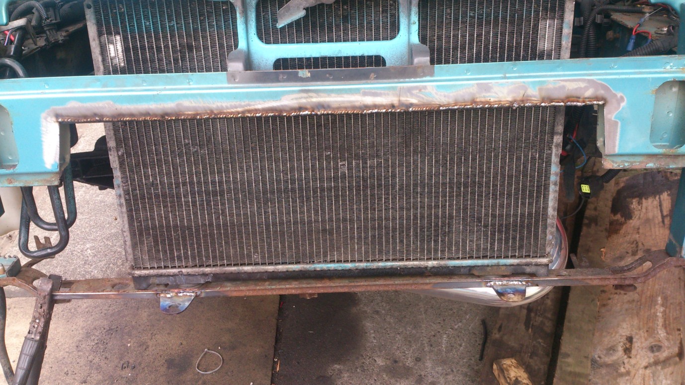

Added some thick walled box section to the resulting hole to put some strength back in. Drilled a couple of holes in the bottom surface.
Holes correspond with the mounting bolts for the intercooler. Sandwiched some rubber pipe underneath the bolts so they push fit into the holes in the crossmember. Easy.

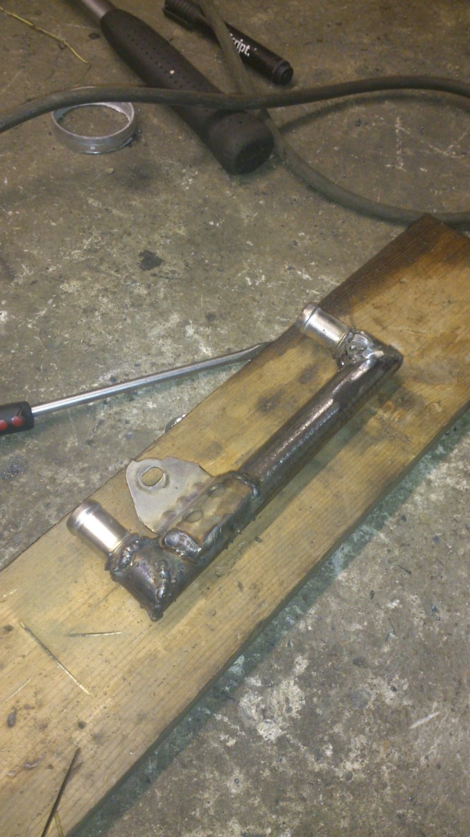

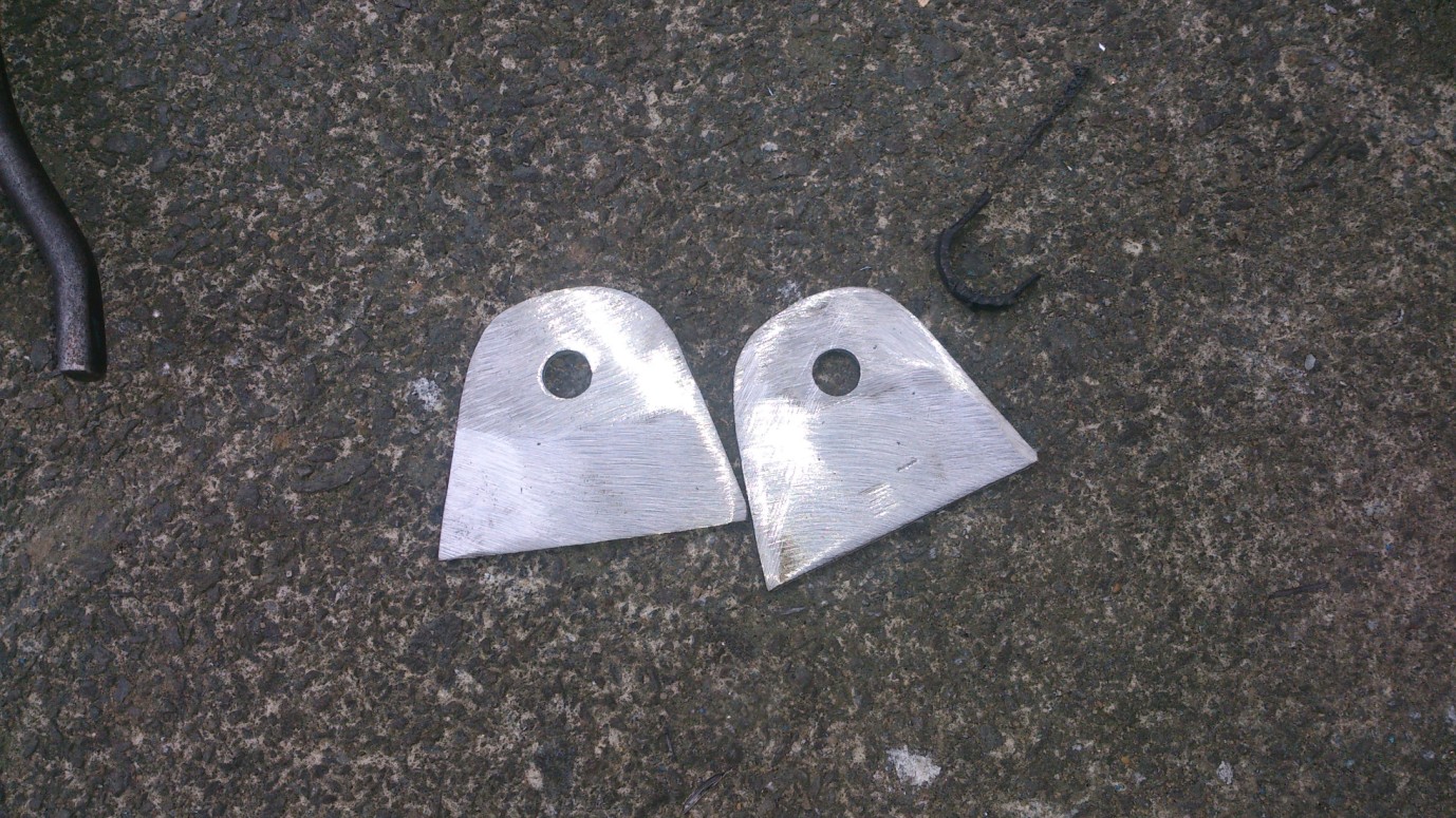

Made some brackets.
Welded them onto radiator support.
And then once all was positioned correctly I dropped everything out of the way, fully welded the crossmember in then boxed in all the gaps.
Intercooler now fits like this, then once it's painted the rad support and go back in and hold it up (straight too, its dropping out of the O/S mount in the pic as it's not supported.
That's where we're at as of an hour ago. Going back out now to lash some paint on.

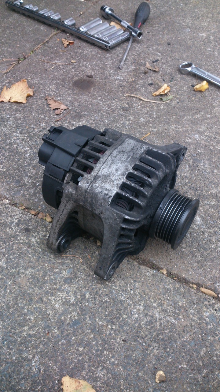

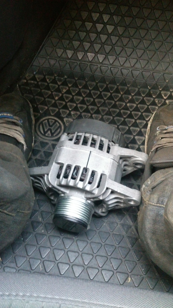

So where were we - oh yeah the maiden voyage. This was only partially successful. Engine seemed to run OK, gearbox seemed fine, but the charge light was flickering and it was registering faults faster than I could remember them. Tested the battery with the engine running, varying between 9v and 17v. That'd be the alternator knackered then. I googled how to change it and read a load of horror stories about dropping subframes, moving driveshafts etc. Anyway I dropped the exhaust off of the downpipe, undid the connections and bolts and it came straight out of the gap between the rear engine mount and subframe. Took about 20 minutes.
Luckily my dad was on nights so he picked me up and we went to the shop of a guy he used to work with who does recon alternators/starter motors. He sorted me out with a reconditioned alternator and new clutched pulley. He's not particularly cheap, was £120 for that, but I know he does a great job and they're a lot better quality than the cheap crap coming through the bigger autofactors.

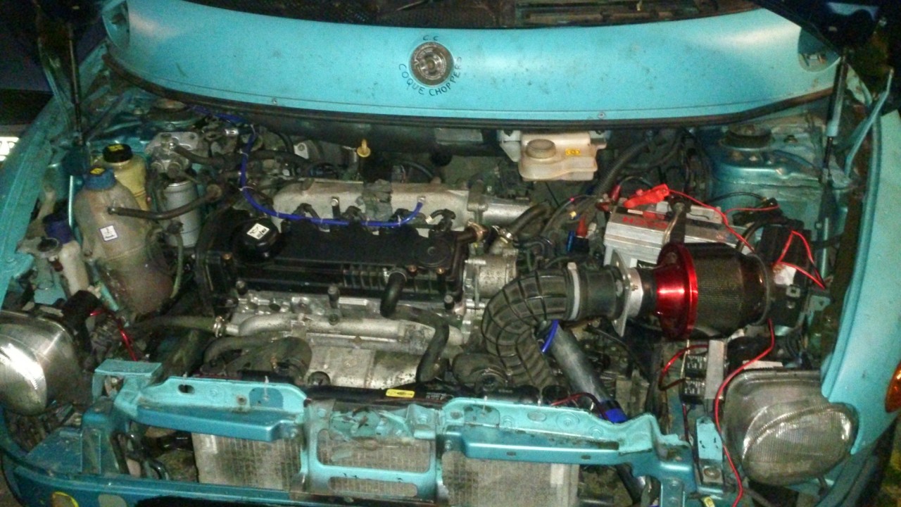

Finished engine bay - the airfilter setup is ****. Going to be changing that soon.

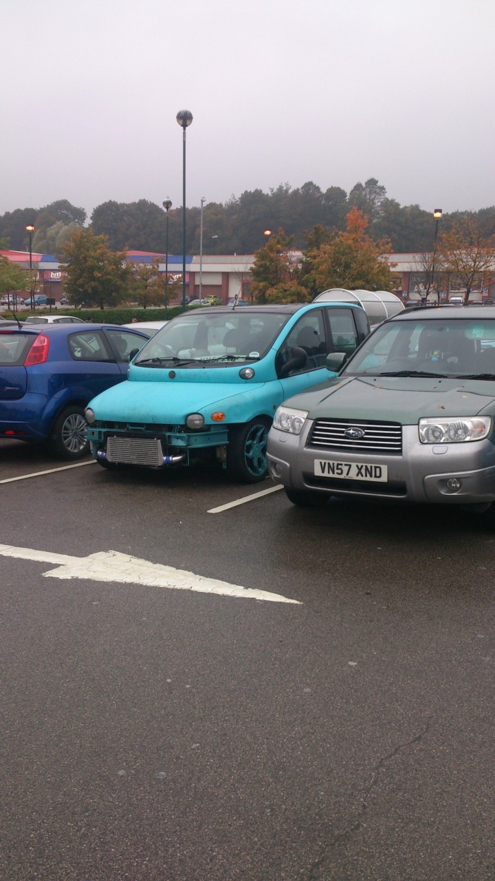

Went to ASDA
