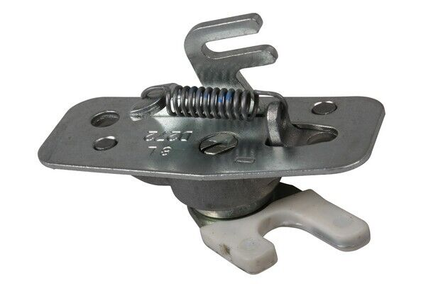

Does it look anything like this, in which case is the spring part working? Also if door not correctly aligned they have the habit of the locating/locking pin riding over and jamming.

If that lock catch is faulty, it should be a case of of unbolting the two 10mm bolts and easing it out and unhooking the operating rod.
I have changed several over the years but usually on basic vans so maybe more access than a camper with interior paneling, mostly it was a case of popping off the clips holding a simple card type cover on the inside of the door.
First with door open I would turn that lock to it's fully closed position and then pull on the door outer handle, the clip should spring to it's fully released position, if it does, simply oil it and leave it alone. The main adjustment is by the door slide mechanism to get it to align and then any final adjustment is done, from memory by slackening and moving the 13mm pin on the van body that the lock catch engages with. From what you say if the rest is working correctly and aligning as it should , it may just be a case of a small adjustment of the 13mm pin/peg that the lock engages with.
