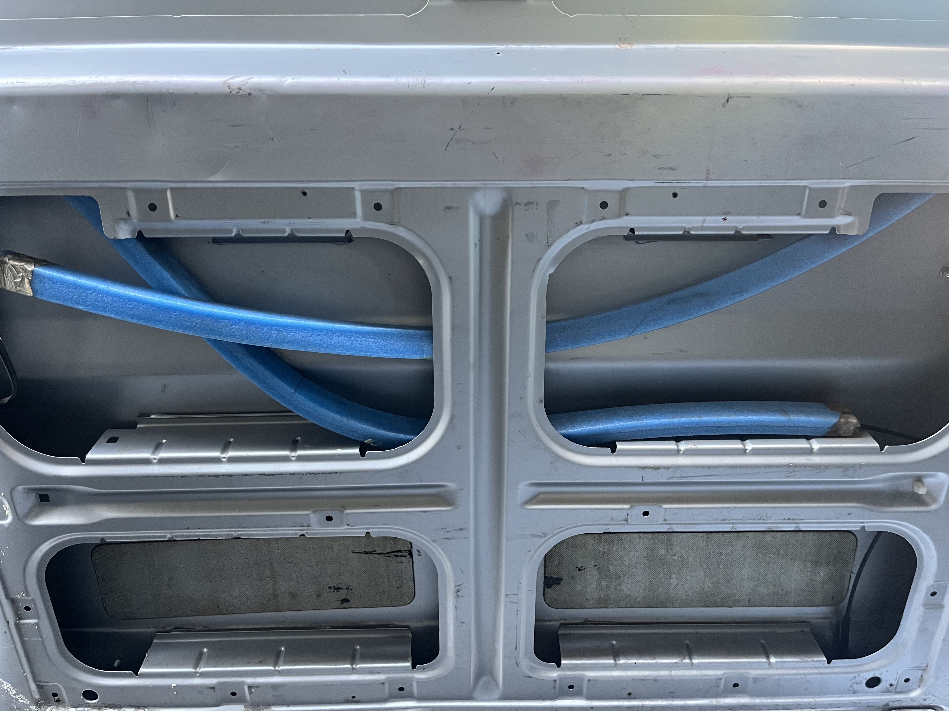

See above picture. In answer to the other question when locked you can still open from the inside (assuming this is a safety feature) as mentioned
Hello
On mine the lower one in your picture is the outer handle main latch cable.
Disconnect it from handle and latch and make sure it moves freely - when removing, start at the handle. If the Bowden cable appears too long and is trying to loop up and out of the aperture the issue is at the main latch.
If no luck with cables and oiling then it may mean a new electrical door catch.
See if banging door in that area as activating unlock button makes it work, this would again indicate a dodgy electrical lock.
