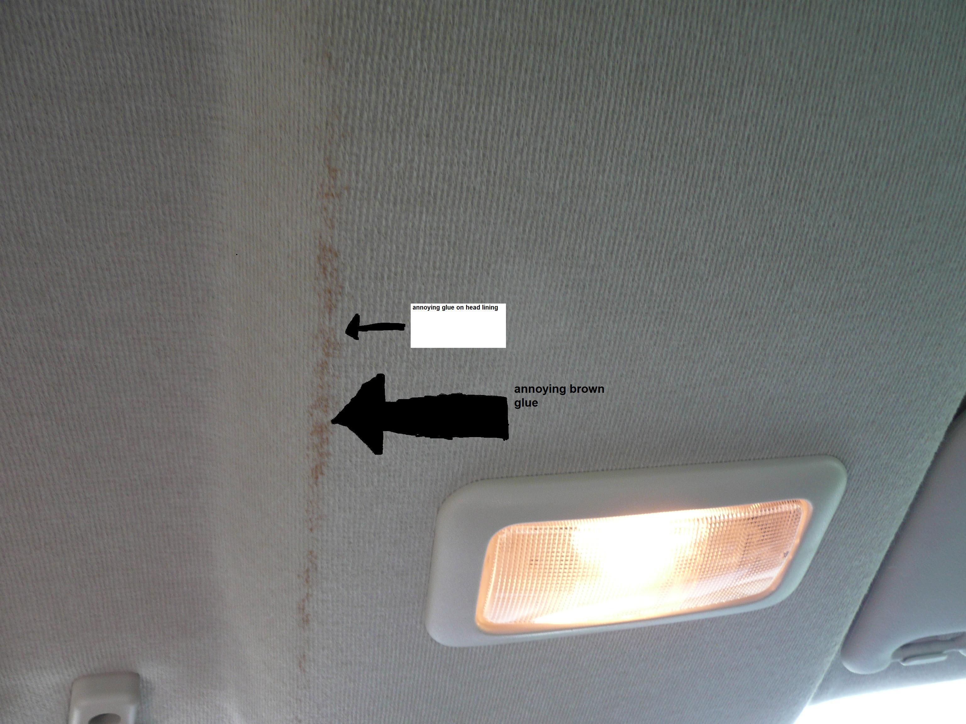

is anyone able to tell me the part number for this type of interior light for the gp please:
as in the actual light unit.
thanks
