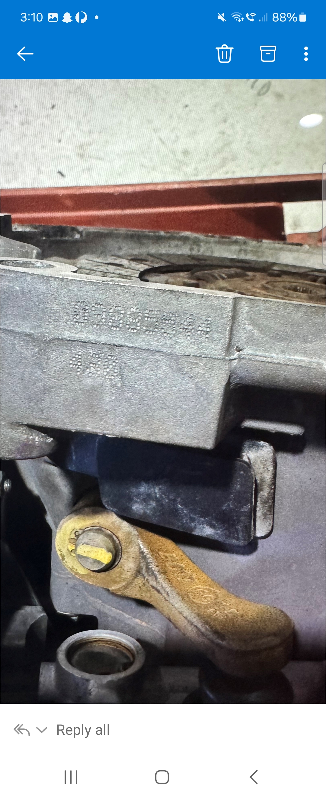

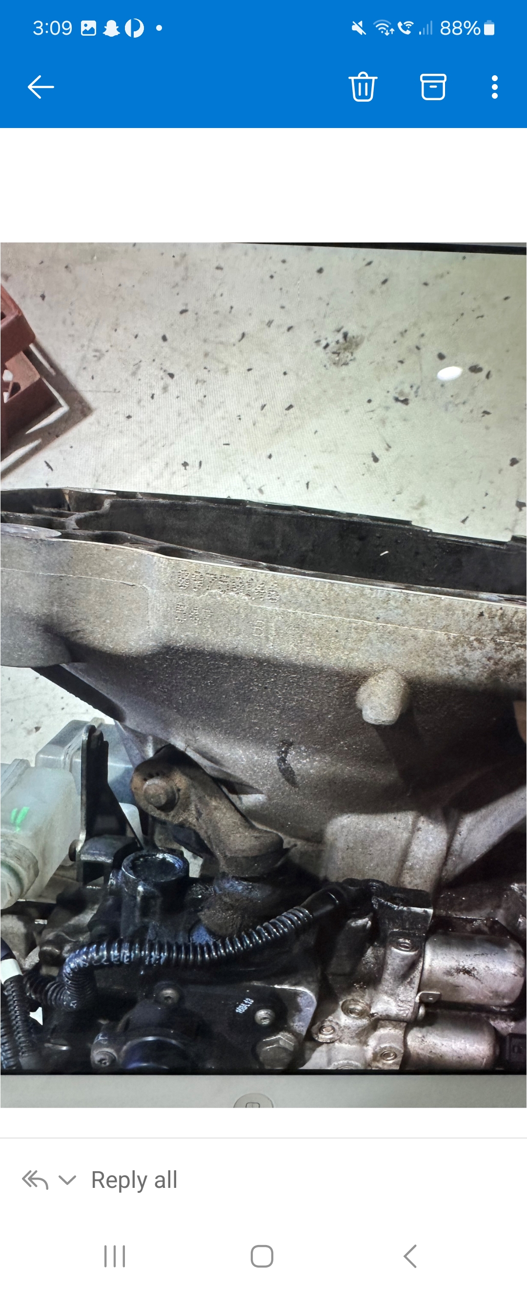

I have a fiat 500 convertible, 2014 located in Australia. End of last year I was advised my the fiat launceston mechanic I needed a new gear box as the reason for the high pitch sound on accerlation. The quote was 11k at the fiat mechanic in Launceston. I elected to source a second hand gear box from a wreckers. I provided a wreckers with my vin/rego number, and they sent a gearbox to the mechanic in Launceston. The gearbox arrived at the fiat mechanic 2 weeks before my car was scheduled to have the gearbox replaced and therefore I asked them to check the gearbox I sourced was going to be suitable for my car. They advised yes.
Forntight later, I drop my car off to have the gearbox replaced, I get a call the next day saying they have taken my gear box out, only to find the one from the wreckers ( that I had asked them to check when it arrived to them 2 weeks prior) is incorrect for my car. And therefore I could leave my car in parts whilst I wait for them to order the new one ( up to 10buisness days) or I can pay an additional 2k ontop of the 11k quote to have them put it back together with original gearbox, whilst awaiting the new one to arrive. Obviously I elected to leave it dismantled, however this was extremely inconvenient as it left me without a car for 3 weeks, having to find transport between the mechanic and my place of residence 100km away and the cost of a hotel in Launceston given they had initially said it would take 2 days to for repairs.
The fiat mechanic sent me pictures of my gear box and the incorrect one ( incorrect one is the brown crate), I noted serial numbers/codes on each in the pictures.
I questioned the mechanic as to why they needed to have my original gearbox removed, sitting next to the wreckers one to then only be able to tell they where incorrect.
Surely, when I requested 2 weeks prior to check the gearbox I organised was correct, they could have used the serial number on this gear box( which I can see in the picture) and the details of my car to check online it was a match? Or at the very least, checked the gear box/codes of each matched the morning of repairs, before pulling my gearbox out? And when I questioned the Launceston mechanic ( who is a registered fiat mechanic/dealer) on this, he said no such system exist. And when I asked well how he does order me a new one as that surely comes with a code. He replied they call fiat on mainland, tell them my car make and get a gear box sent, no serial number or gearbox codes are exchanged ( I.e I Smell bullshit) .
They ultimately left me with no choice but to get them to source a new one( 11k) and leave me without a car for over 2 weeks whilst waiting on the new one unless I wanted to fork out another 2k, when they really shouldn't have had to take my car apart to get to that conclusion they didn't match?

Hello and a very warm welcome to the forum. Sorry to hear about your problem - but well done for finding the right place to post about it.
Ouch! I'd have found that somewhat painful.
Is a 10 yr old 500 even worth 11k?
That's close on £6000 sterling.
I'd have thought scrapping the car would have been a cheaper option.
This sums up the problem in a nutshell. Dualogic transmissions generally don't last the life of the rest of the car, and when they do fail, the repair often costs more than the car's worth at that point, leaving their owners with a nasty dilemma.
Agreed. When I was sourcing a second hand gear box it would have only cost me 5k in total, which was okay. As I also couldn't sell it cause it was so noisy.
But am I correct in that they could have checked the number on the one I sourced from wreckers, and determined it wouldn't have fit my car before pulling it apart and therefore forcing my hand to spend the 11k. As if I had been told the wrecker one was incorrect, I wouldn't have pursued the 11k repair and just wrote off the car

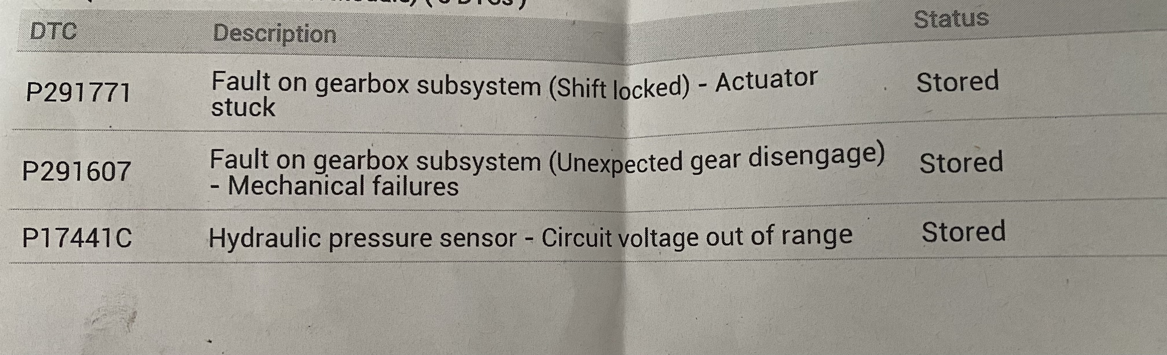

Hi, I seem to be having similar issues to Adrian above with relatable fault codes on my wife’s Fiat. “Check transmission” warning pops up intermittently but car drives on without issues. It has appeared probably about 10 times in the last 4 months, car is driven daily. The mechanic whip ran a diagnostic today cleared the codes and checked over the transmission what he could but then the warning popped up twice on the way home. Does anyone know of a dualogic specialist in the North Lincs Area? I know Stoneacre in Scunny are the local FIAT dealers but are pricey. Model is a low 30k mileage 2015 Fiat 500 Lounge Auto. Reading through the thread has put me on edge given some of the costs I have seen banded about. Seemd quite a few people seem to suggest getting rid once this type of issue starts. Thanks in advance.
You've found the right thread to post about this, and if you read through it, you'll find what's pretty much the collective experience of this forum.
40k is on the low side to be having issues mileage wise (though we've seen even less), but 9yrs old is spot on for the age when these transmissions often start to give trouble.
There are numerous seals in the dualogic part of the transmission which both deteriorate due to age and wear due to mileage.
Generally I've advised folks to just chop these cars in at the first sign of trouble, but if you've an otherwise excellent, loved 9yr old low mileage car, an actuator strip followed by a recalibration, with possibly a new clutch, might be worth considering. There are a few specialist garages able to do this; one of which is in Stoke on Trent. I'd expect this to cost a little under £1000 all in.
I'm not sure it's worth taking it to a franchised dealer; they would likely advise replacing major components at a cost of several thousand pounds, and will charge you several hundred pounds just to tell you that.
