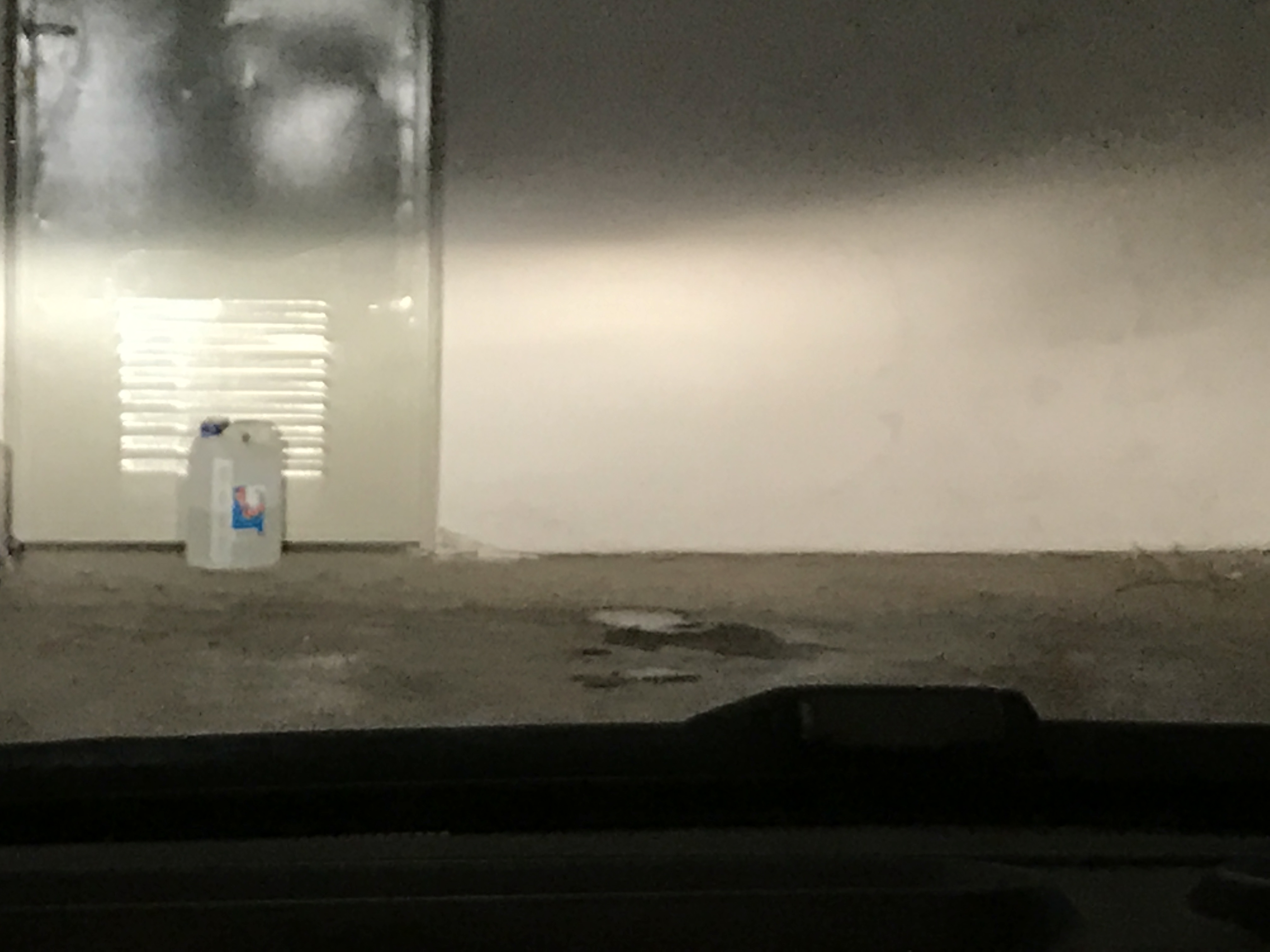

My Dualogic started to leak again. No indications on the dash or anything else amiss. Luckily the warranty on the gearbox is 2 years so booked an appointment for 21 November. It is the only date available as it's the only Fiat/Lancia/Jeep/Dodge/Chrysler main dealer this area of Athens so it's very busy.
They did tell me if any lights come on to immediately stop driving it and get it towed to them and they will try to look it over, as driving the car knowing that there is a fault will invalidate all warranty claims against Fiat.

Damn, again?!
Are you sure its the dualocrap?
Damn, again?!
I can't see the leak being from anywhere else, i felt it it was sticky so it has to be the gearbox oil! Coolant isn't sticky and the engine has oil up to the max no leak there. Let's see what they say. Will keep the forum updated on the problem and solution and what Fiat main dealer will do about it.

Fiat dealer checked my car today.
They told me that the leak was from the left driveshaft gearbox seals. Offered to fix it for 90 euros, I will go to indie to check their quote as I have to change rear brake pads anyway, they are squealing permanently now = )
At least it is not the Dualogic system for once, its the gearbox itself!
