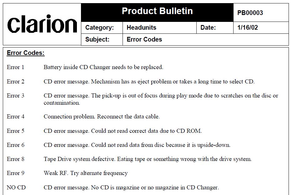

I have just signed up to this Fiat forum today as I have bought a 2005 Scudo van. My radio code is locked and I have read your thread where you have helped people with the correct code. Would you mind to help me please? My radio details are below. It currently shows 9 error on the screen so would you know how to clear this as well please?

These are the Clarion error codes. If the error appears on all frequencies, it could be a problem with the aerial or aerial lead.
