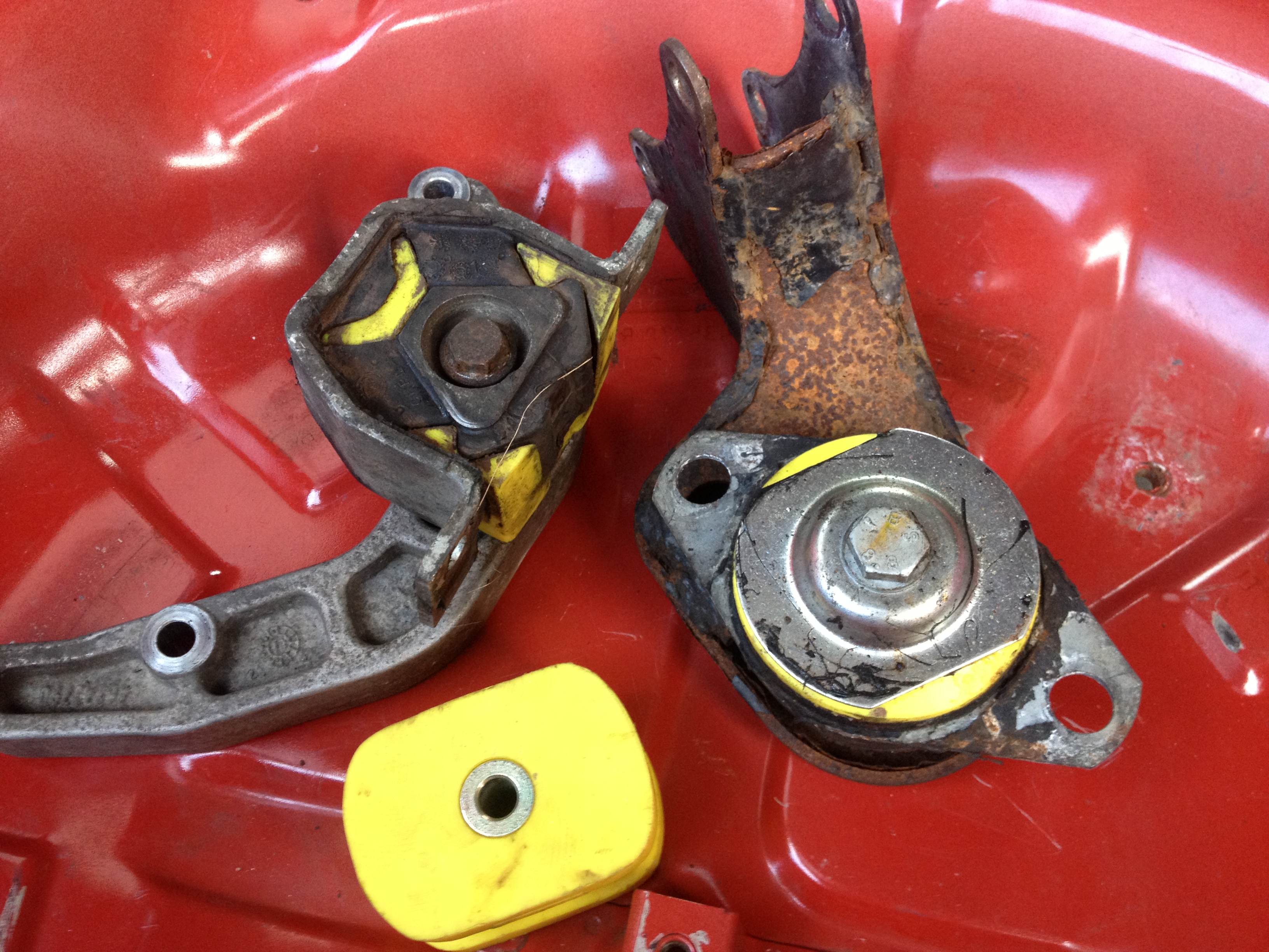

And then onto my favourite... The engine mounts....
With this beauty, it seems to have been welded to a single skin part of the car which has no under support as far as I can tell... The mount looks to have given way (well at least ripped the metal work apart)... and then fixed with perished exhaust rubbers... Im guessing by the look of the half width cambelt, the engine has dropped while running...
We then have this other 'custom' mount on the gearbox side.... (there is one to the rear, but I haven't got a pic yet... I will however as that's a beauty too)...
Other than the fact the wirings bad, the mounts are awful, its an eyesore, and the car is stuck in gear.. I think ive got a bargain... *rolls eyes*

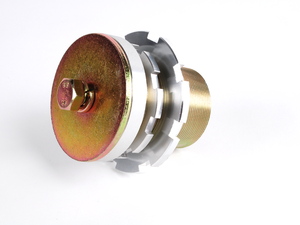

Powerflex's new sell is that all the crush tubes are stainless. The logic is sound enough -- if the surface that bears on the polybush gets rusty, you'd expect it to abrade it to bits.
Lithium or silicone or copper grease will help, but only for as long as it stays in there.
Unfortunately the prothane ones for the MR2 are mild steel, too, and there are a lot of them. Desperately need to replace the ones on the tie bars -- lift off hard in a straight line and you can feel the rear toe change: lift off in a corner and it will bite hard. :(
The Strongflex inserts blistered and the rust started to bond to the poly bush so needed a good bashing to get out. The things are too big for the rear arms and get squashed, I needed a jack to get the arms to go on. The inner ARB bushes are a pain too.
IMHO, they are ok for track days but not everyday road use.
I fitted Powerflex to my other Seicento about 2 years ago and no squeaks yet. The material seems to be of a self lubricating type.

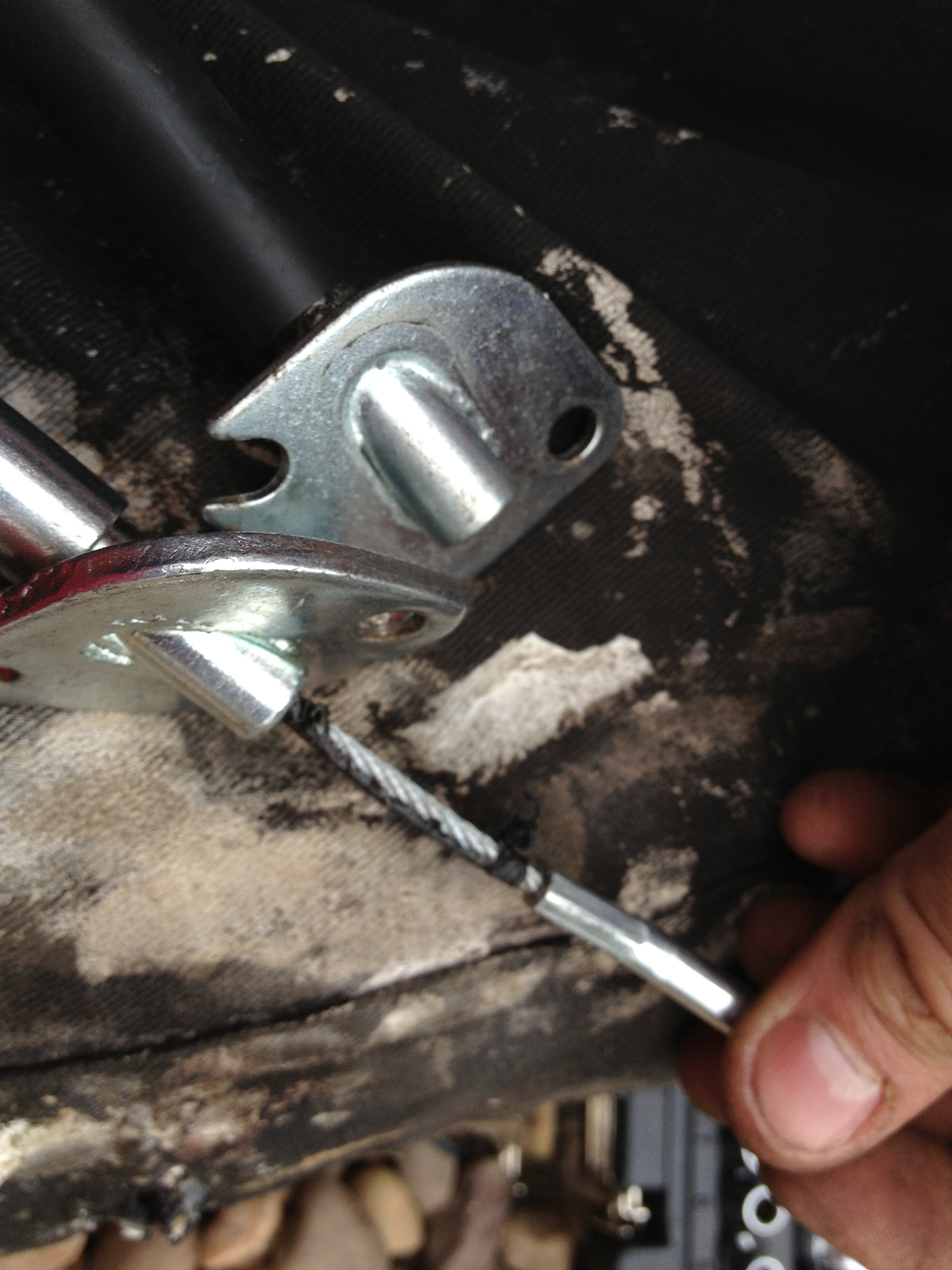

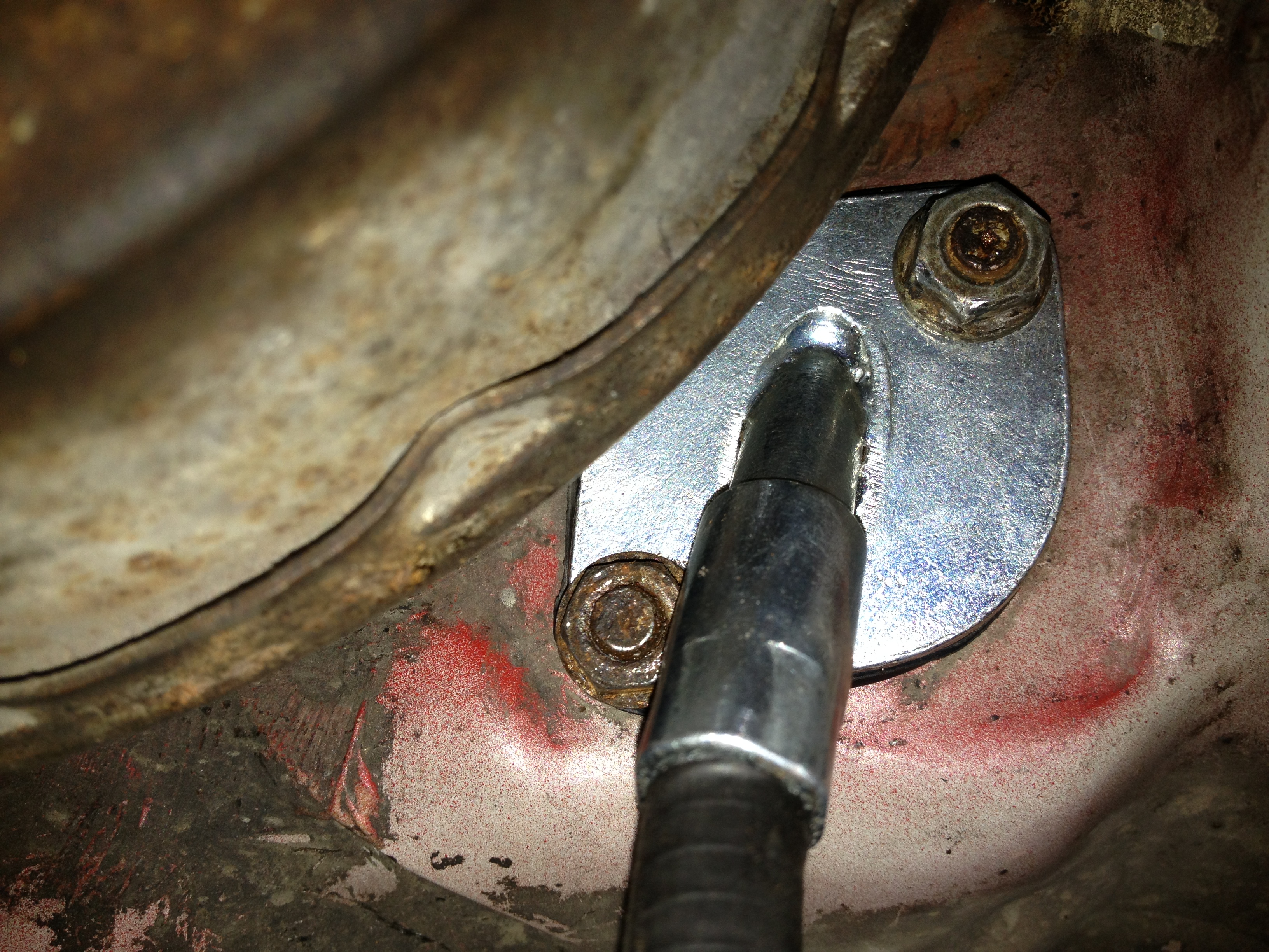

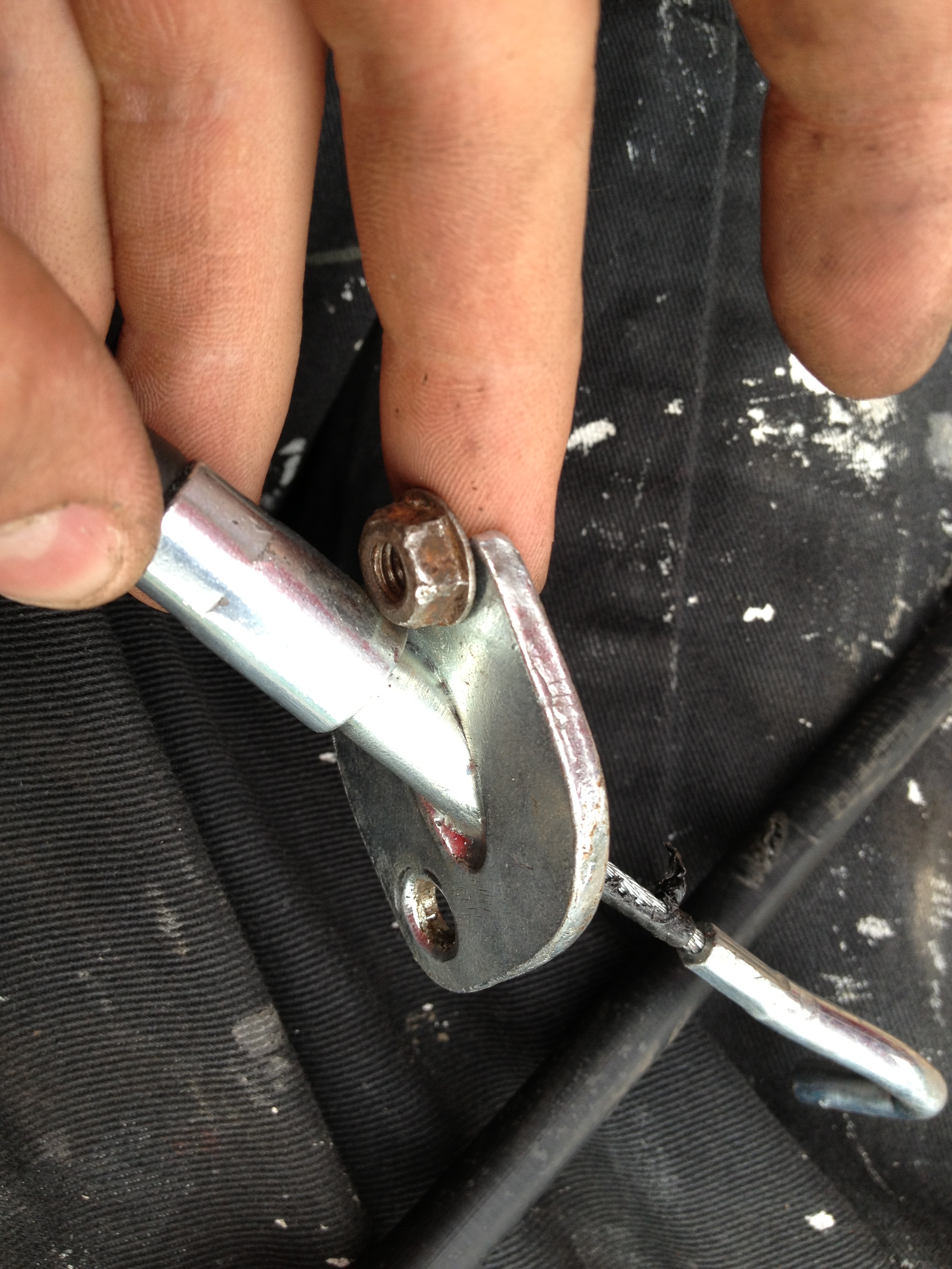

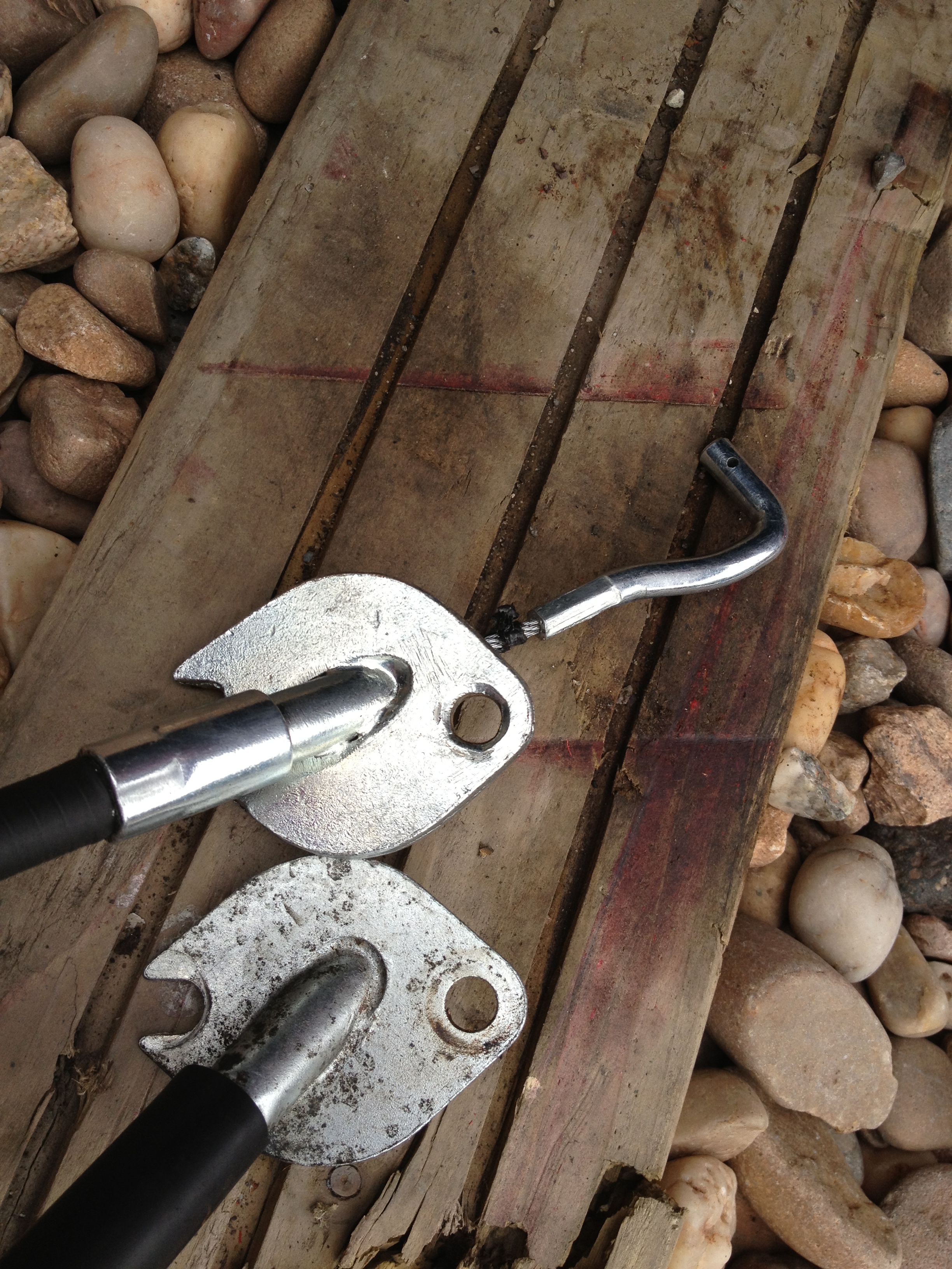

The nightmare clutch cable turned out to be made and quality controlled by a cross-eyed monkey, giving no end of problems..
It was fitted only to find that one of the bolts was practically impossible to bolt up due to the cable design... And once installed and tested, the cable was rubbing against the cars inner metalwork...
A quick phone call to the supplier and they ordered me in 3 others to choose from...
Sorted now thank god... Although I seem to have a strange score of wheel missing, with no clues as to what's catching it :S

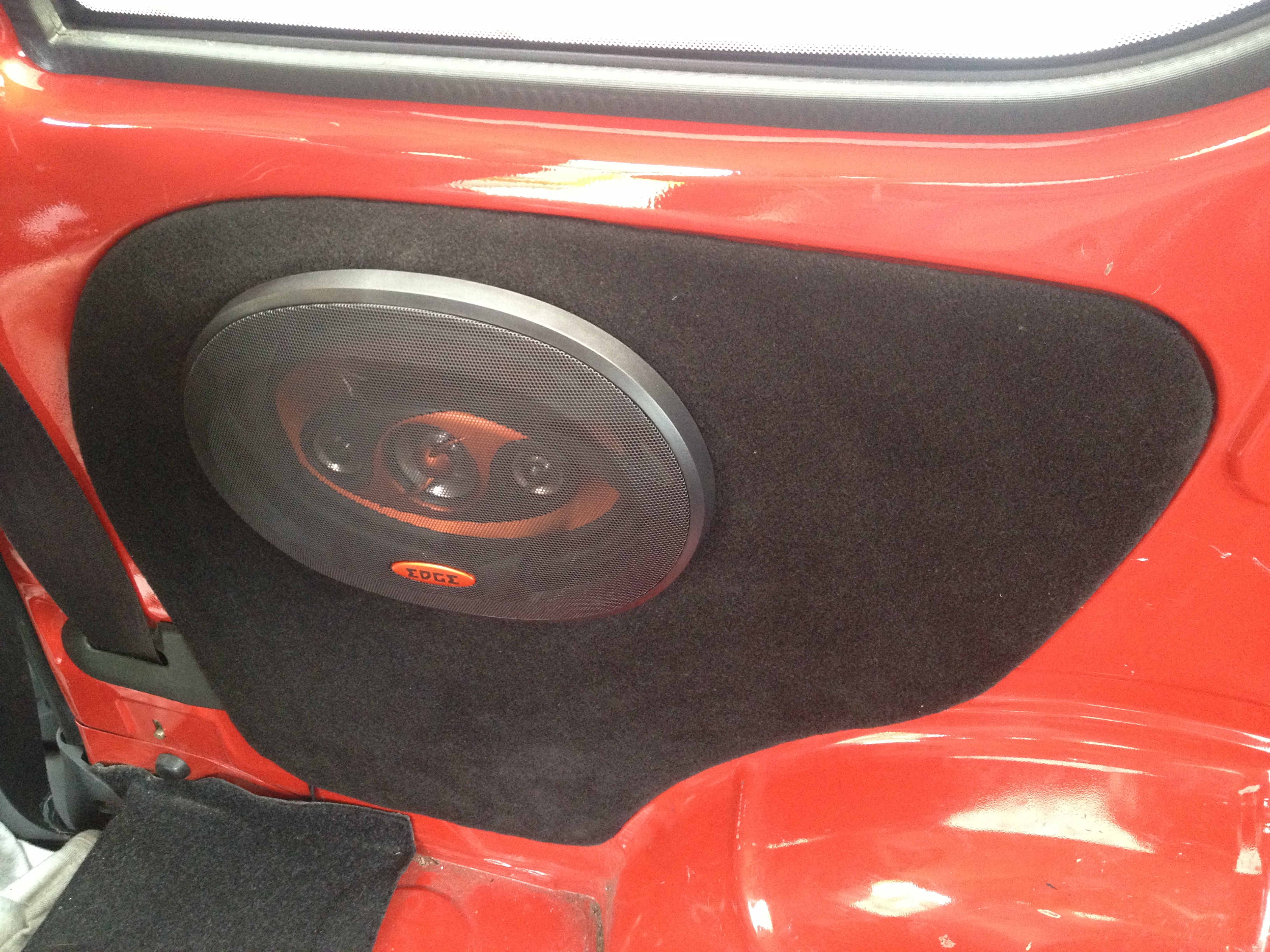

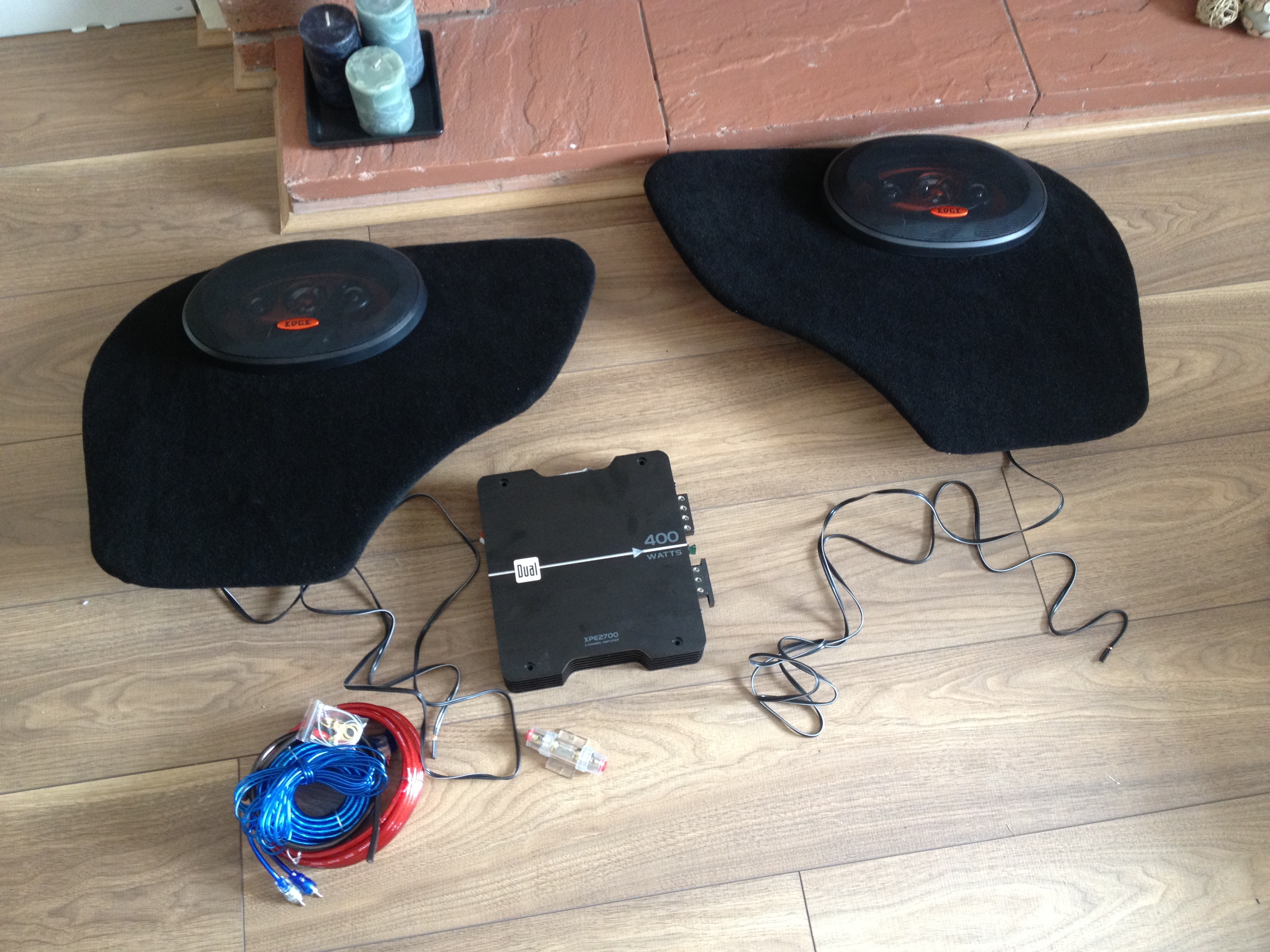

The only other bits ive been doing is in the way of audio... Ive replaced my Kenwood 4" front speakers with some EDGE ones (£15 from Halfords).... And they sound MUCH better (think their rebranded old stock vibe, as all the freq & spec are the same)...

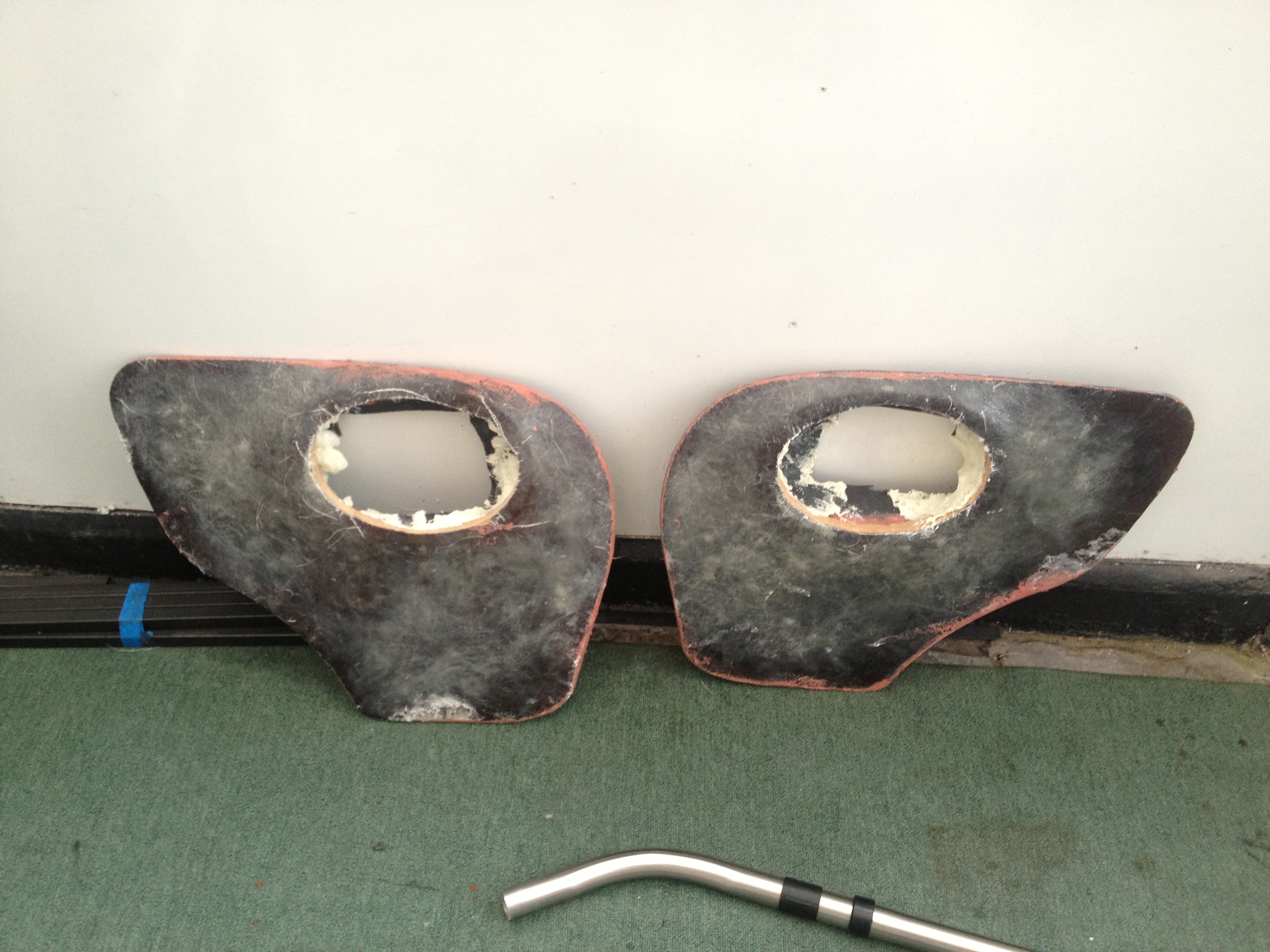

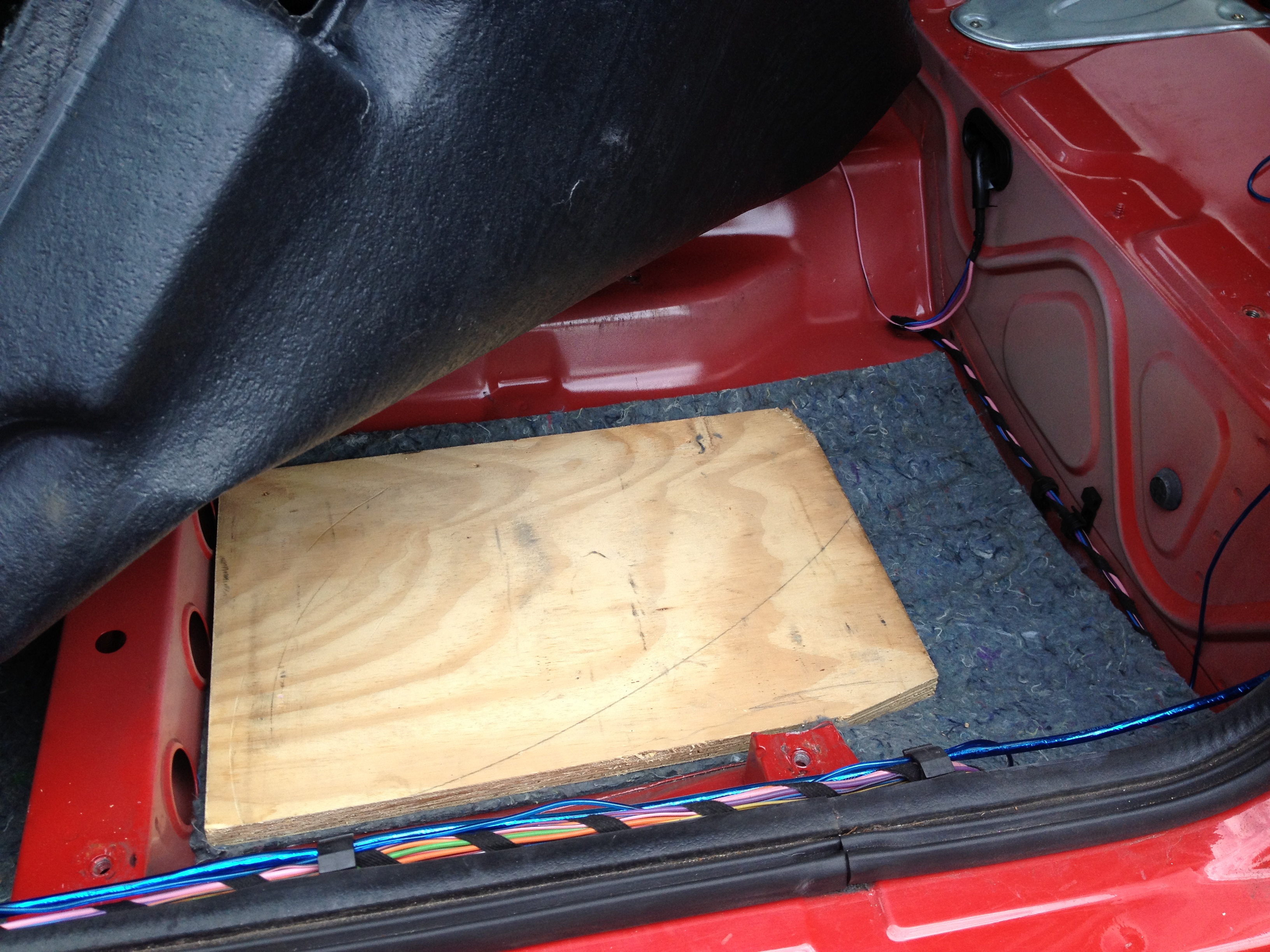

And started on the rear panels to house a pair of edge 6x9s (£24.99 down from £44.99)....
I usually go with decent branded products, however this car wont really be an audio beasty once I get the annoying exhaust drone and turbo noise to listen to :p

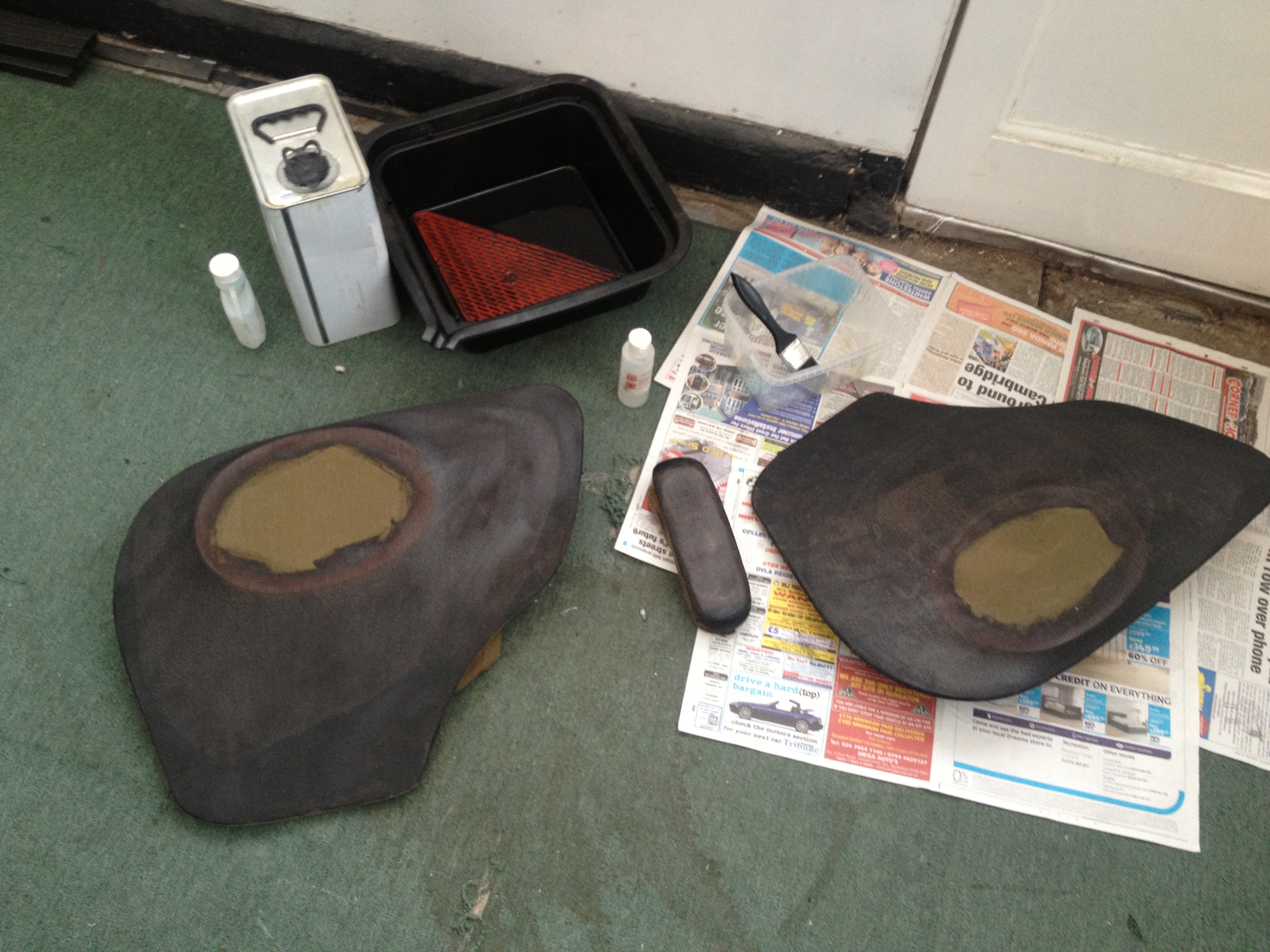

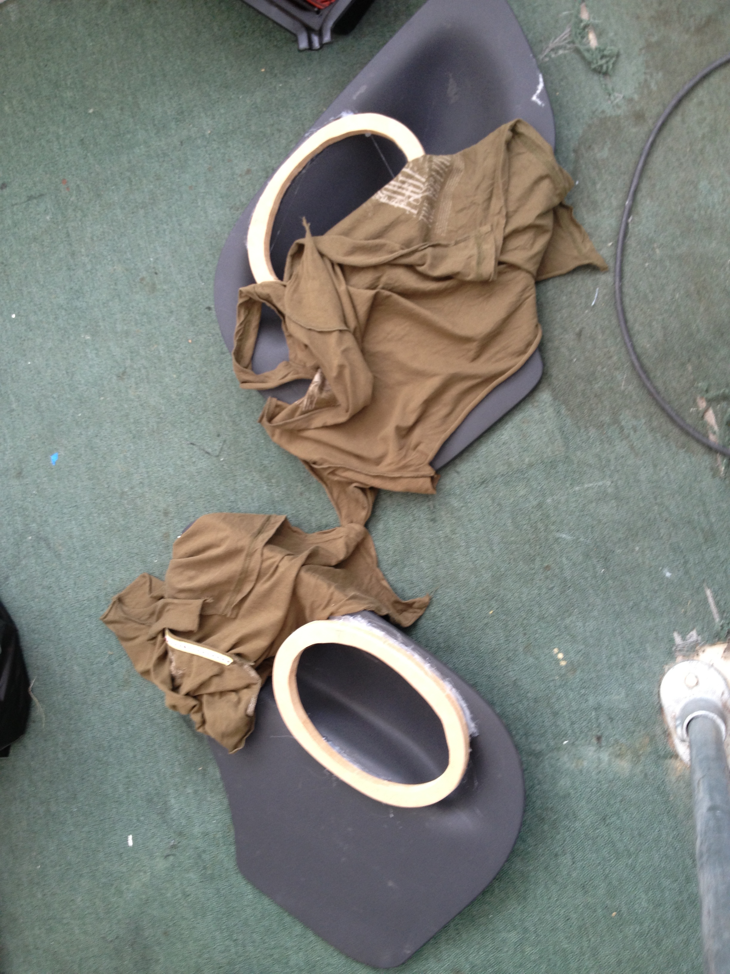

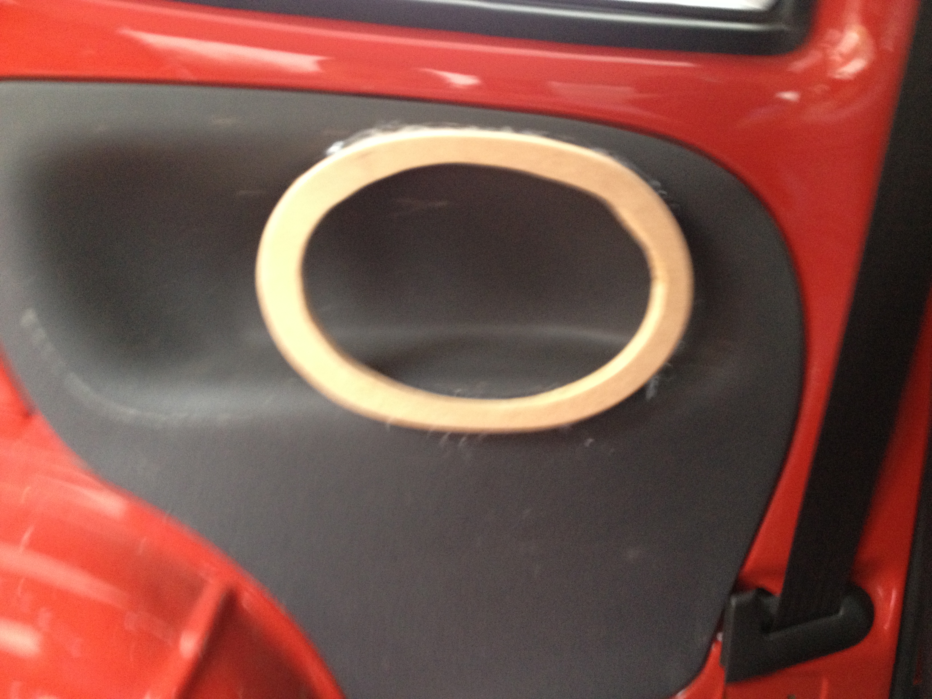

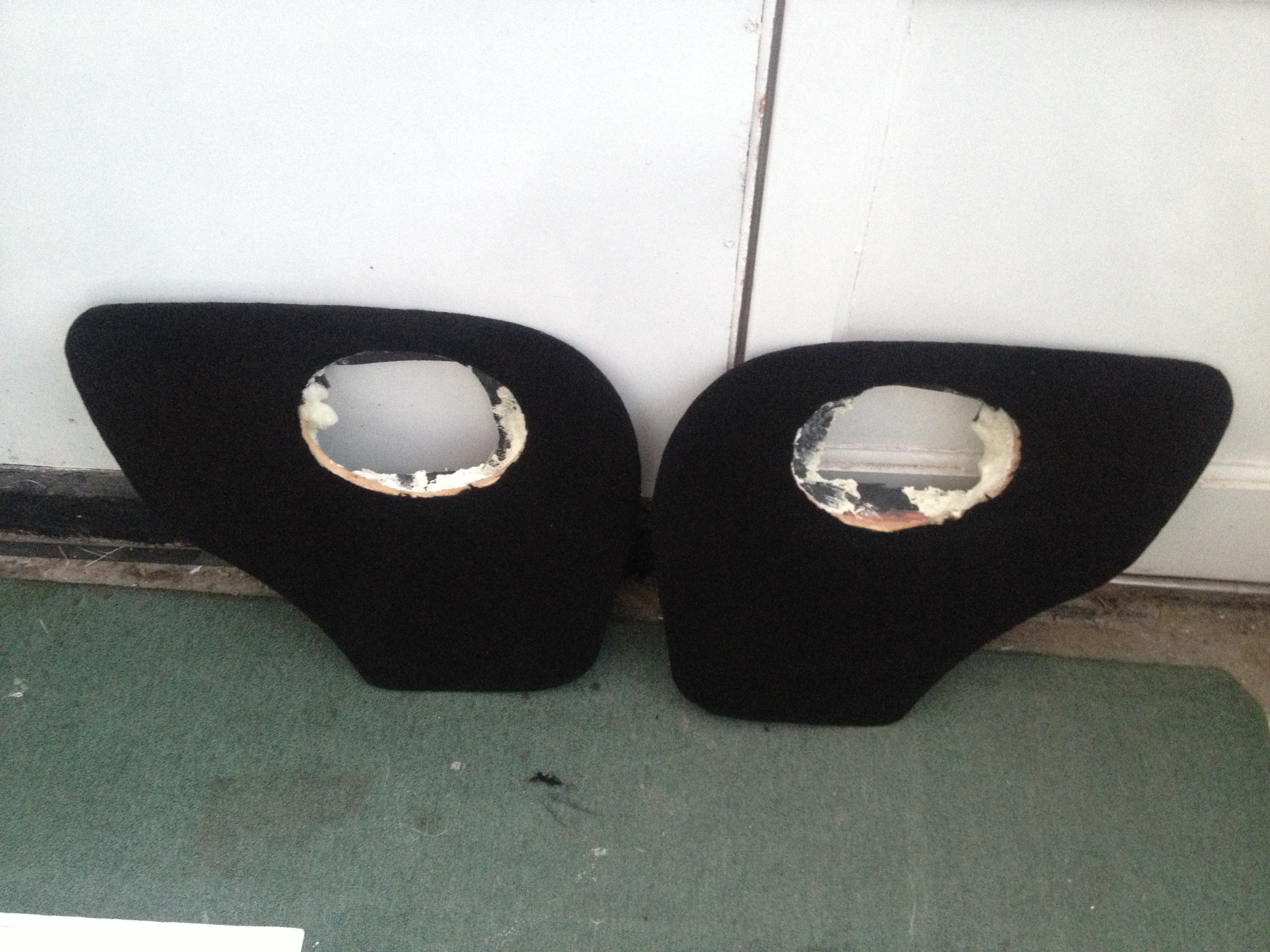

The rear cards...
18mm MDF rings made, and glue gunned to the panels
Panels removed ready to stretch an old T-shirt over & resin
Resin covered panel... Awaiting this to dry so I can start layering a few layers of fibreglass matting.

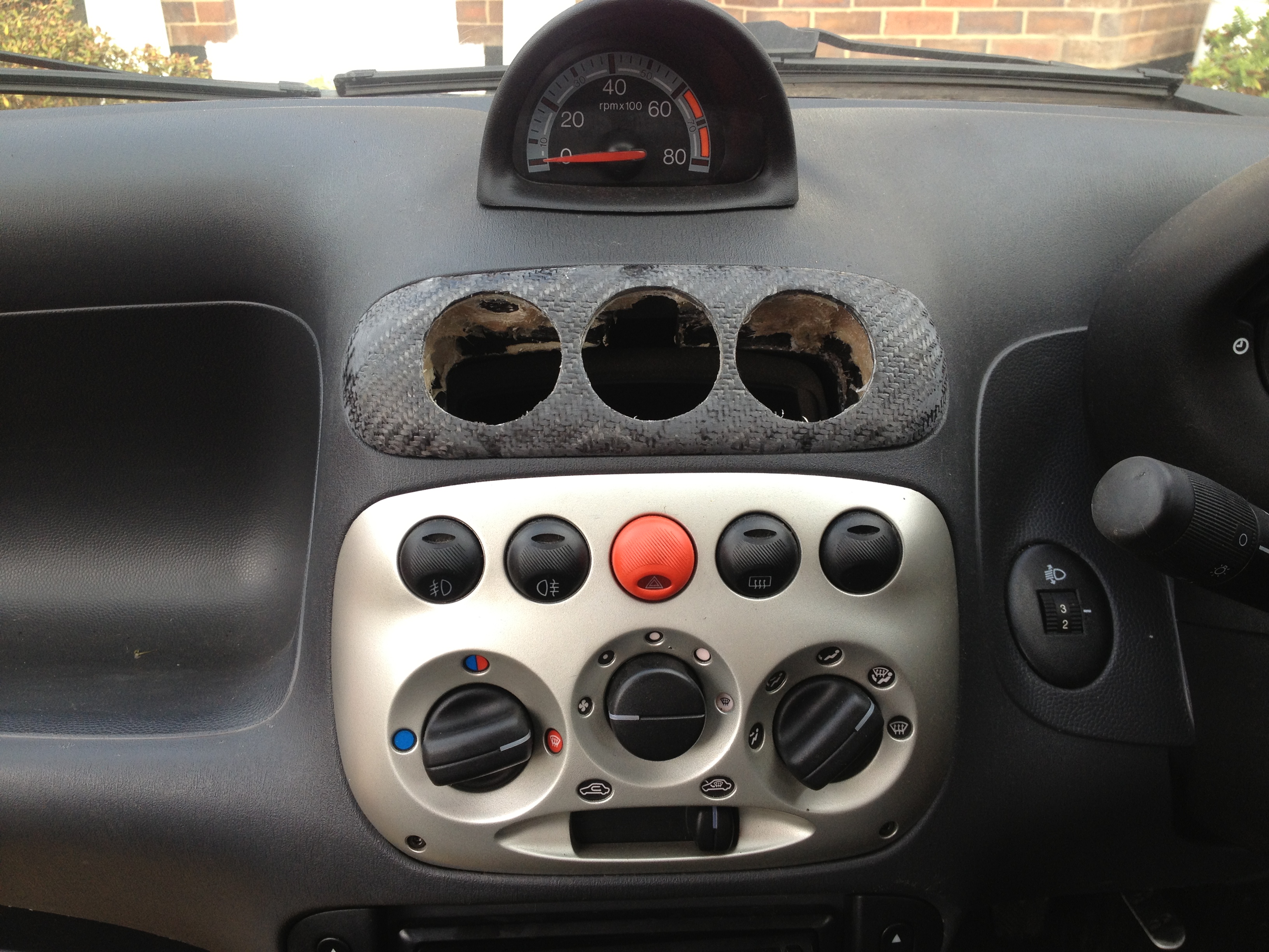

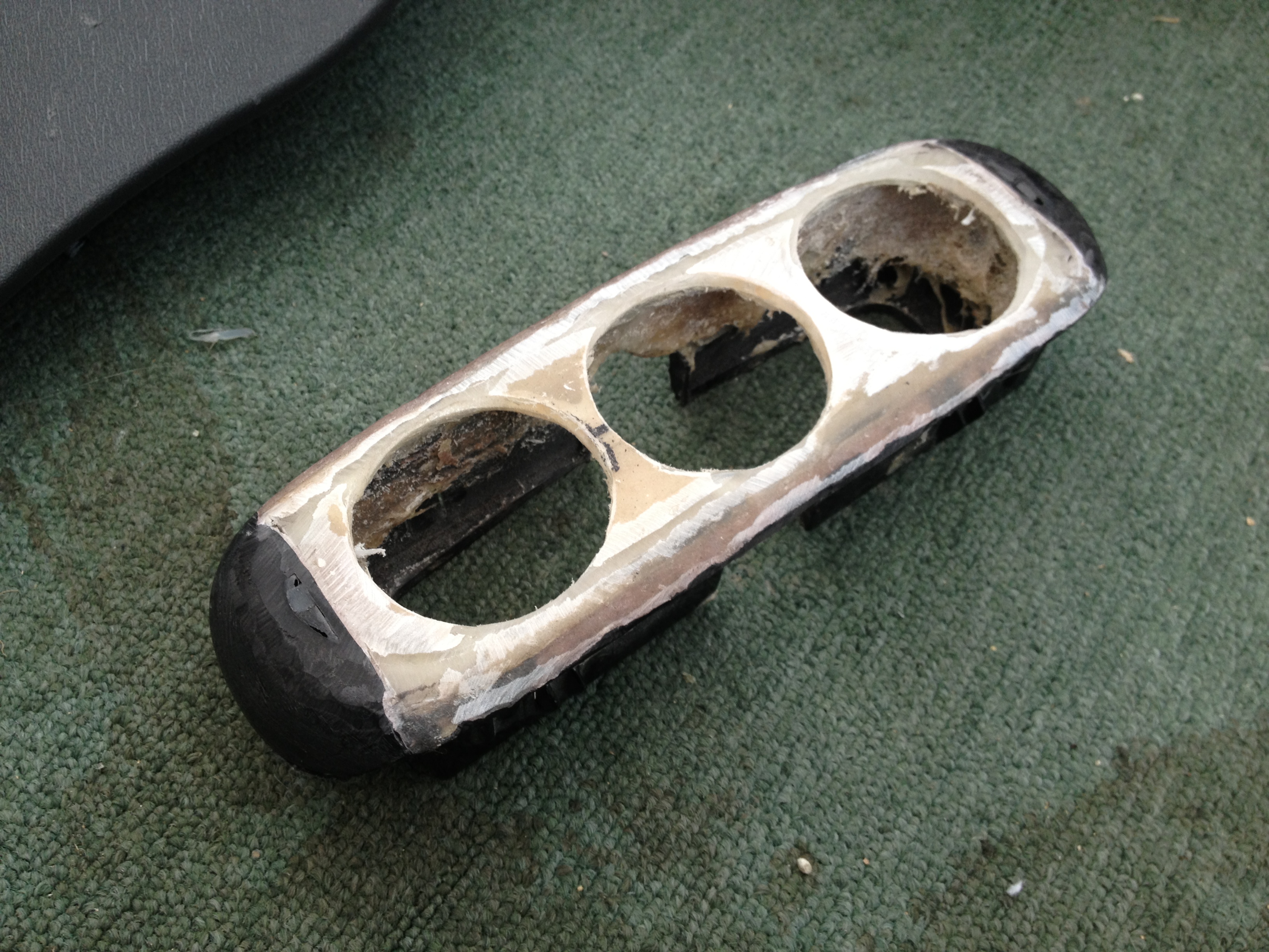

The only other part im doing as some of you may have noticed, is a gauge pod (for where the heater vents are)... Im not 100% sure if im using this just yet... However while I had the resin out I thought it would be silly not to finish off...
Ive attacked it quite a bit with a grinder to remove some of the standard fiat shaping to the plastic (so it doesn't stick as much forward each side)...
A layer of fabric & resin has been added, thus giving me the next option as to whether im skimming in real carbon fibre, or smoothing up for paint... Not entirely sure just yet

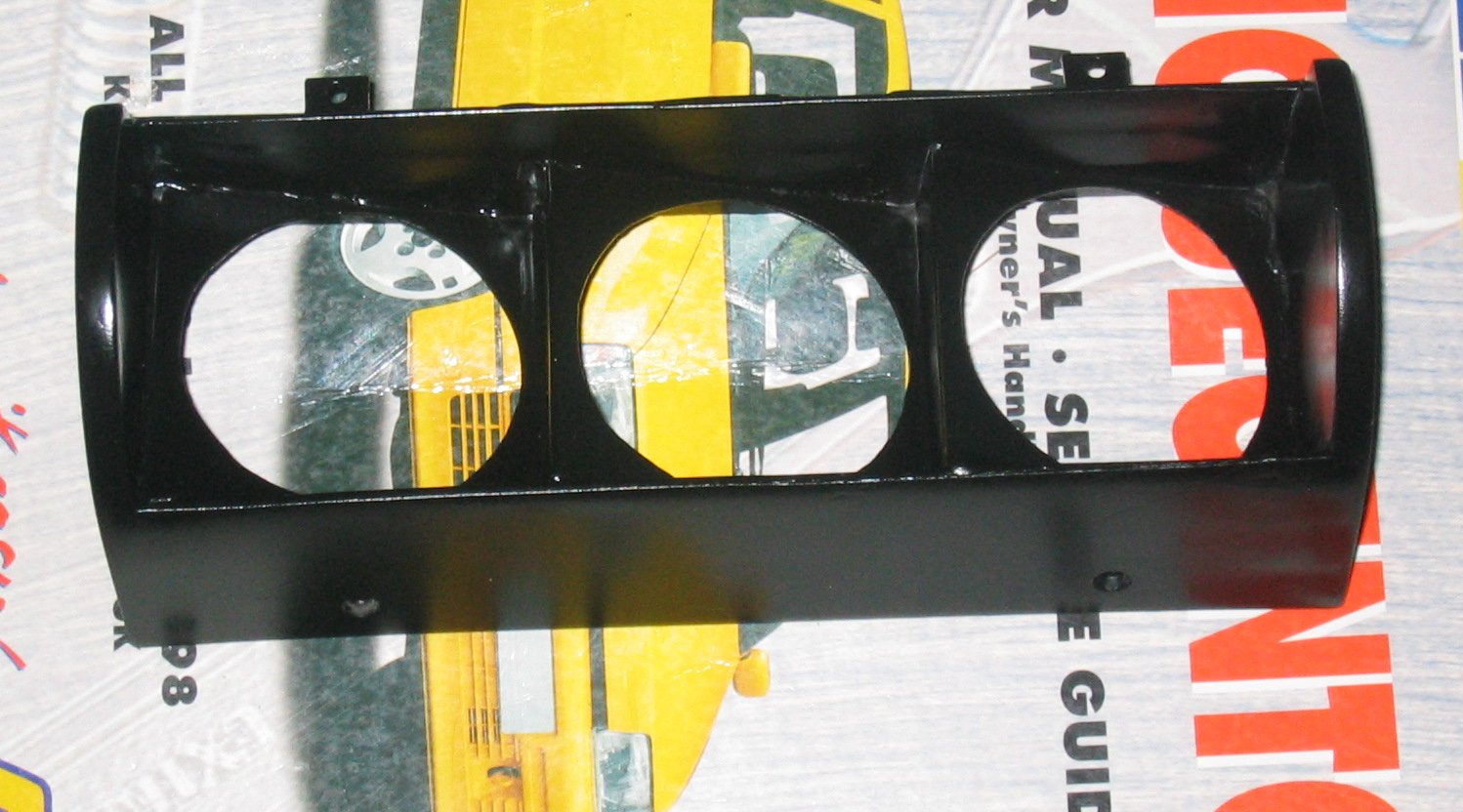

One wot I done earlier, for a Cinq. Needs flocking. One day I'll get a 3D printer -- it was a real SOB to do and isn't quite right.
The wheel was on the drivers side, although it could have originally been on the gearbox side and the last owner swapped it over?
Like that pod you've made, looks quite professional! I have to agree this one is a SOB to make as there's not much plastic to work with once the holes are cut out...

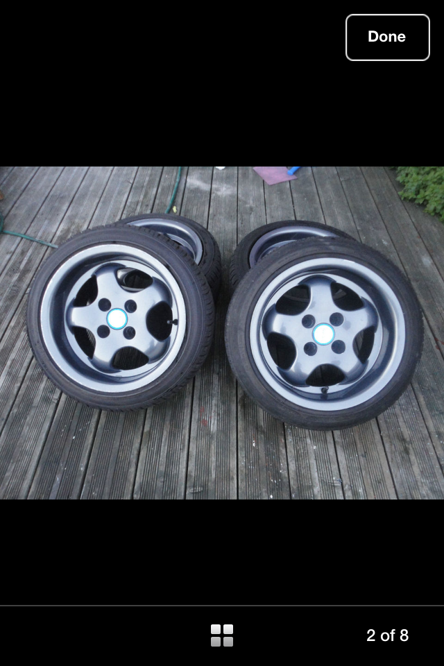

I really should take another look to be honest.... Ive managed to stumble on some cheap 14" alloys that are not abarths... The only problem now is I think I need to pick up a wheel arch roller haha....
Found one on ebay for £76ish, but looking for cheaper as I only need it for two arches!!(although guess I could rent it out and get my money back)
http://www.ebay.co.uk/itm/300956177...&ff3=1&ff11=ICEP3.0.0&ff12=67&ff13=80&ff14=54

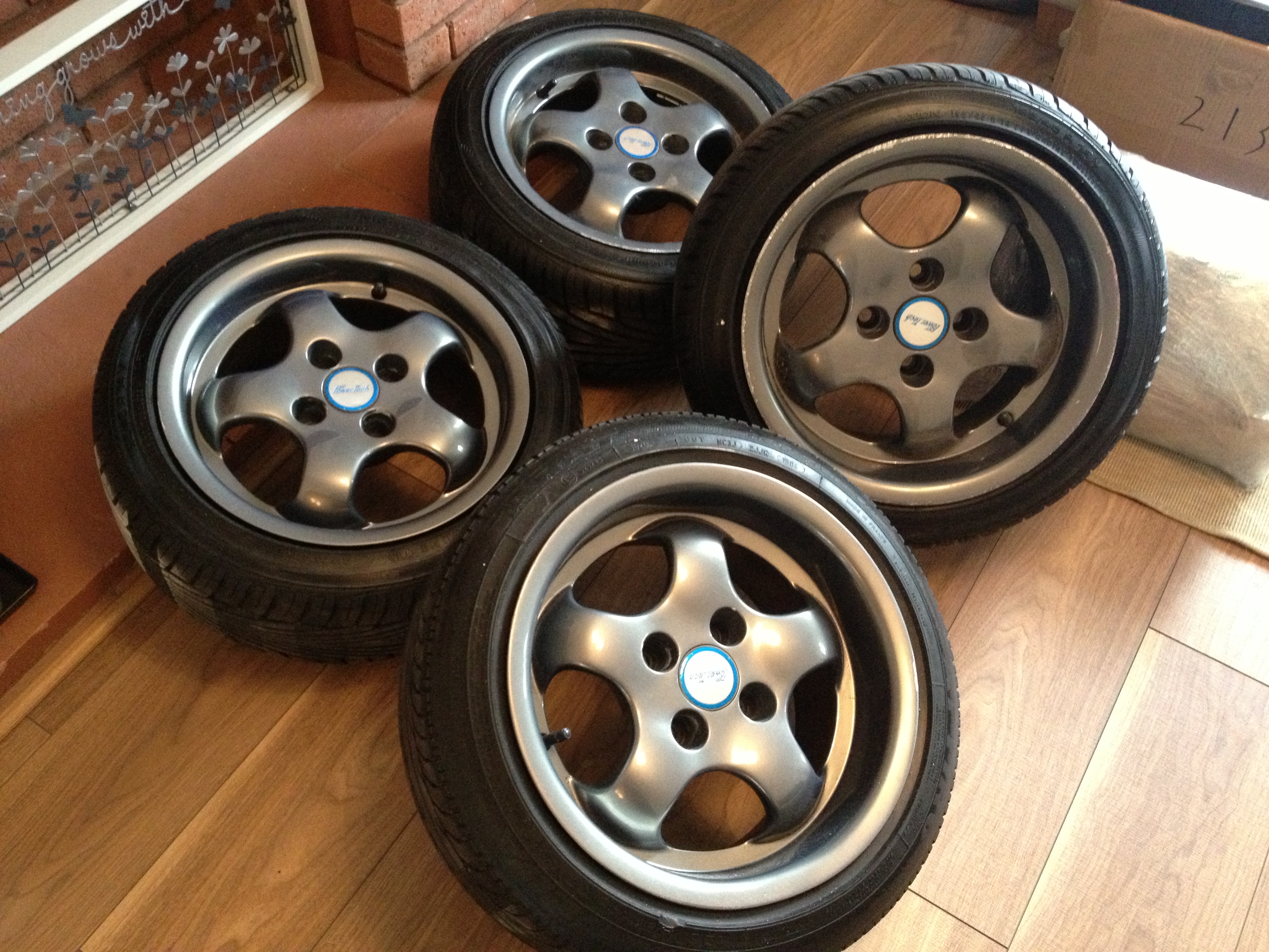

The wheels are a staggered fit, and the lad who's selling them has no idea how to measure as he claims their 8-9" rears, and 7-8" fronts...
However hes spaced the rears out to fit a VW polo, so something's not right lol!
For the money, they were worth a gamble...

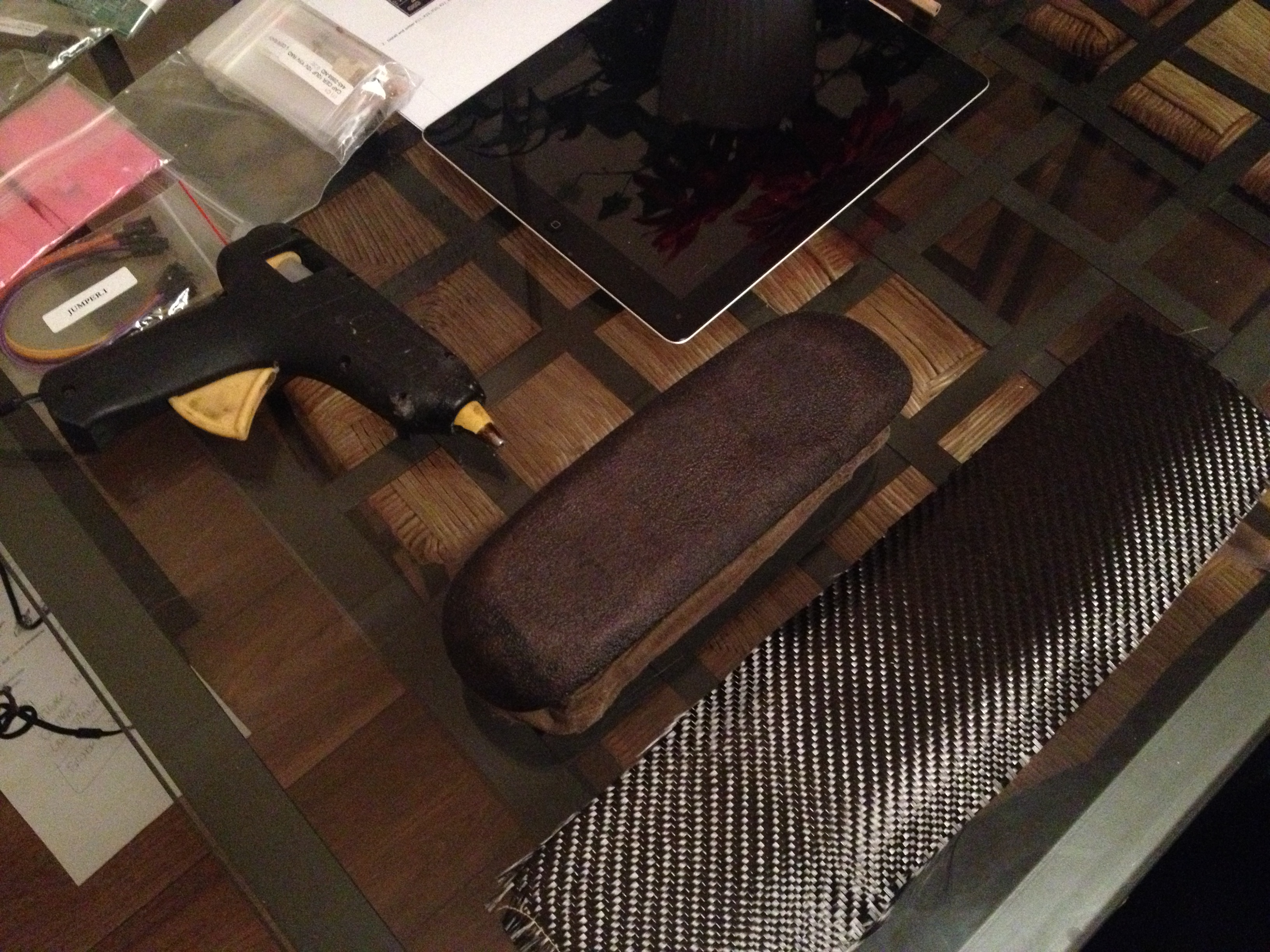

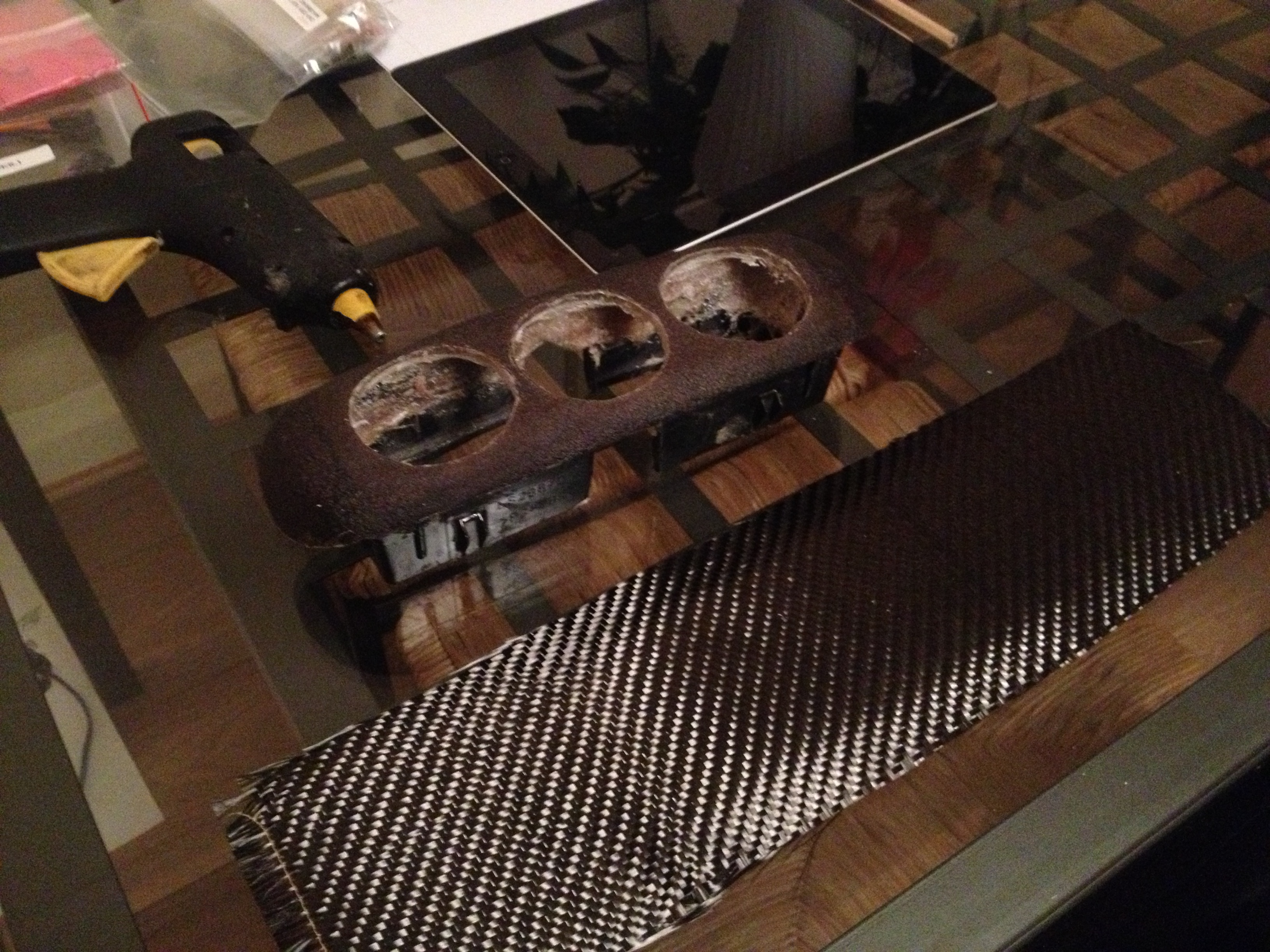

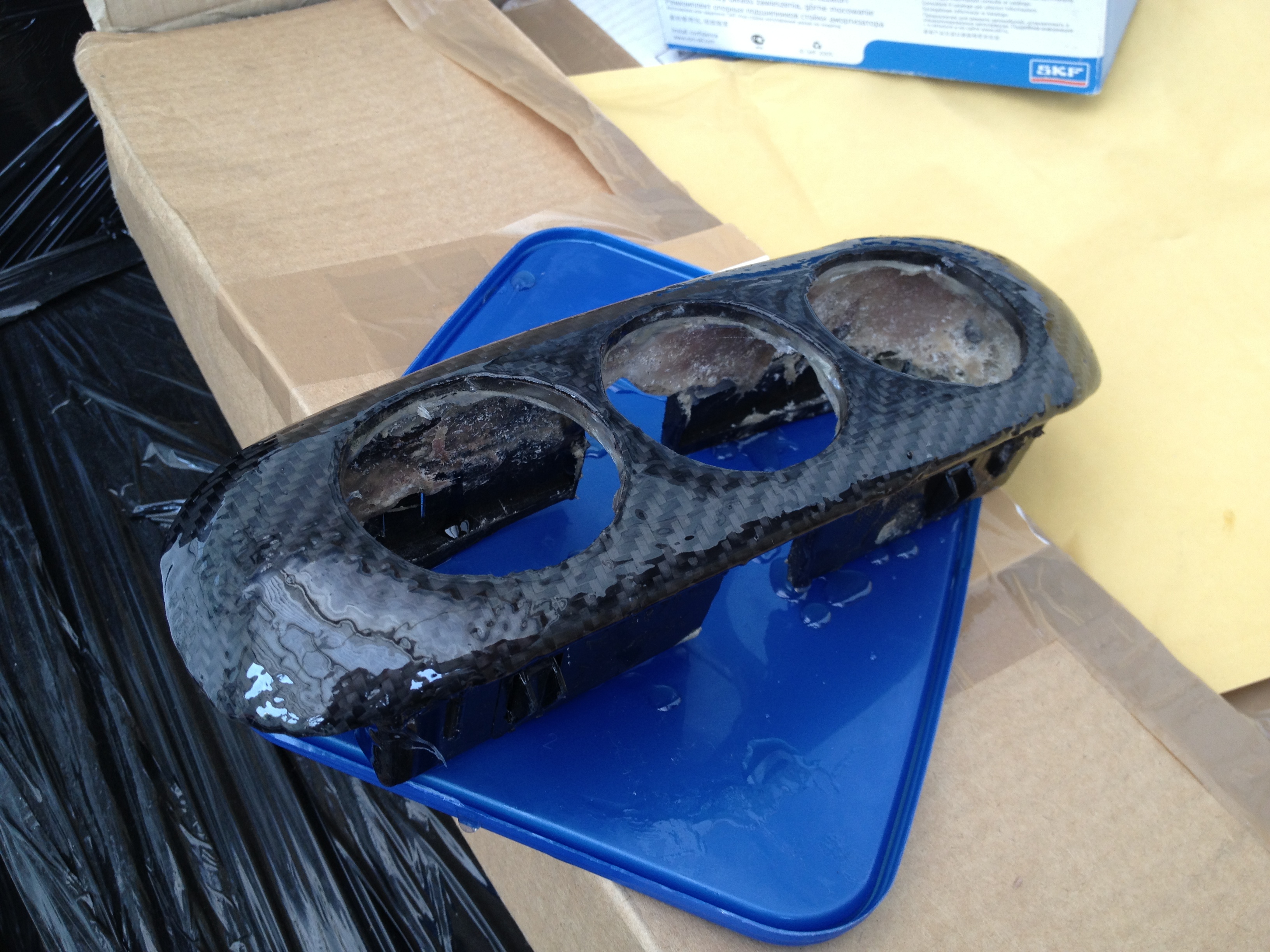

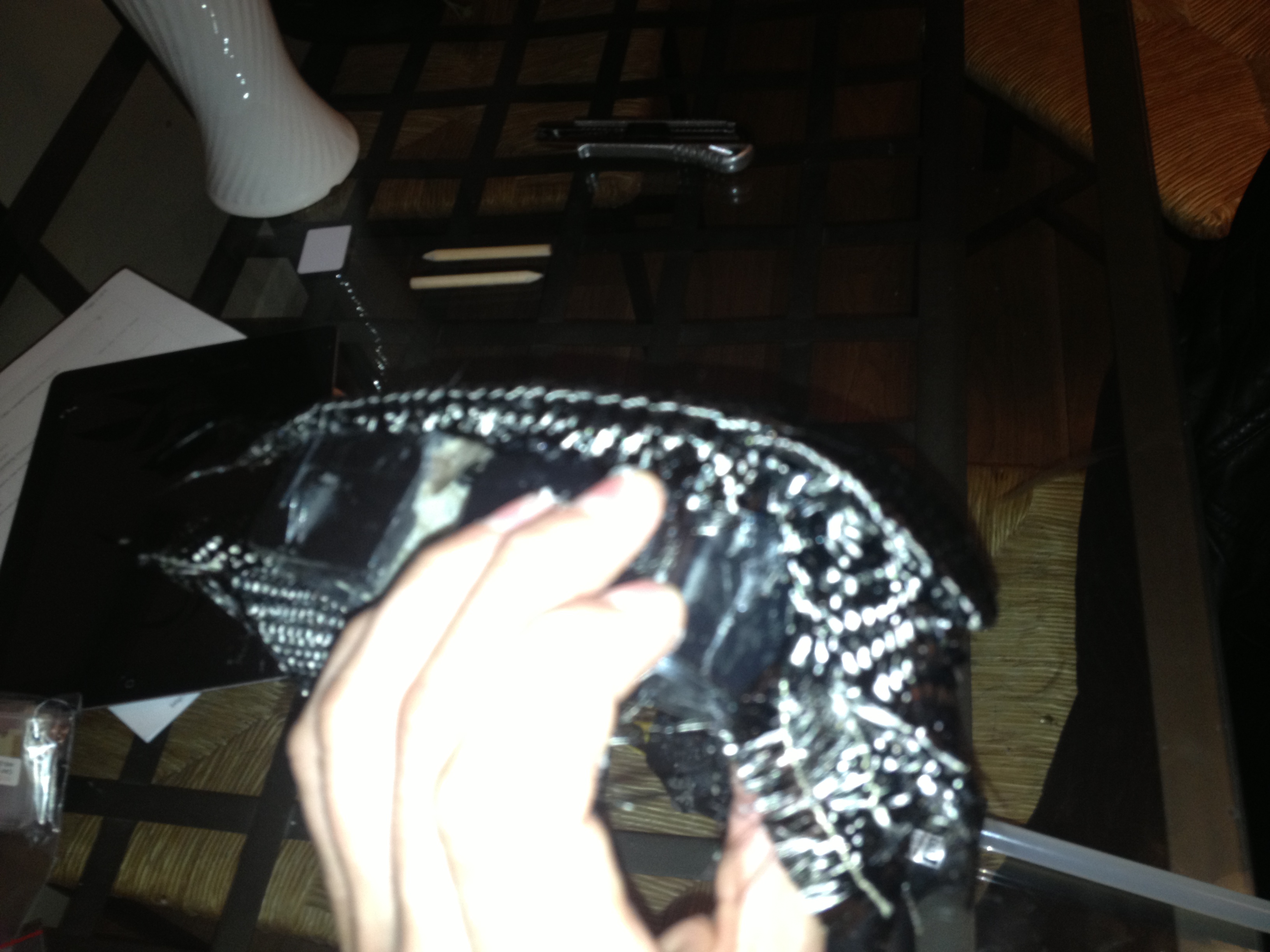

Thought id crack on with carbon wrapping my gauge pod... Just to see how it turns out...
Once the resin on the T-shirt had dried, I had this...
Holes re-cut out....
And on with the carbon... This was glue gunned from the rear (to allow me to stretch the carbon slightly around the curvature)... I normally would have put a layer of resin on 1st and stuck the carbon down, however this stuff is 'carbonmodz' pre impregnated stuff, so I didn't have to :D
I then left it over night ready to tidy up and wet sand today...

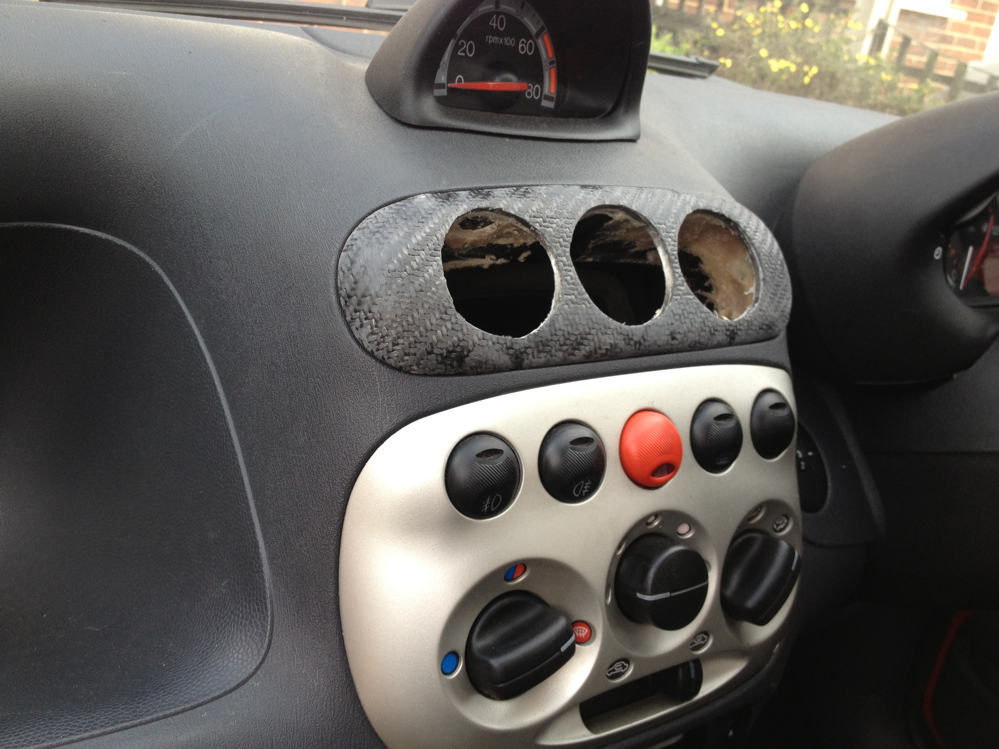

I thought I would give it a trial fit before a second resin coat, to check it still fits haha...
With it fitting nearly perfectly, it was time to give it another thick resin coat... This will be left until tomorrow to cure before I fully wet sand to a smooth finish.. Il then be leaving it a week to vent any vapour before clear coating and deciding whether or not im actually going to use it lol.
After the trial fit, im thinking I should spray the silver heater facia a gloss black (have some ford panther black somewhere)....
I do have an abarth fake carbon fibre printed one in the yellow seicento, however it will look really bad next to real carbon fibre haha

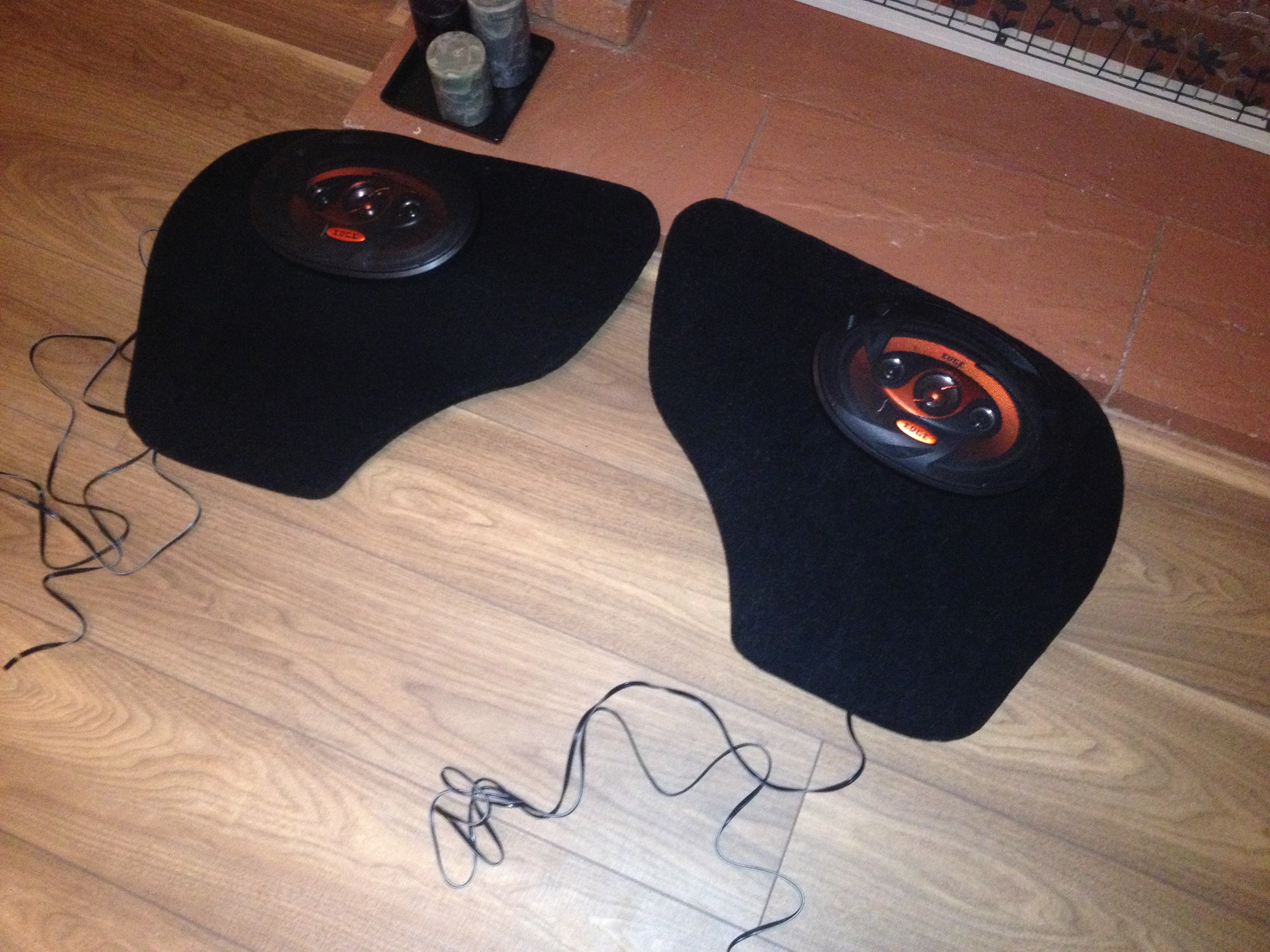

Boom... rear cards sorted...
Fibre glassed, glued, screwed & expanding foamed... Then trimmed... Result
Will get a pic in the morning once I've got around to throwing them in the car...

Well... Pics as promised, although nothing exciting...
Rear builds...
Fitted..

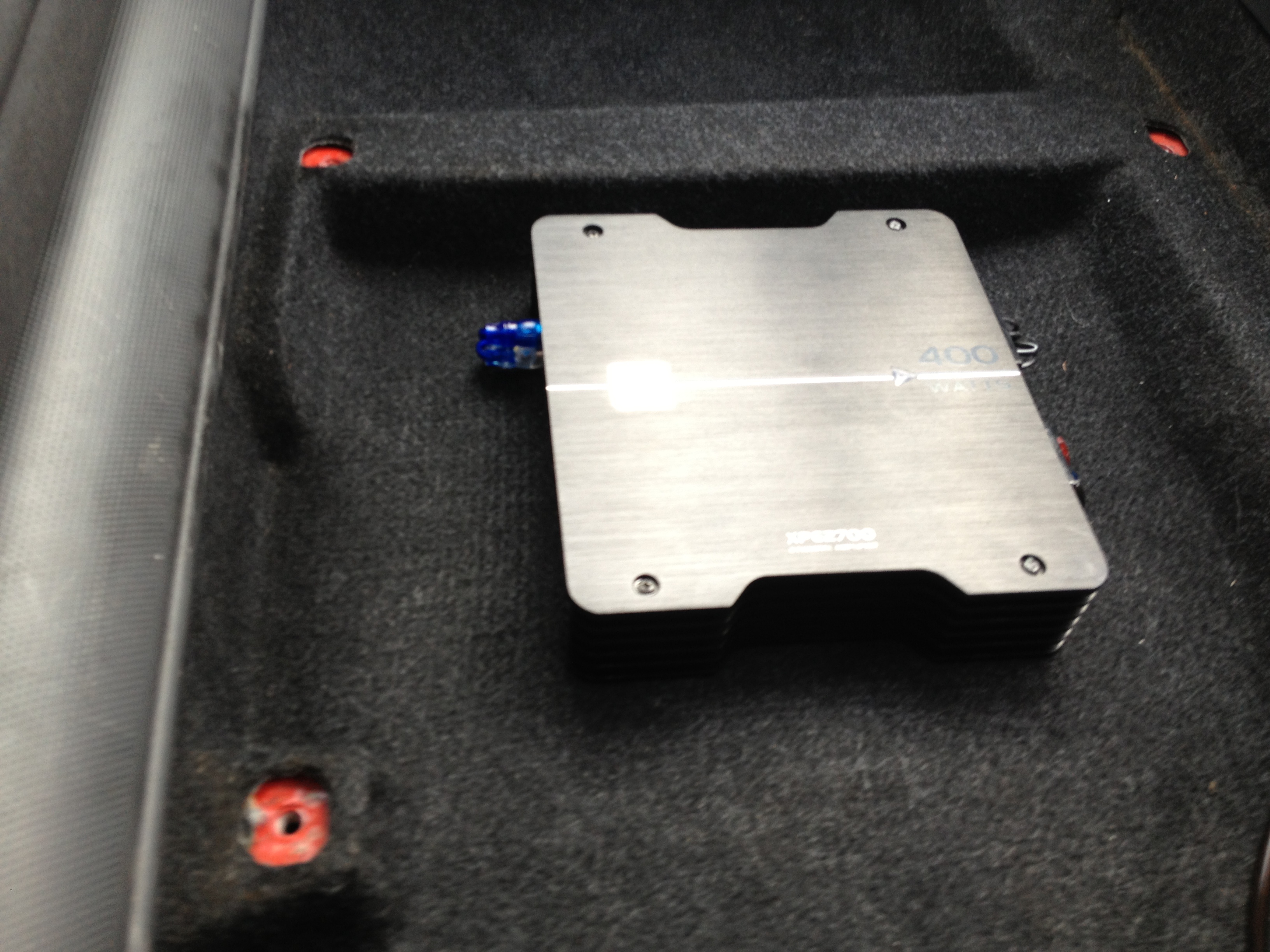

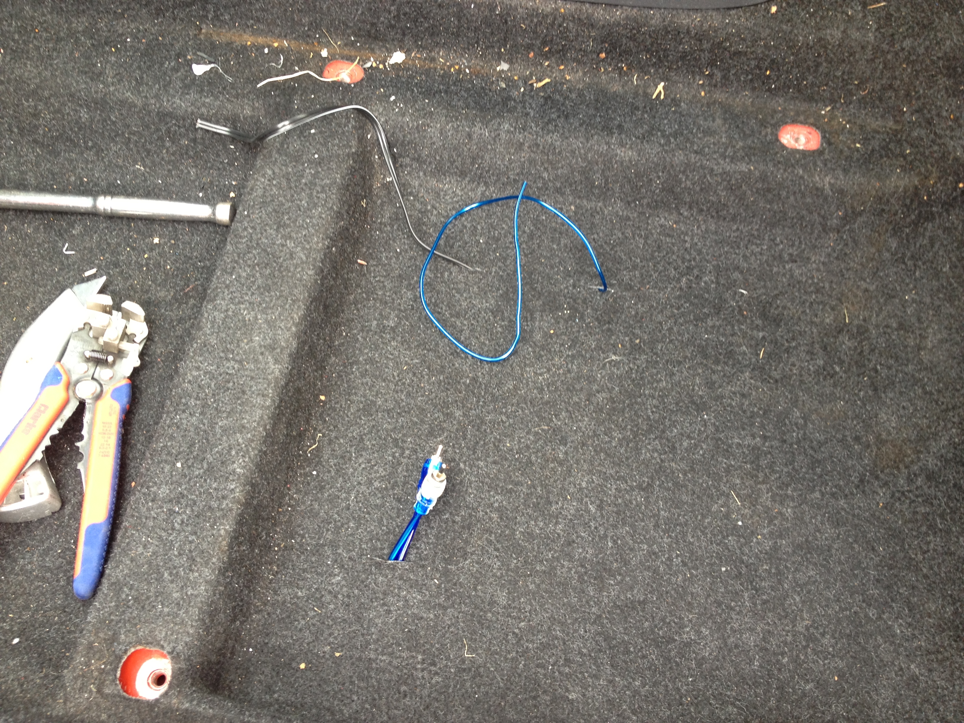

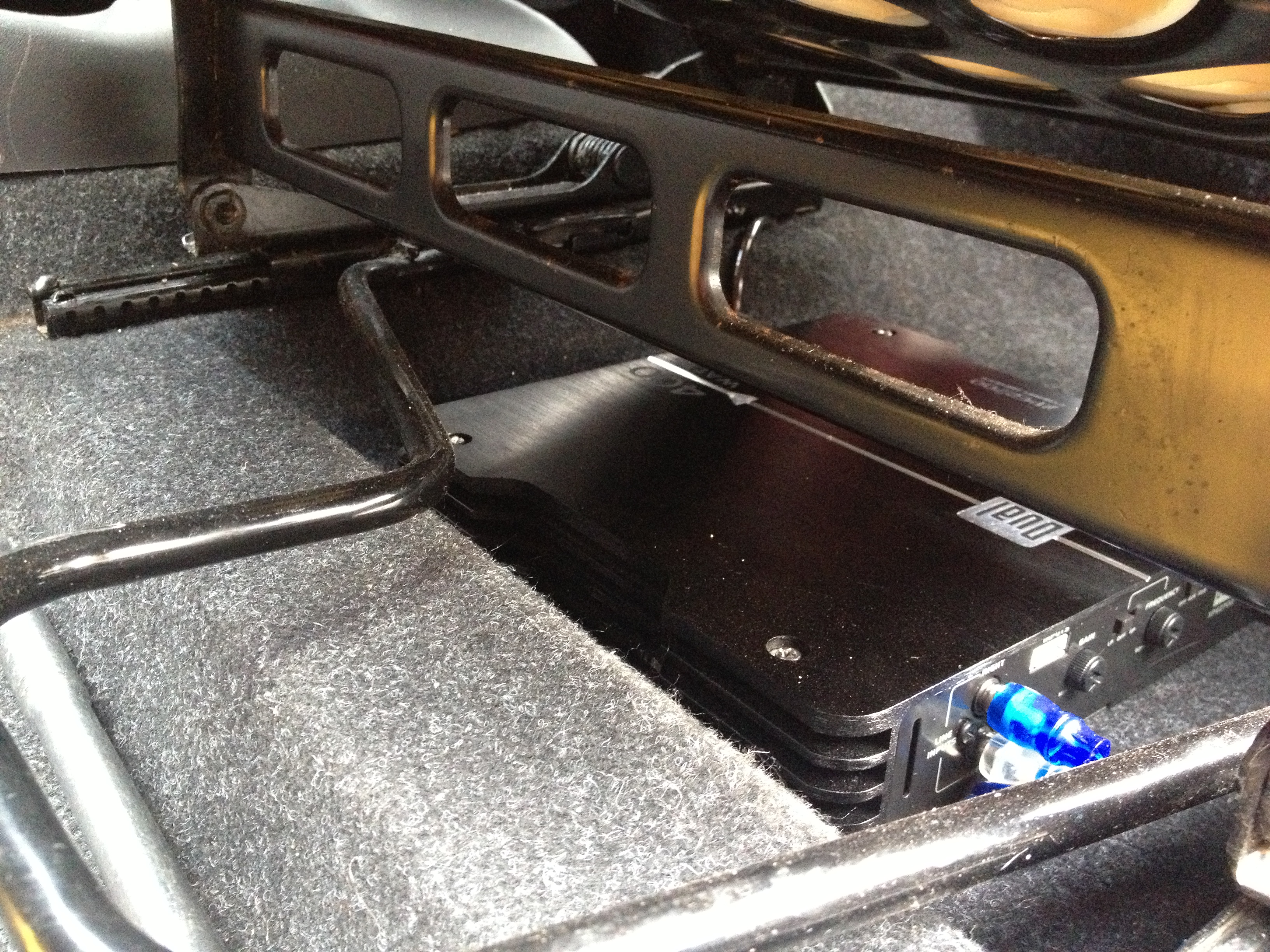

Amp install.. Under the seat out the way... Started with some 18mm ply under the carpet..
Slits cut into the carpet to pass the wires... (keeps it all tidy..)
Installed & screwed down tight... (also taken the time to hoover the carpet)
Tucked neatly under the seat... Plenty of clearance

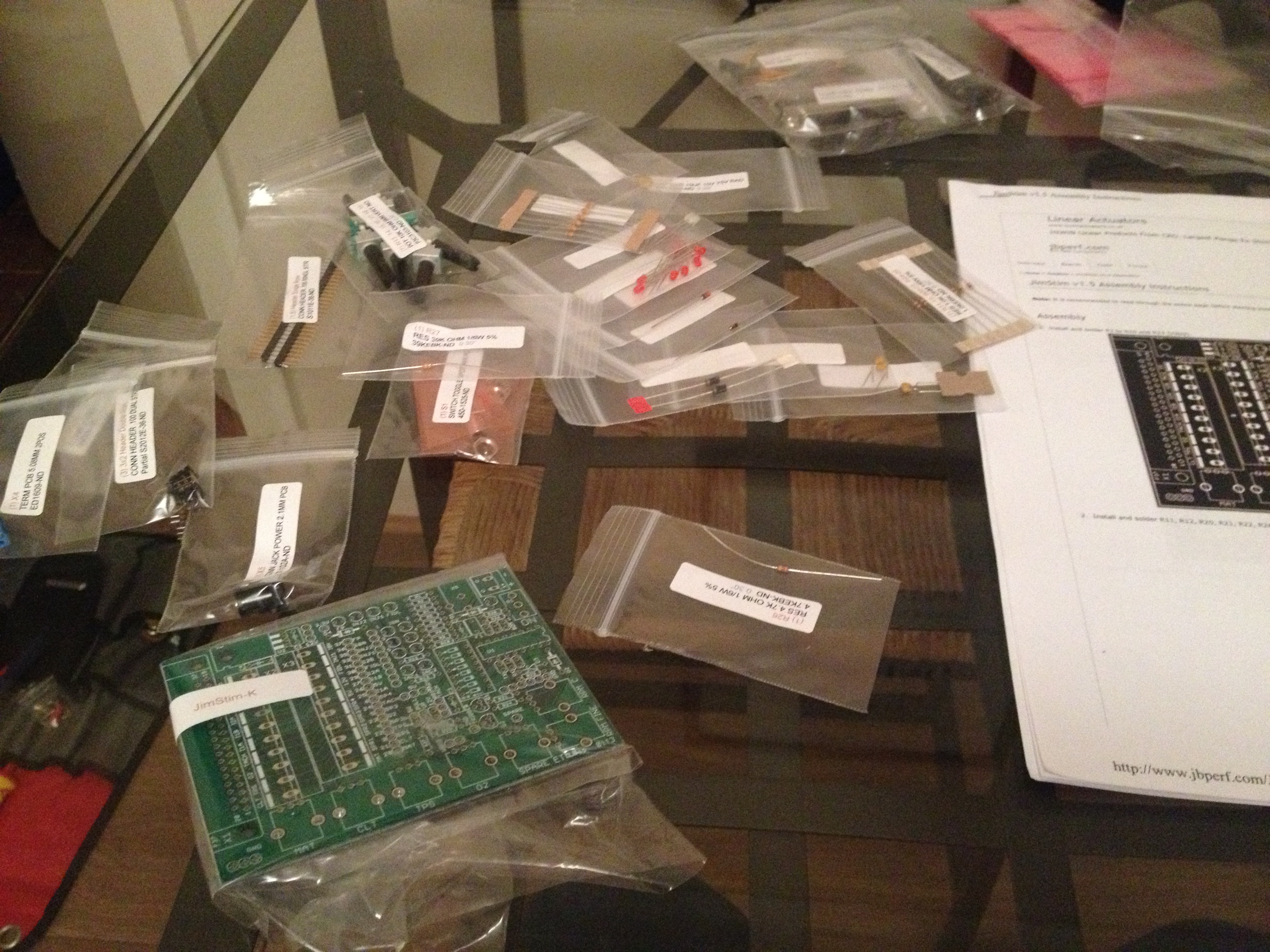

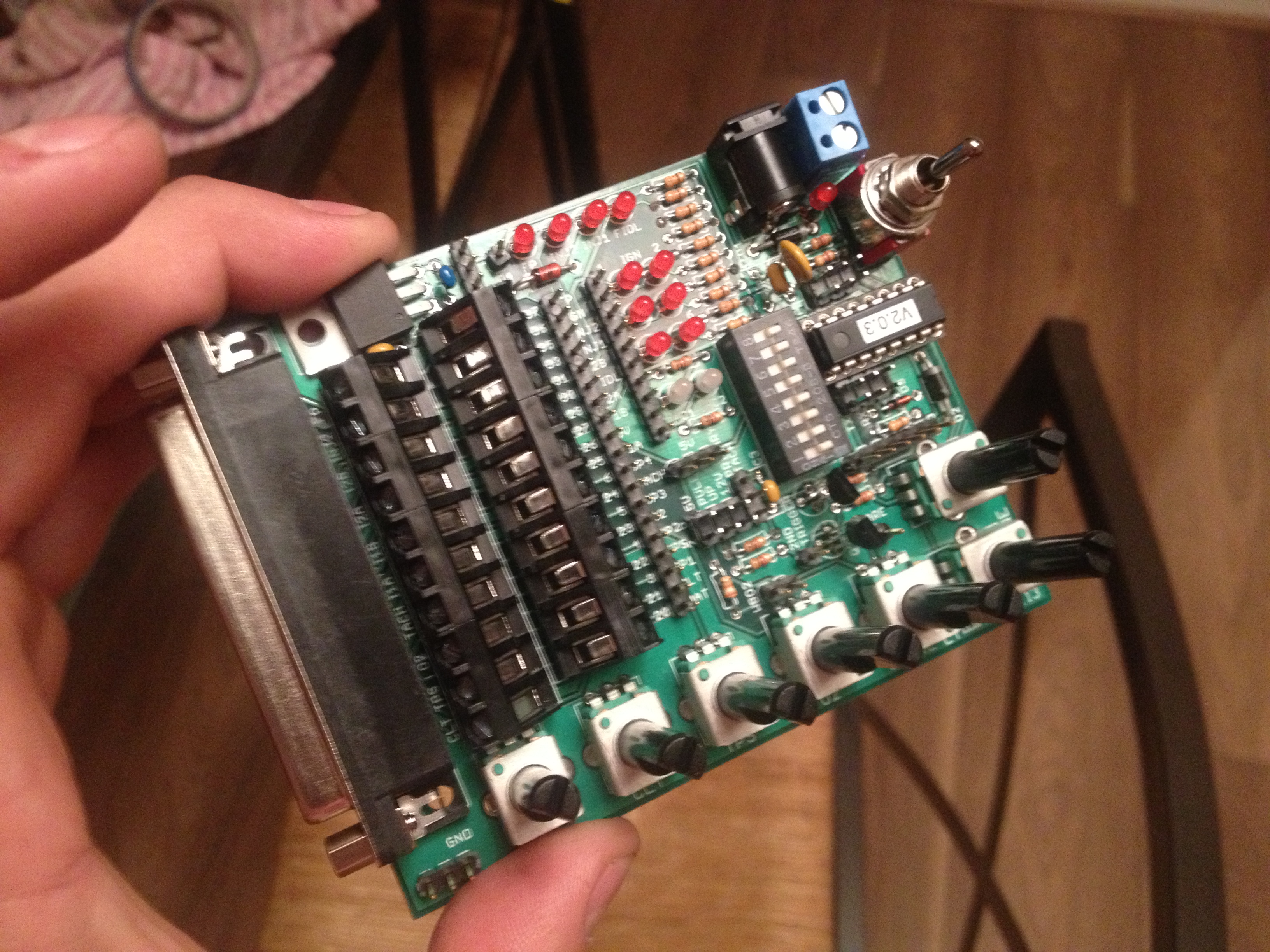

I then got busy building my jimstim....
It went from this...
To this...

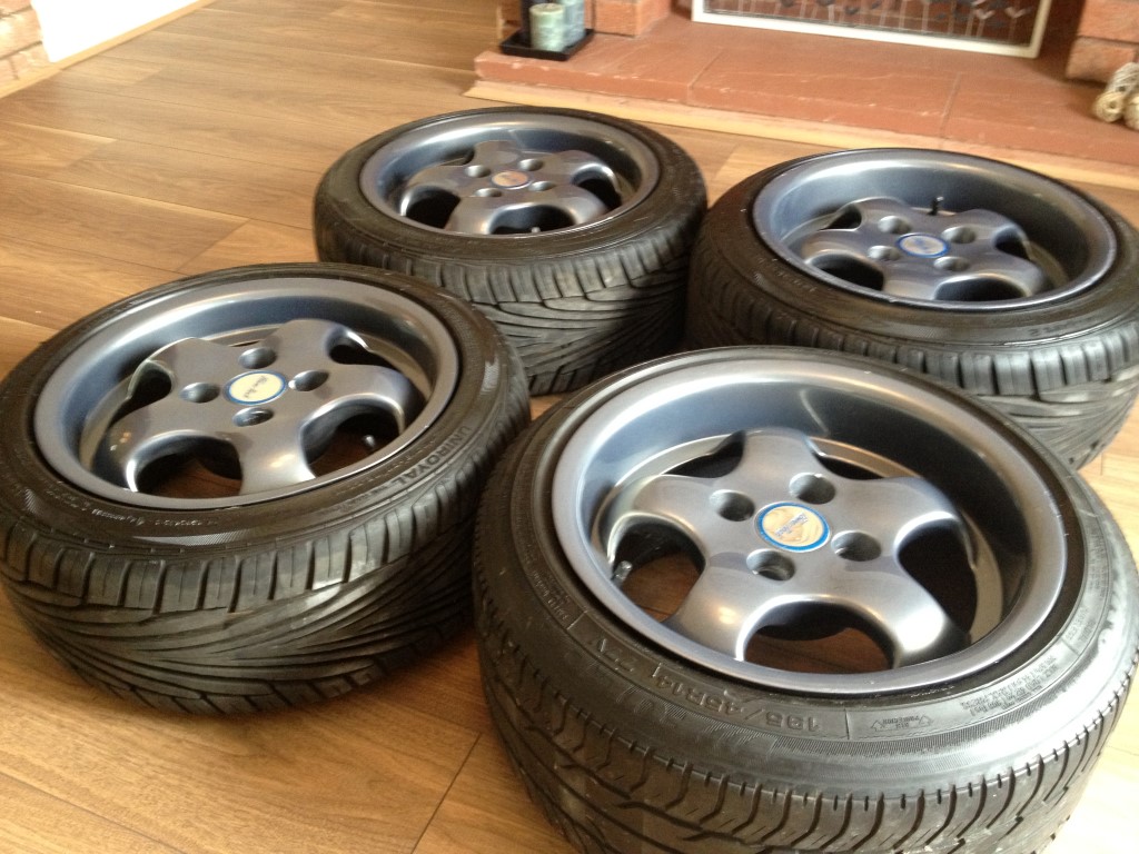

And then finally these arrived...
To reveal these...

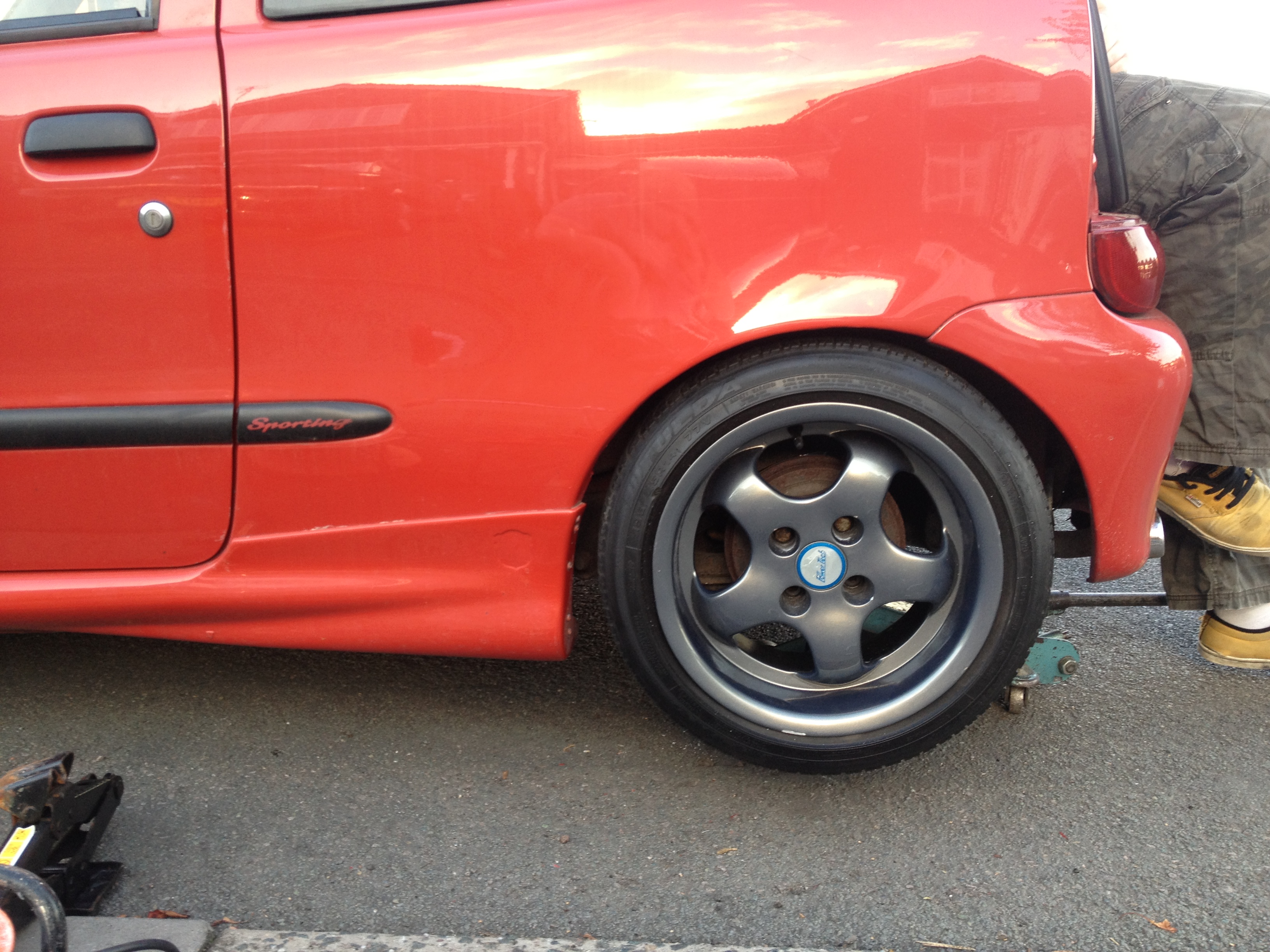

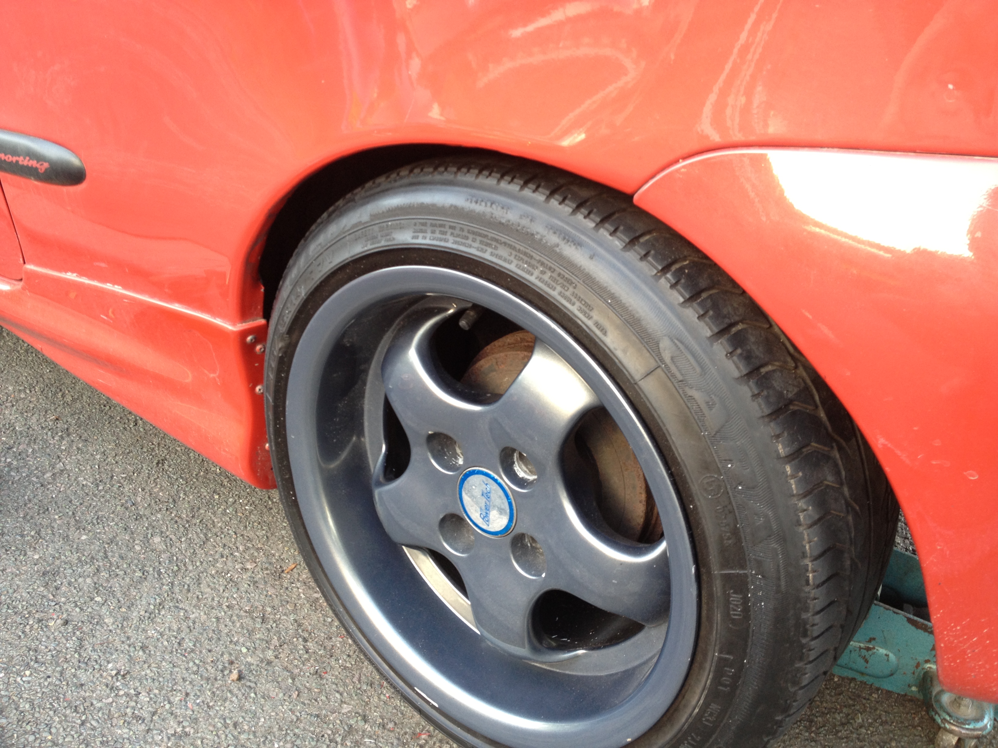

The rears are 8j... and im awaiting an arch roller to attack the seicento :p Fingers crossed it should be here tomorrow....
Il get my heatgun and a coffee ready!!

Nice wheels, though. Are you going to do the reverse stagger to get better front grip/reduce understeer?
Ohh I haven't got a PM, only from chris and something to do with a fiat event coming up...
The reverse stagger would be a good idea, and probably a sensible option, however im more a looks over practicality idiot, so their going on the rear haha! Although after the test fit today, I think I would have serious steering issues with them on the front, as their a bugger on the rear!

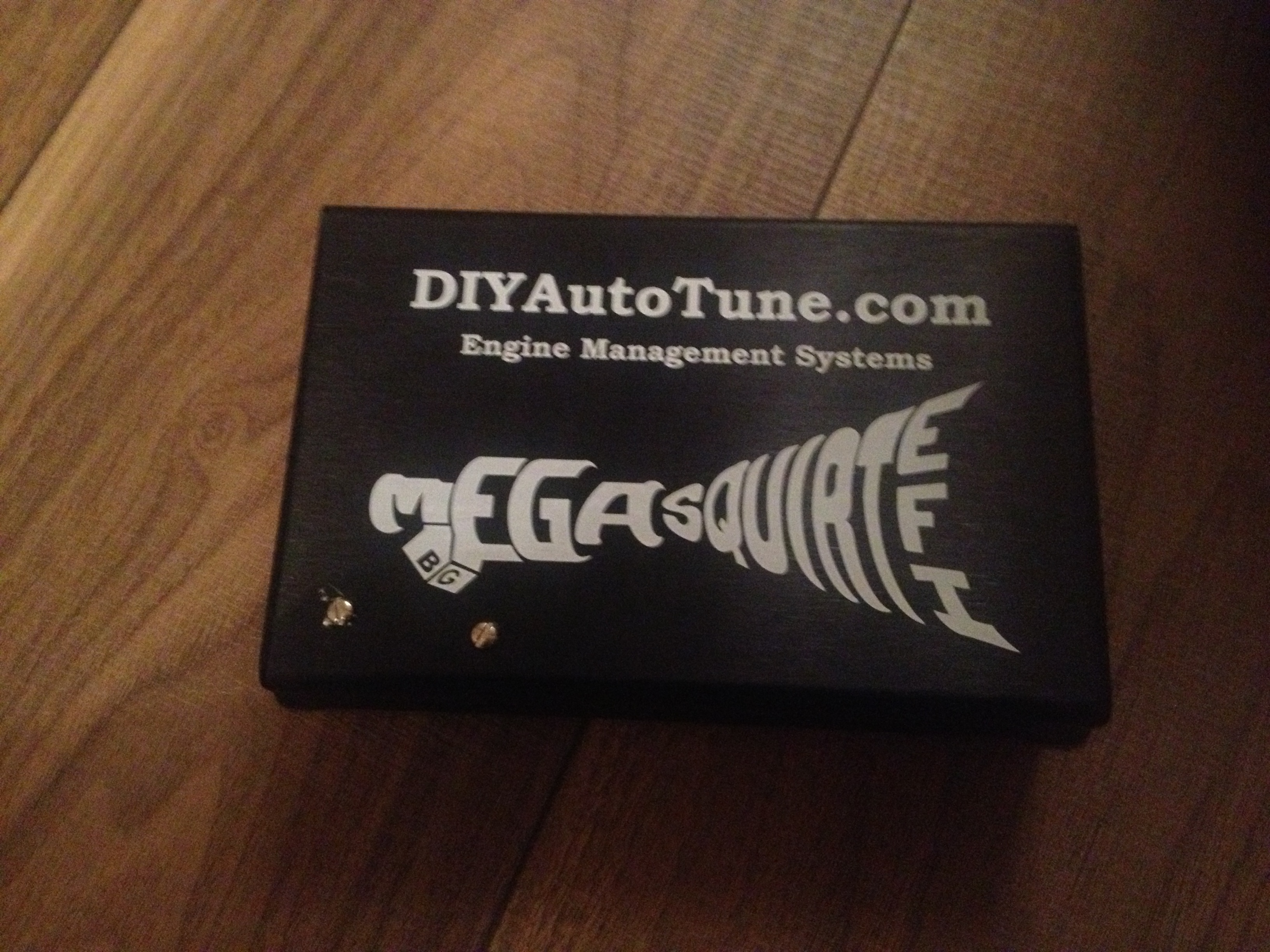

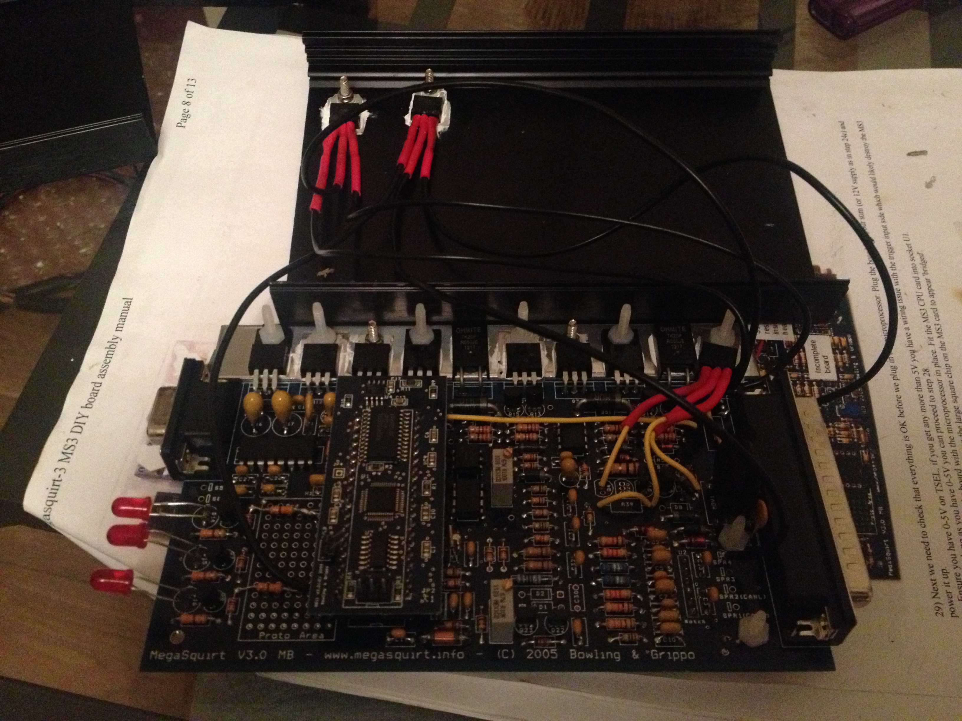

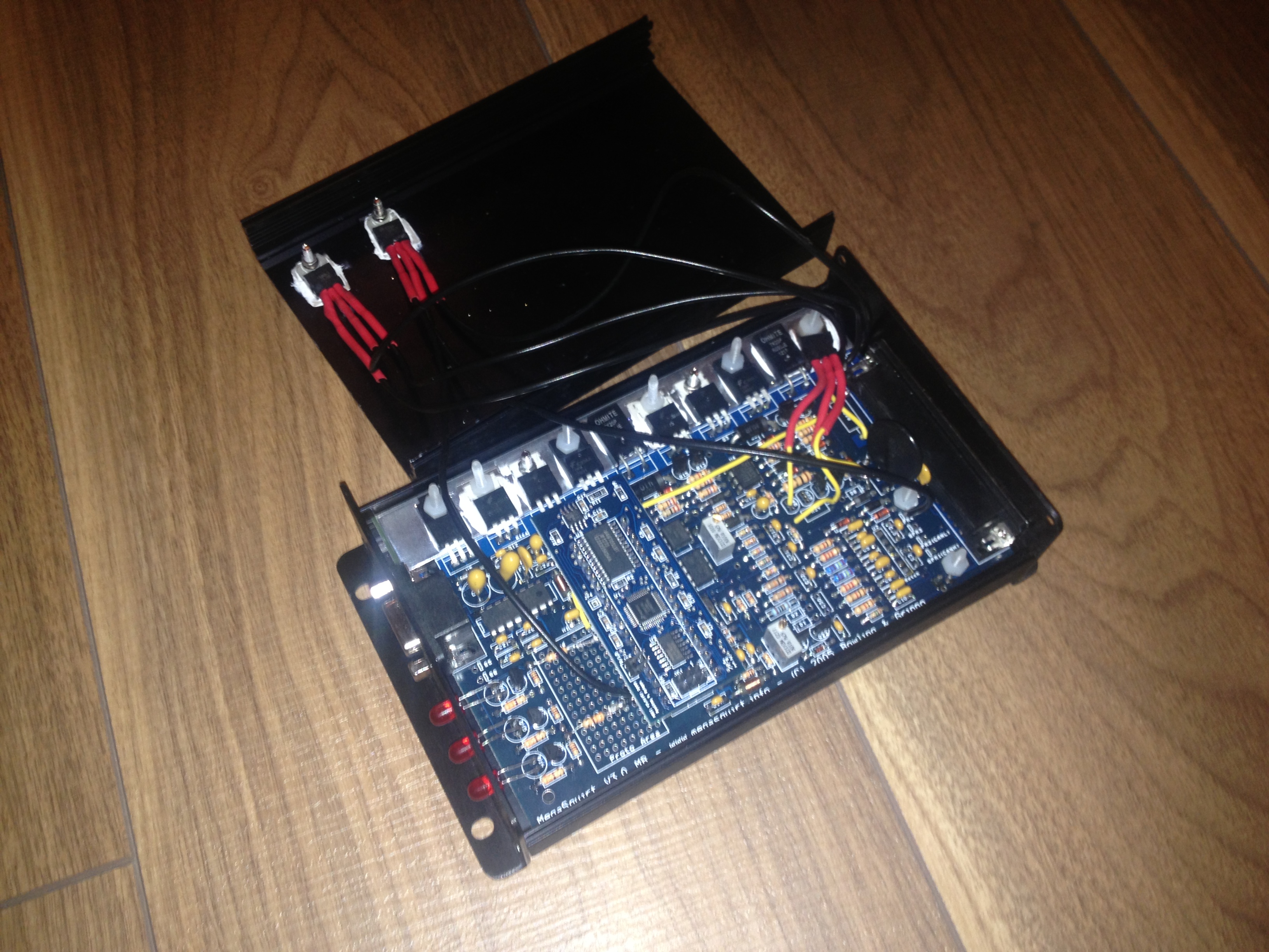

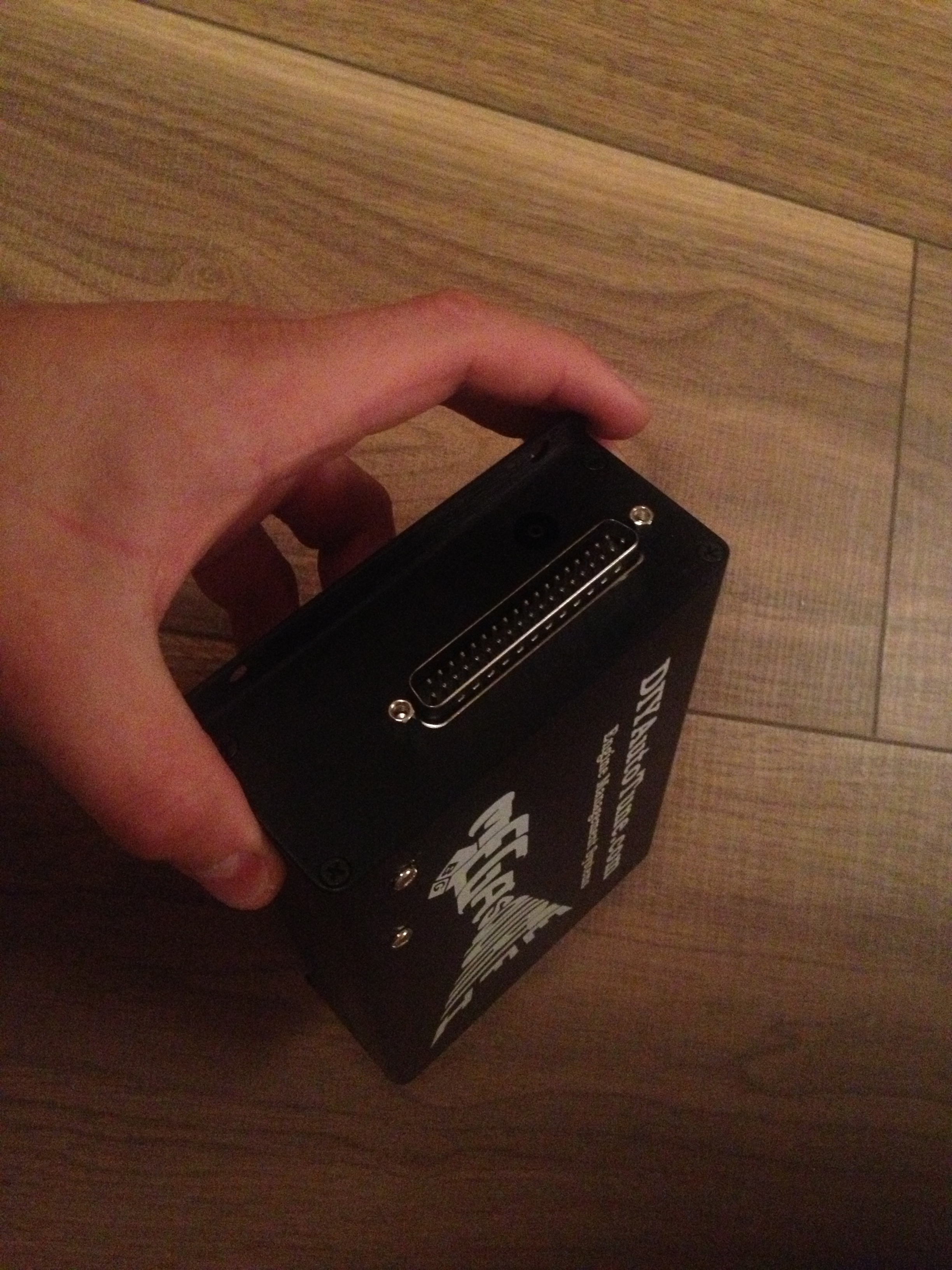

Well, looks as if my megasquirt is finally completed...
I haven't fitted any extras other than a PWM Idle control valve (so I can run a Vauxhall ICV rather than the rare as hell uno turbo one) and then installed two BIP373 ignition drivers for me to run my coil directly, rather than use a ford edis set up.
I basically want to get the engine up and running reliably, before deciding whether to add any extras like launch control, anti lag etc...

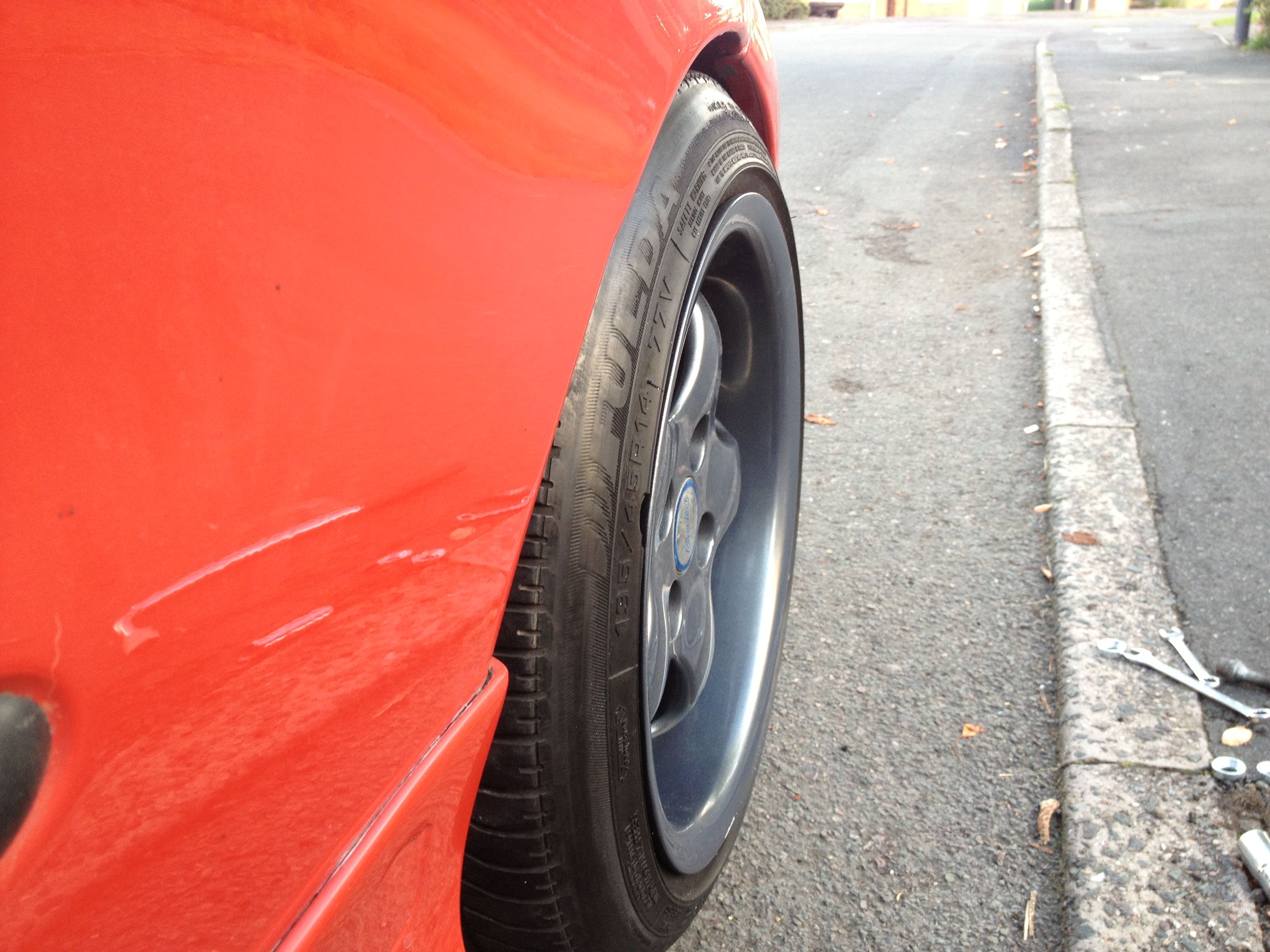

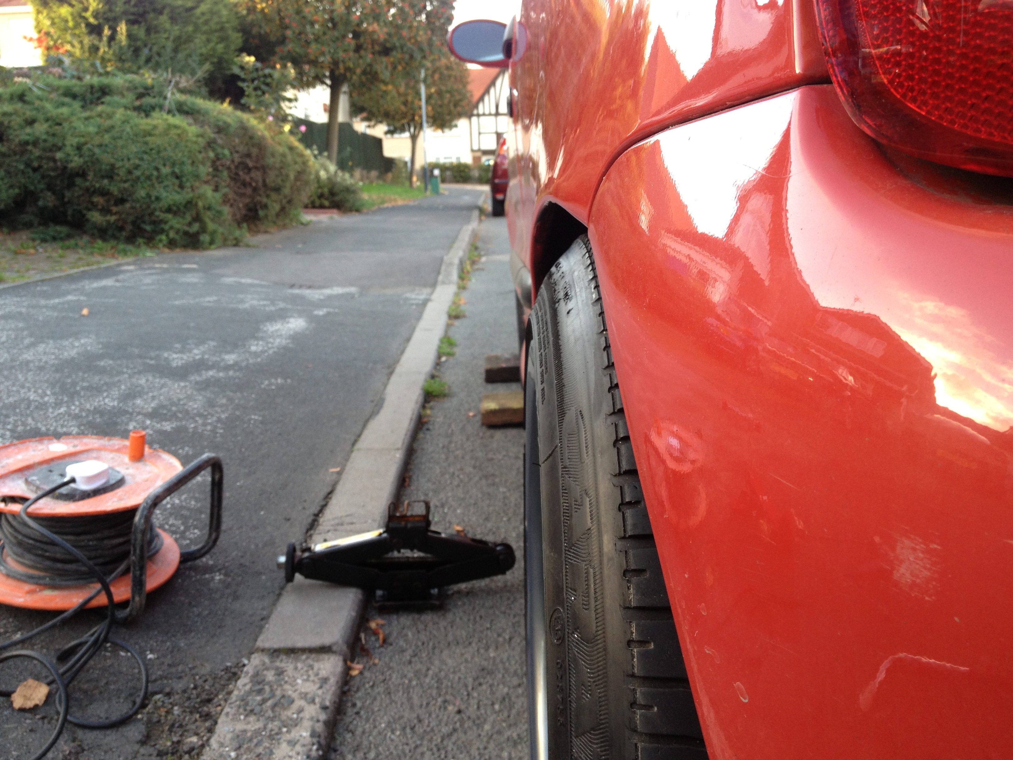

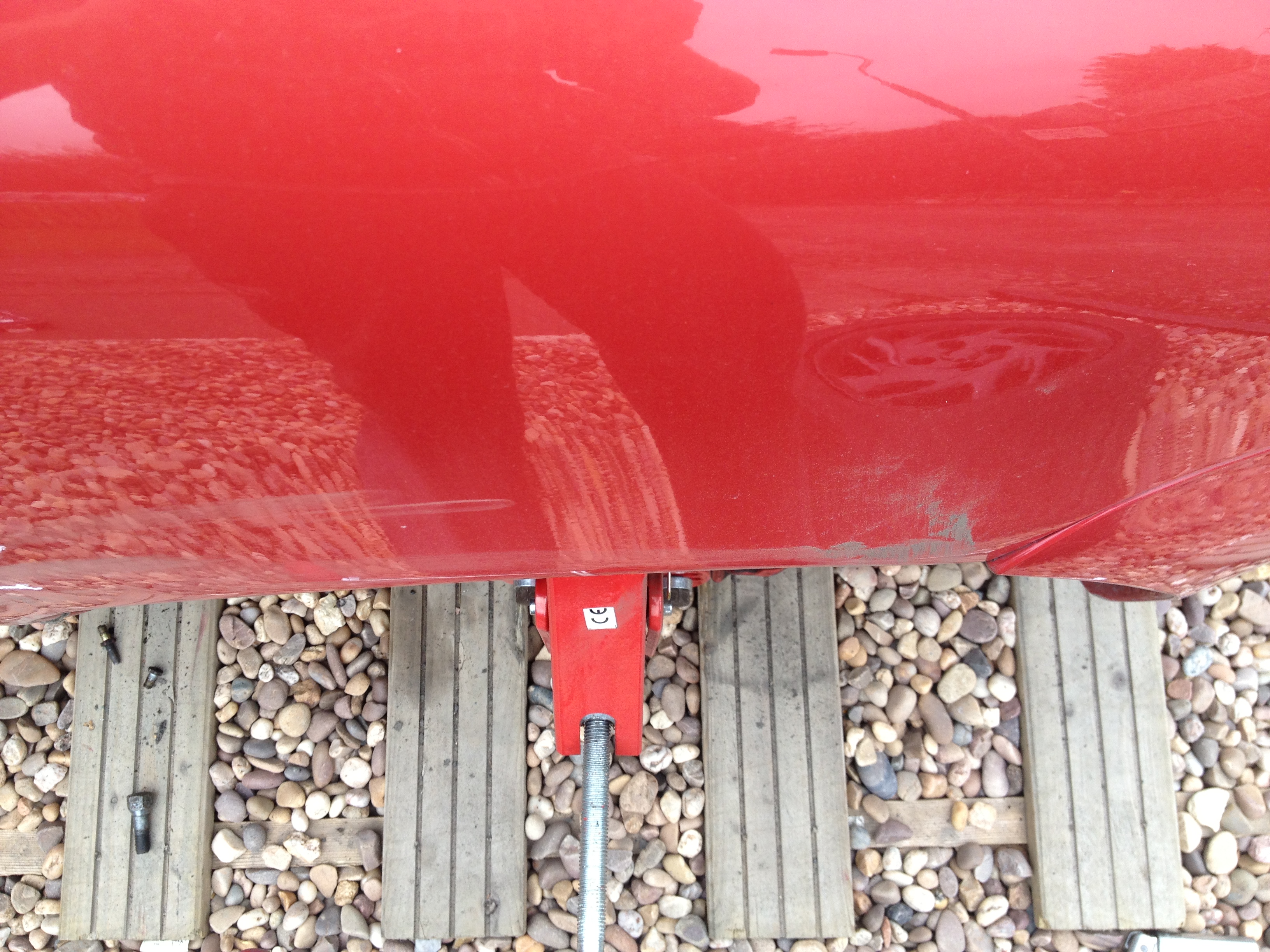

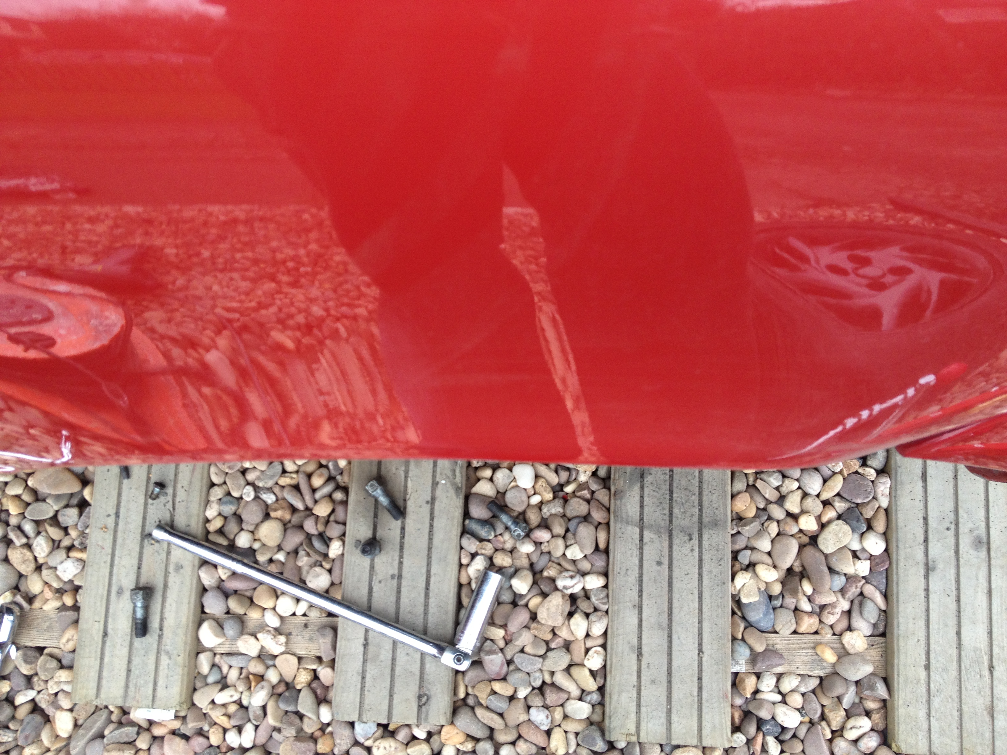

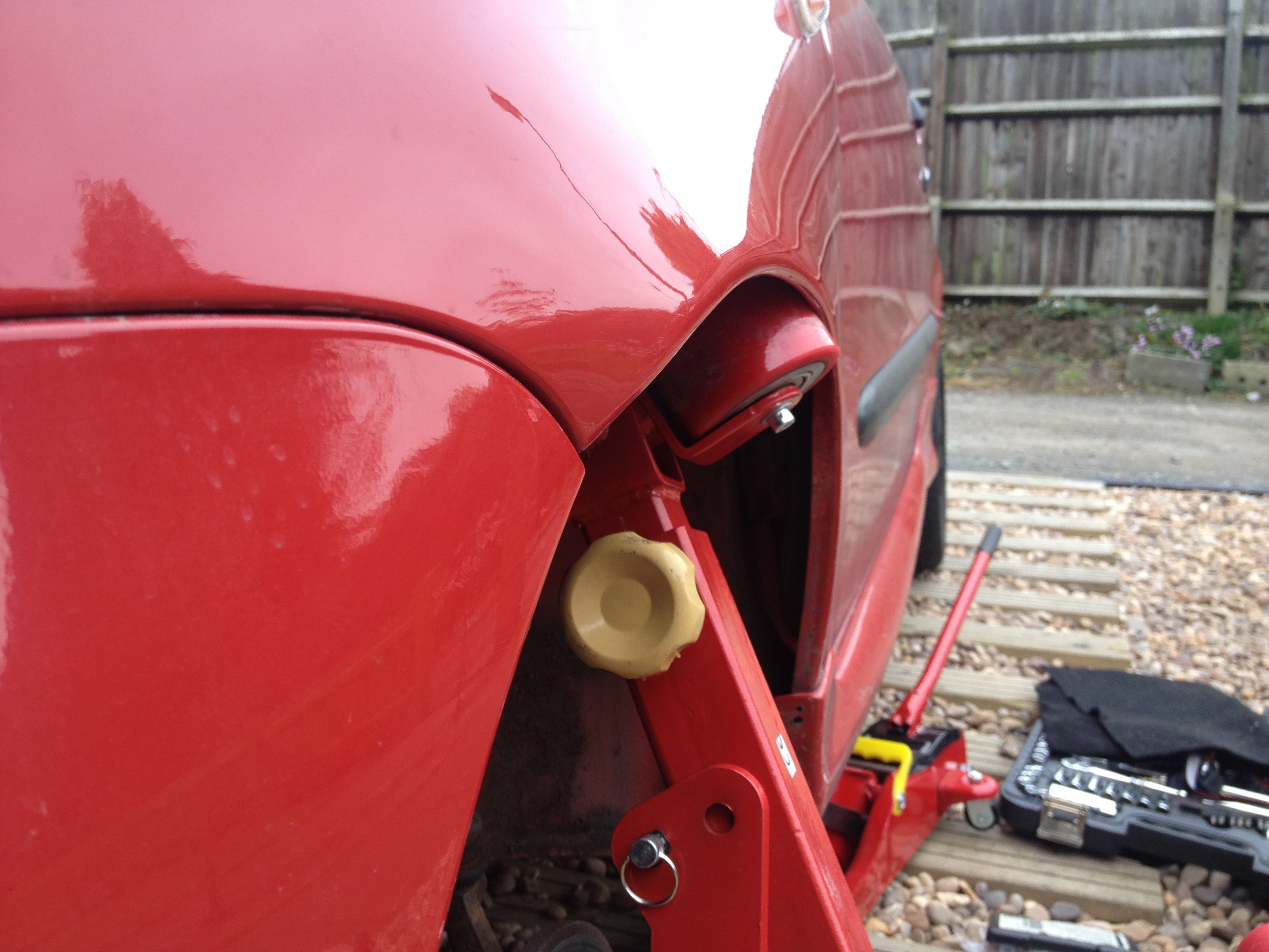

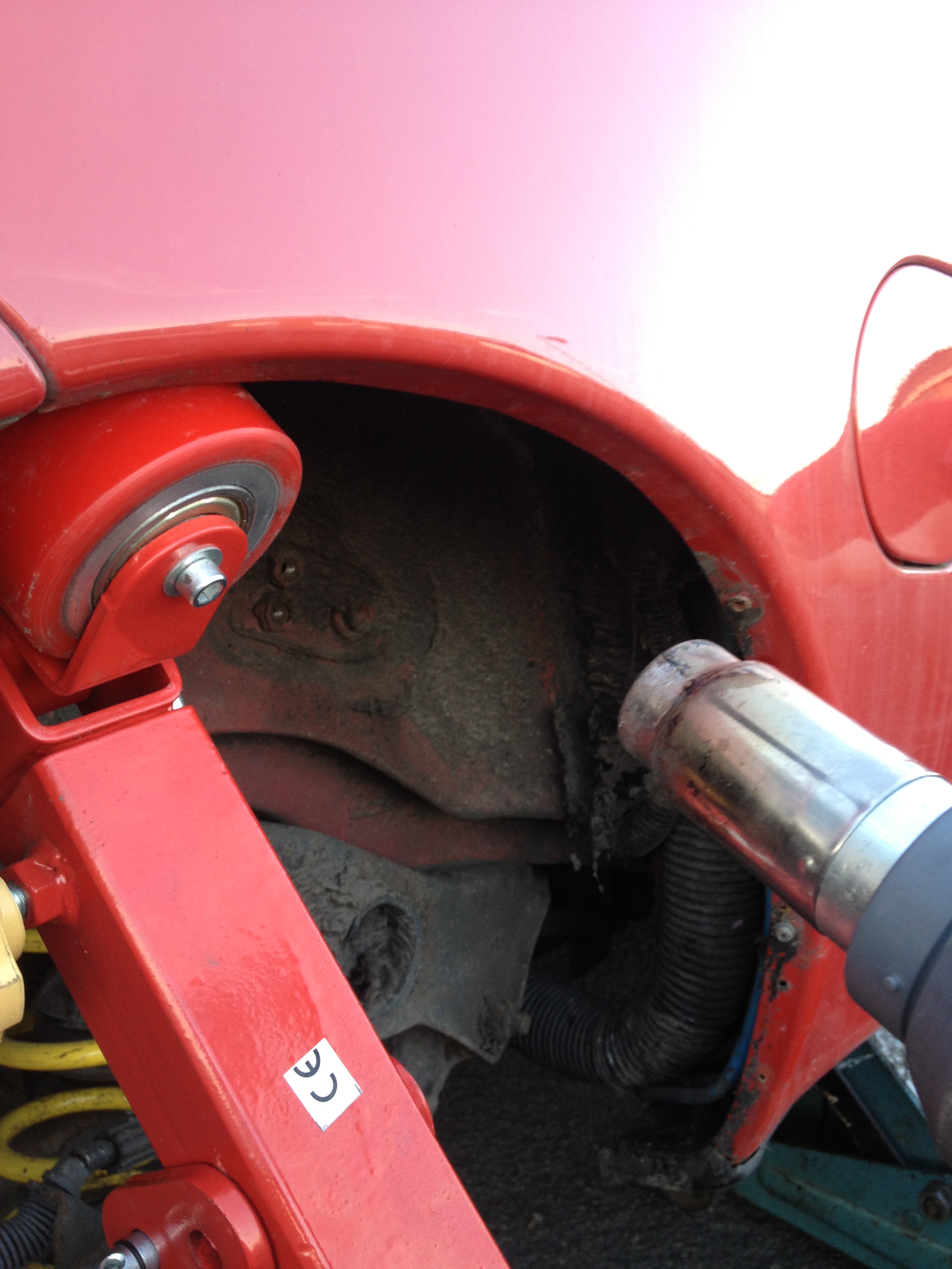

This beasty arrived the other day.... and today I put it to the test around todgers...
We tried to heat up the panel while rolling, but realistically the paint was going to crack, as I ended up flaring the arches about 1/2 inch... The bodywork paint is fine, its only the paint on the lip, which is temporarily covered now in red hammerite, until I have the time to seam seal...
The lip is completely folded onto itself, with the archwork being pulled out a fair bit...
The rear wheels, are in fairness a bit wide for the standard arches, 8j with stretched 195/45/14 rubber on...
However I do think they look cool!! The rears will need a 5mm spacer, as at the moment they are touching the rear arms.... The fronts I will be spacing also with the abarth spacers once I get time to remove them from the yellow donor...
Test fit (note todger sat in the boot, while the rear arm was jacked up to give an idea of clearance once ive adapted the springs haha)

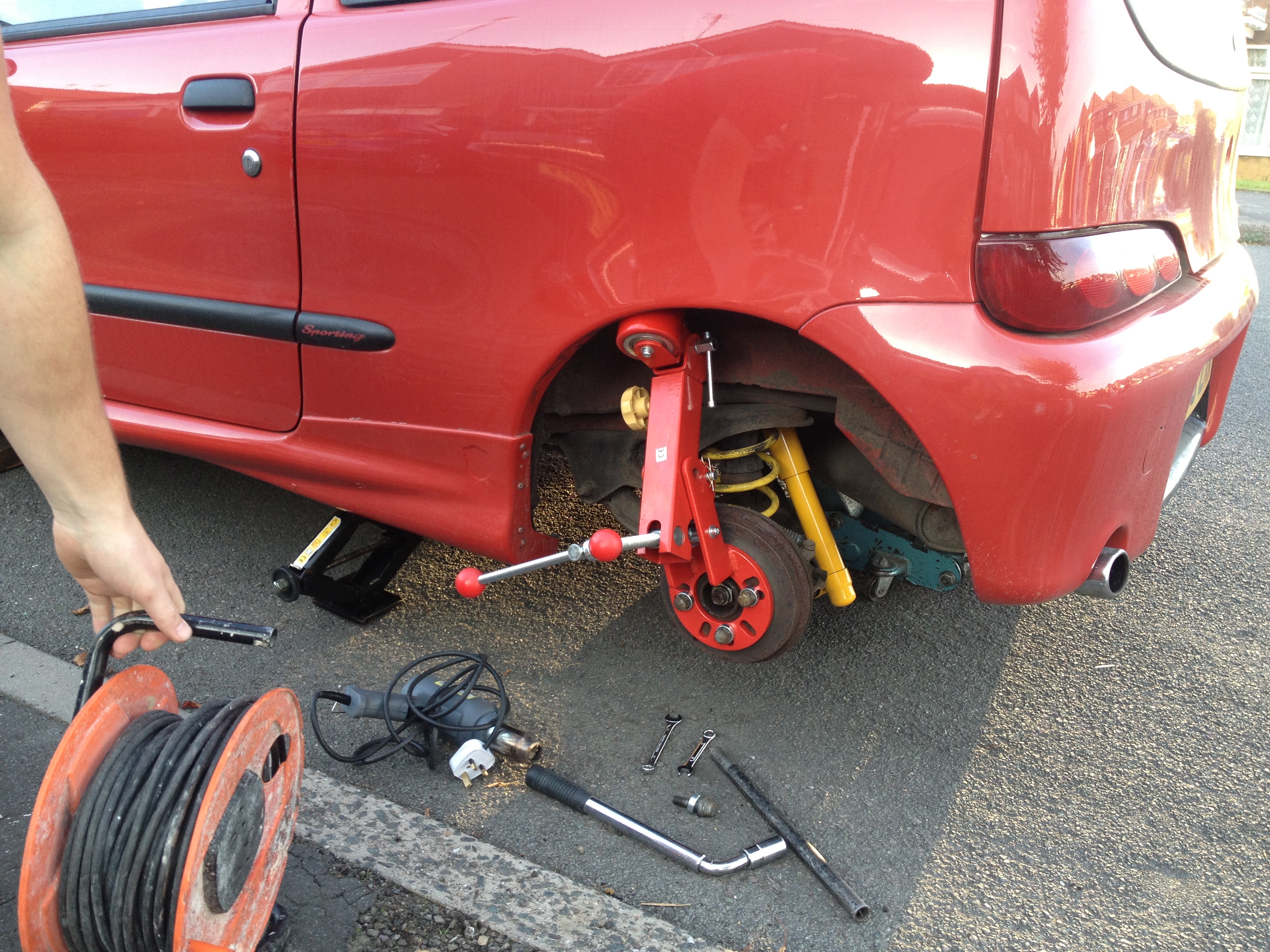

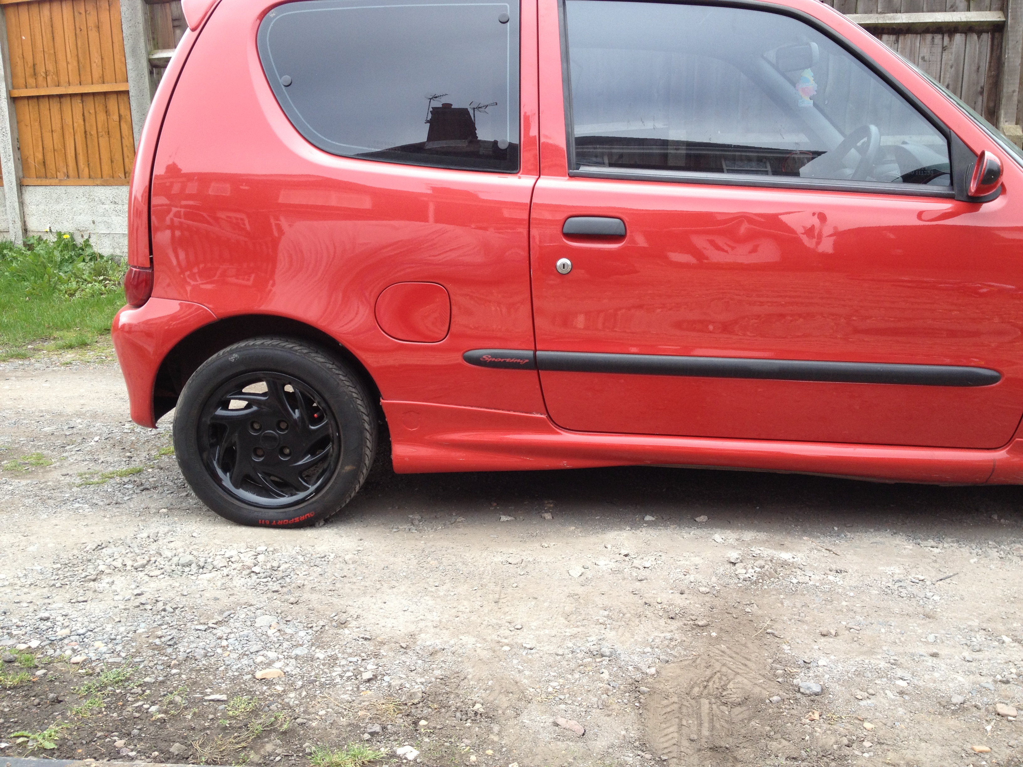

Well, attack of the arch roller part #2
The fronts...
Mash mash mash.... from this...
to this....
Mid rolling...
Final Flair..

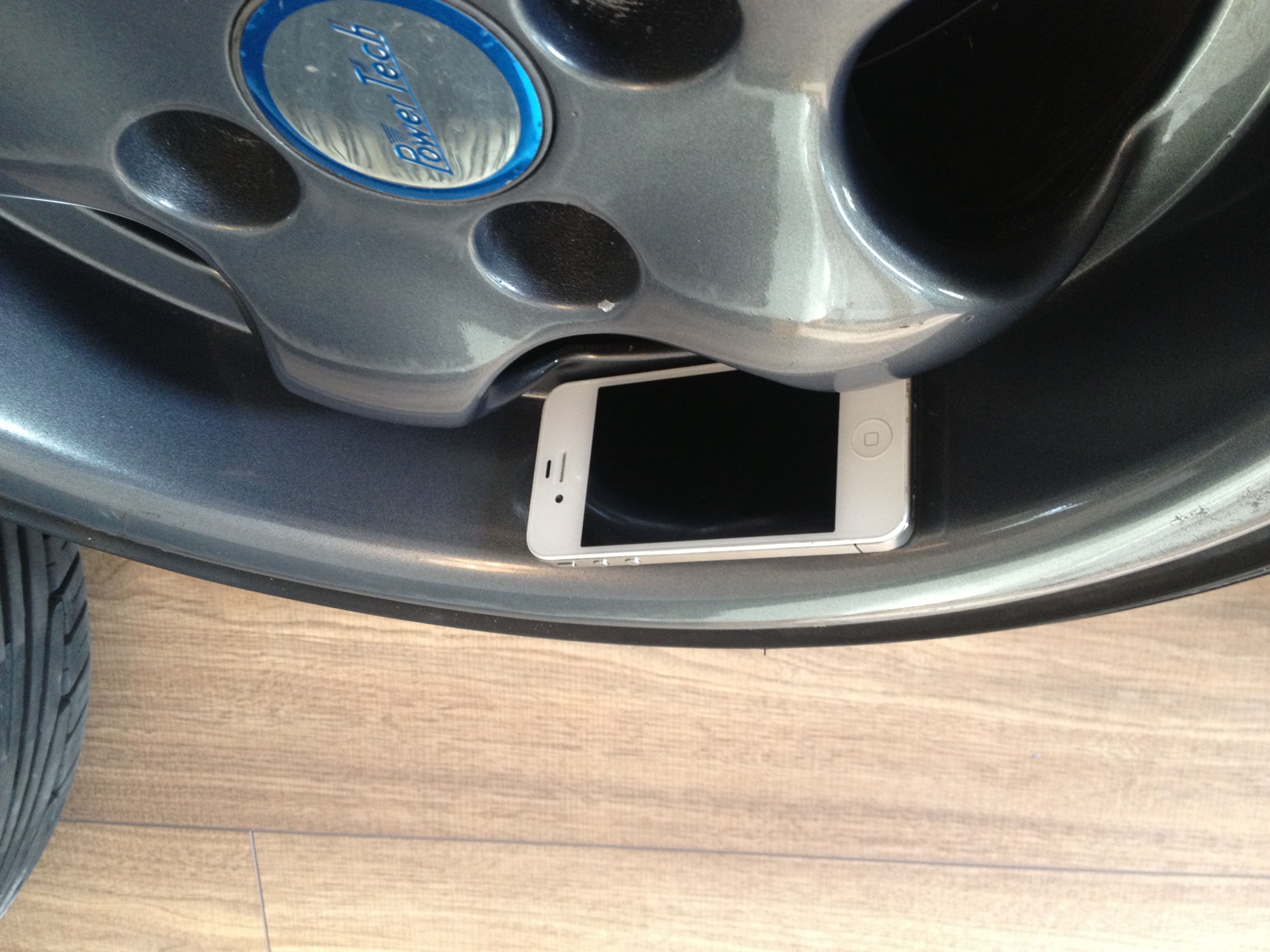

The standard iphone / dish picture lol....

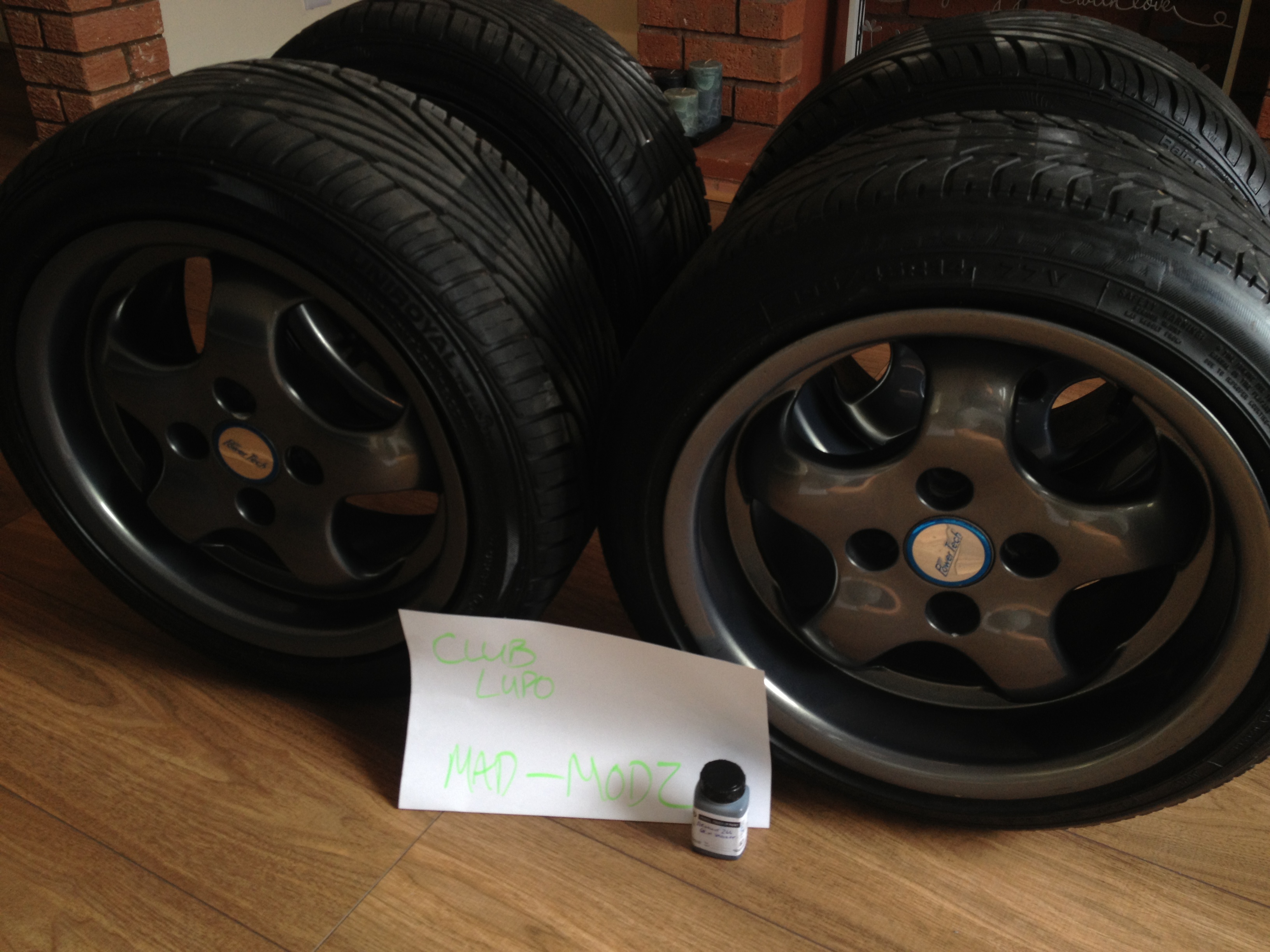

After a long hard debate, I then had the great idea of looking online for different wheels.... I still have a thing for the mini wheels (the ones with the better offset)... and now ive got rolled arches, I think they may be the route I want to go... As it seems pointless in going to the effort of sourcing uno turbo brakes, only to put big wheels on :p
anyhow, a picture was taken, and then a few posts made on the VW forums...
If anyone has some mini wheels, or abarths, give me a shout.... :p
