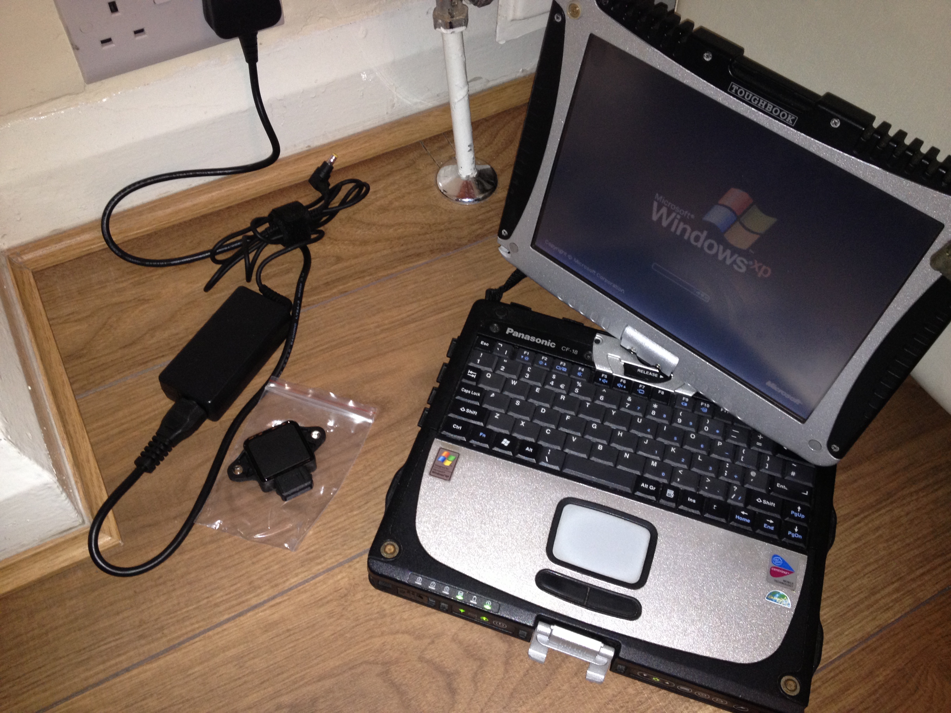

I've taken delivery of my new 'garage' laptop... Ebay Toughbook for £50 complete with serial connection and windows XP, so perfect for OBD2/vagcom and MS programs (vag for the van)...
I've also taken receipt of a TPS from a newer Vauxhall c20let engine, which looks like it should be a close enough fit for the uno turbo inlet, giving me a resistance rather than on/off for the MS (thanks Kritip)

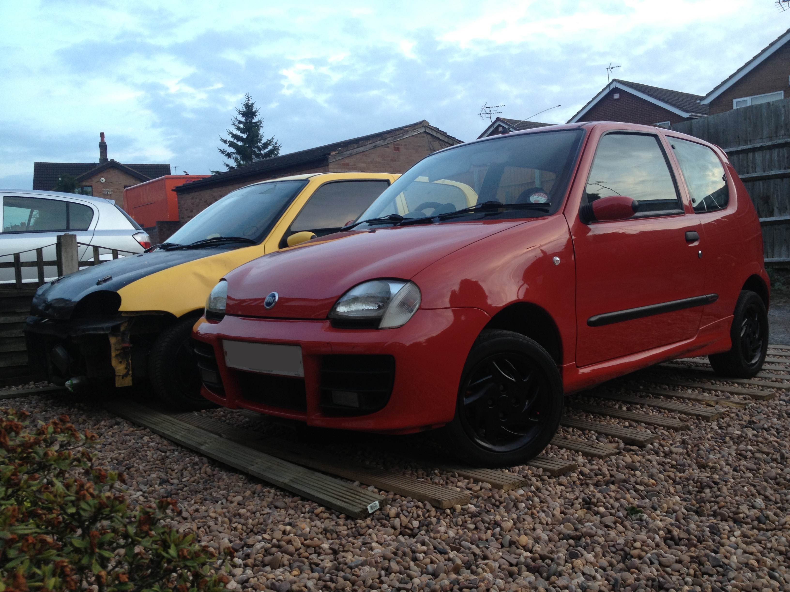

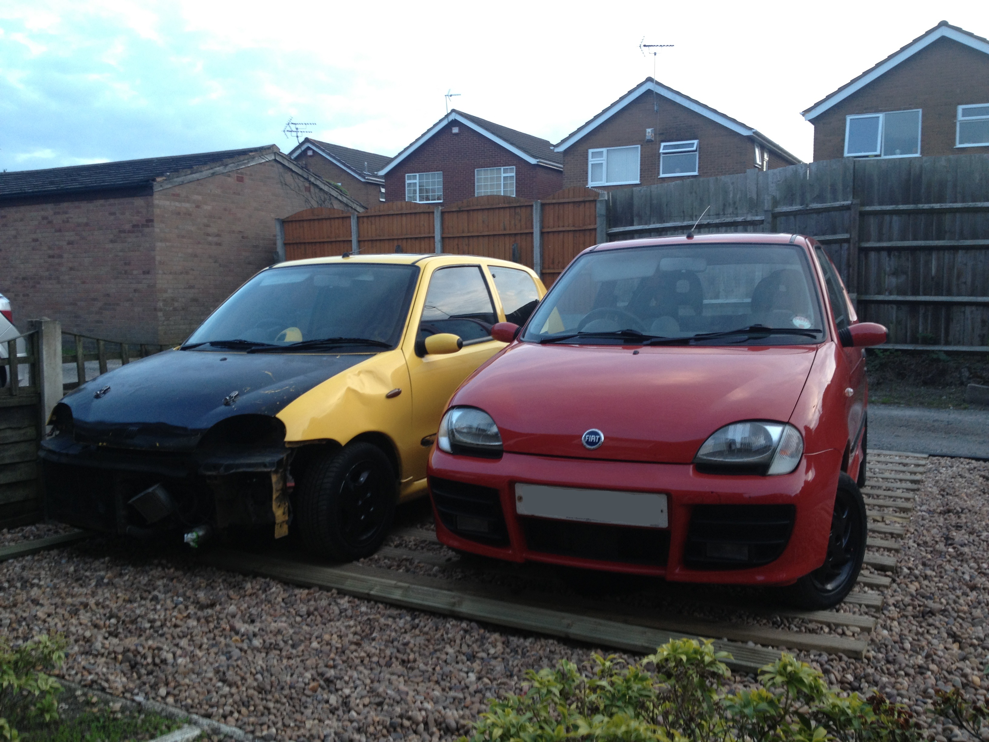

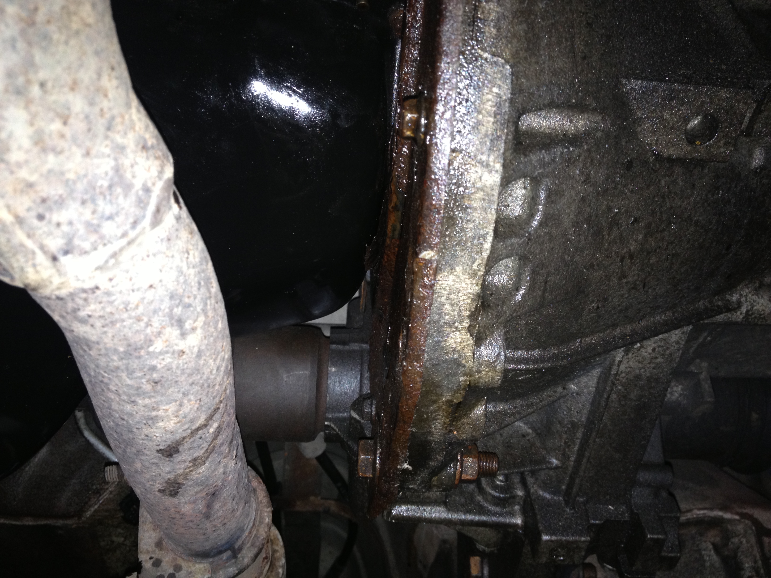

I've also collected my new Sei :D:D:D and found out why the owner sold it lol... thanks to a MOTHERFO of an oil leak :( (it was clean underneath when we viewed, and not so clean when I got home). I just need to work out where its coming from as its engine oil, and was all over the sump (which looks new-ish) and more worryingly the flywheel cover near the clutch (fingers crossed the crank seal hasn't gave way)
I don't suppose anyone has had a similar leak in this place? (was thinking that the sump may not be fitted properly on the oval cut out this side... cant think of anything else 'oily' nearby)
Its been cleaned up so I can leave overnight and look tomorrow
Other than that, its nippy, quiet and has somehow adopted moon buggy suspension....
Im desperate for some abarth wheels to tidy it up!!
Its now parked next to its donor :p

Just need to search the forum about this damn leak now haha...
If it's near the flywheel cover, I'd take consideration that the GB is leaking, and someone has put non-GB oil in there....they will typically run fine with the right grade!!!!! No that many folk know.
Could also be a load of other sources. De-gunk it and then look for the oil :D

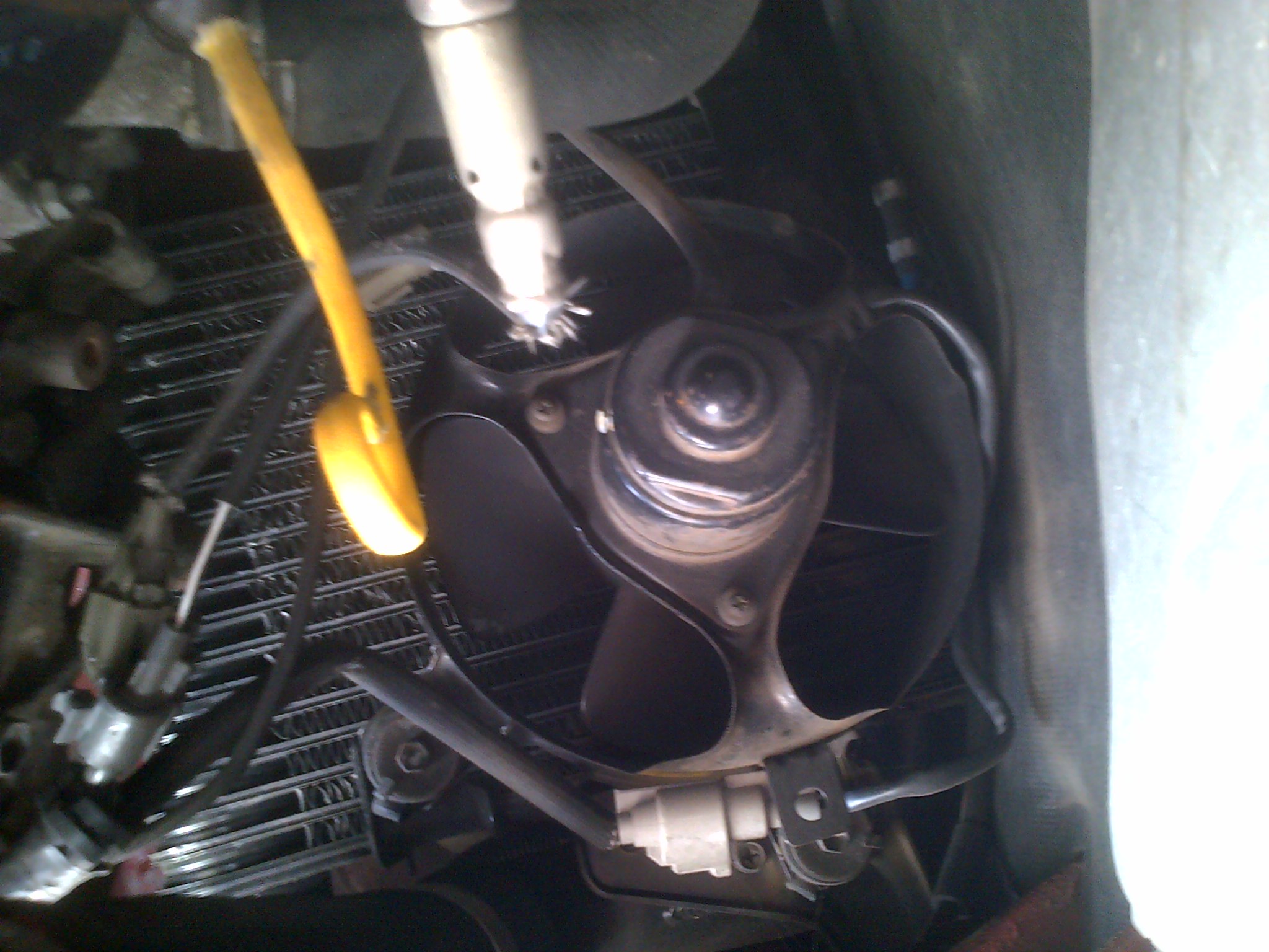

Not a very revealing photo, but access is difficult. Dimensions are approx 10" x 12". Ming can, I'm sure, offer better ones if he's got one out of a car! (Just noticed -- it's upside down!)
Note the fan! Due to the sub optimal placement of the intercooler, Toyota put a fan on, switched to come on when the under bonnet temperature reaches a (very) high figure. One mod is to shroud a 9 or 10 inch fan on instead -- the shrouding helps the fan be more effective.
Seeing the previous pic, I'd planned to put the oil cooler exactly where you want to put it, and duct it to the wheelarch.
That's a possibility. The proviso with using engine oil in the gearbox is you have to change it very frequently -- the gears will just sheer it to bits, effectively lowering the rating of the oil by destroying the viscosity improvers.
We always used to run the old bevel drive Ducatis on straight 40 or 50 for this very reason (still needed frequent oil changes due to no oil filters and petrol contamination of the oil).
Haha il clean it all up tomorrow and inspect for leaks... From what ive gathered on this forum it literally can be from anywhere, so will be checking the usual places (ie cam cover etc)
This is great, appreciate it as I think it will be perfect for the job :D
oh, u on about the leak on the red one? why do you care? You selling selling the block?
The oil leak is on the red one near the gearbox (and over the sump), im only bothered as im now using it as the main mode of transport. I don't like the thought of leaving a trace everywhere I've been.. (plus its quite bad by the looks of it)...
The uno gearbox on the yellow one I haven't even bothered looking with... I removed the gear cables on that, and manually tried to change gear using the selectors on the box, however no joy... The selectors move and its still stuck firm in gear... Ive looked into getting it reconditioned, but been quoted £500 + any broken parts (so basically just new seals, bearings and gaskets)...
