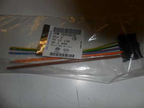

according to Cinqster355
https://www.fiatforum.com/grande-punto/288489-burnt-wiring-heater.html?p=3140382
if your plug is dead get yourself to a Vauxhall dealer :yuck: and order part number # 95508692
https://www.fiatforum.com/attachment.php?attachmentid=110463&d=1355438746
(y)

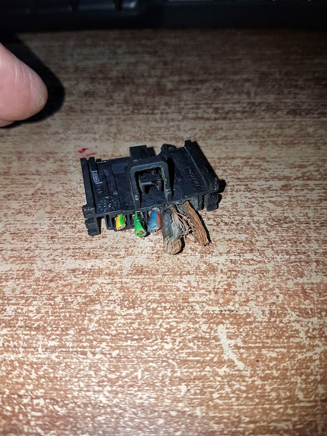

Picked up a Grande Punto last week, and one of the first issues I faced, was the fan would only run on setting 4
Had same issue as yourself, where it would not unplug, but with some gentle persuasion (brute force and ignorance), I managed to rip the plug apart from the resistor socket!
Needless to say, the whole thing is a total mess, as I can't even make out how many connectors are damaged due to them all being a fused mass.
Anyway, brought it for the NCT (National Car Test)/ MOT this evening, and it failed on no licence plate bulbs, and 2 broken front springs and an advisory on the heater/demister, so I will be attempting to tackle it shortly
So, I ordered a replacement resistor and a plug with trailing leads to tackle this job
When I finally got in and saw how bad the original one was, I was glad I got both parts!
I cut off the original plug, stripped back the ends of the wires, and crimped on some spade connectors, more connectors on the new plug, and then changed the resistor and fan is now working 100%!
