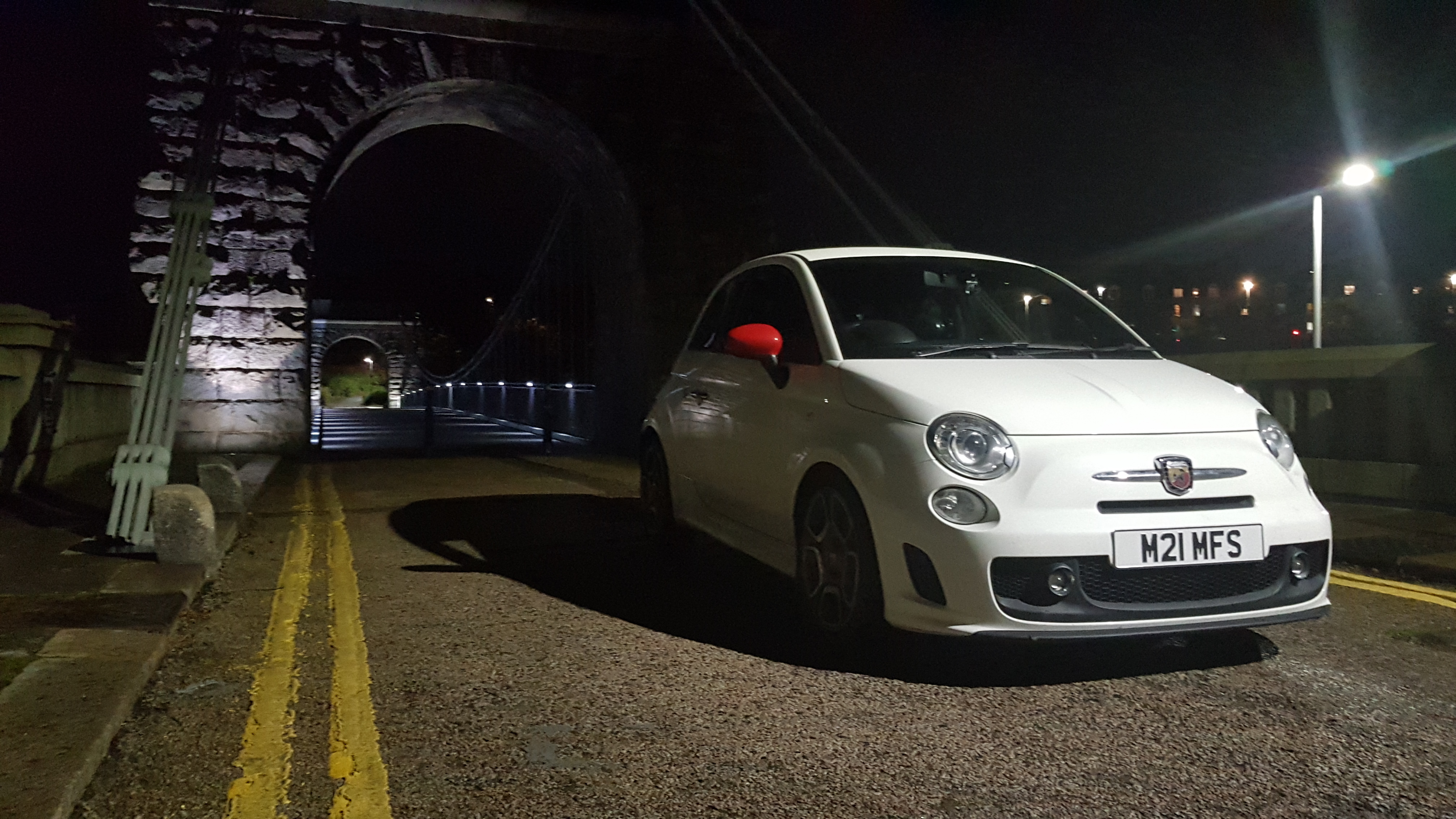

Haven't had a chance to do much lately, but I've managed to chuck some water over it...and add a new shiney up front :D
He did also get an interim service just before Christmas...big one due this year :/
