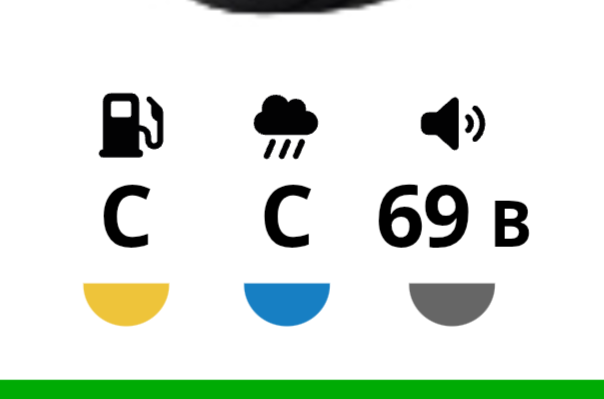

Toyo Nano Energy 3
69db is going to be hard to beat
Tyre pressure makes a difference
There's not much sound deadening in the panda, road noise will always be worse than a higher end car

These tyre noise data are for external drive by noise, and bear little relation to internal cabin noise, but I'm sure you know that.
