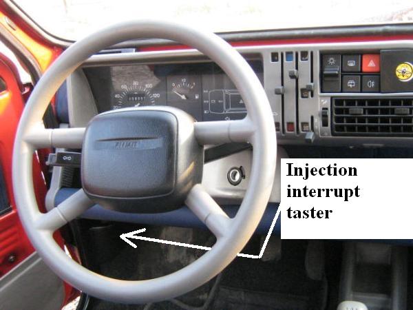

I think that pin 23 is only solution for your Panda. You can try to use one of connection pins, from fuel pump-safety switch = in cabin, down, near left drivers leg (under plastic cover). I think that one of safety switch pins -should be wiered directly to ECU - pin 23, so it is easiest to use this contact then to make something wrong directly on ECU.

Hi again, I think that we do not understand well?
Any case (left or right side steering weel Panda) on the left side in passanger cabin of your Panda there is plastic covered Protected)``Panic fuel pump-interrupt-switch`` near the left sitting driver (or co-driver). This switch has to interrupt fuel pump in case of strong punch to the wehicle. That ``Panic switch has two connectors, and one of this is connected to Pin 23 of ECU by wire. It is easiest to get signal for Tacho, from that point (wire-connector) than to open ECU and find pin 23.
I hope you do understand me.

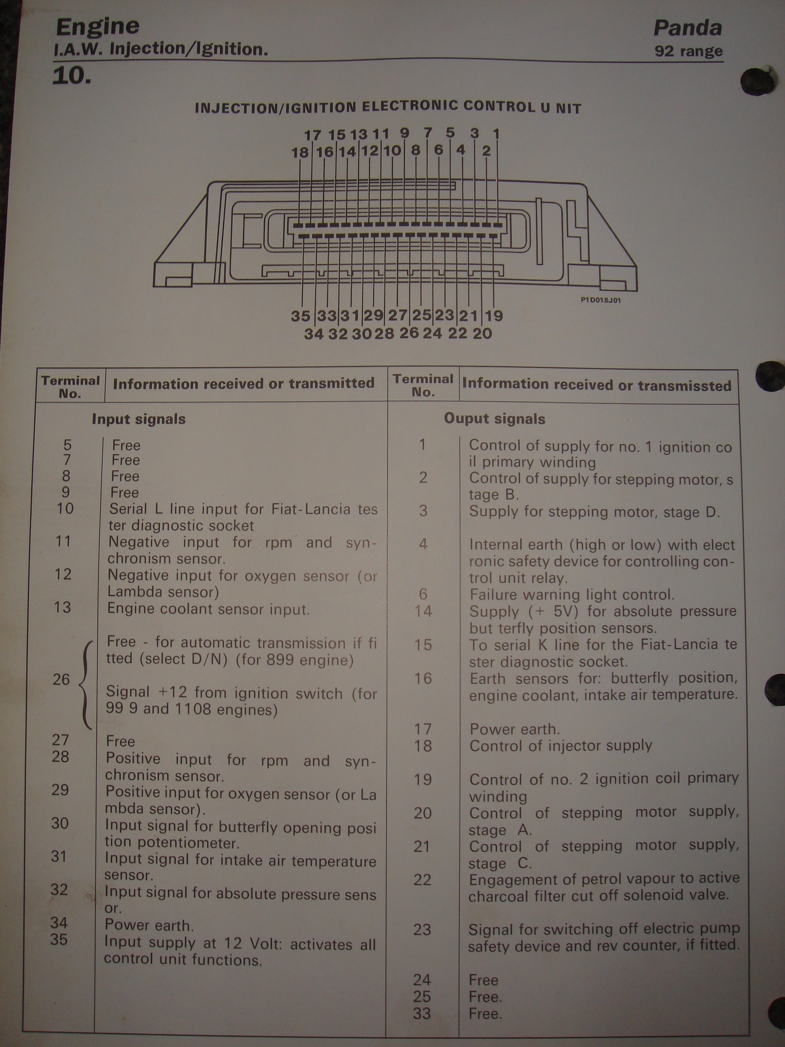

I can help!
I've got a 1993 1.1 Selecta with the twin coil packs, and had same problem when wanting to fit a techo meter back last year.
I'm luck enough to have a Fiat Dealership Manual, with the Wireing diagrams saying what pins on the ECU do what.
It is pin 23 with you need to connect to. Please see attached pic to find out how the pin numbers work. Bear in mind that the ECU is mounted up-side down under the cloth dash.
What I done to wire my tacho meter in was,
1. Remove ECU wiring loom. (don't need to remove the ECU)
2. Have the signal wire for the tacho meter with a frayed end.
3. Feed this into the ECU where pin 23 is.
4. Whalst holding this wire in place, re-place the ECU wiring loom to the ECU.
This sounds difficult but is really easy! You'll understand what I'm saying more if you print this off, and read it whalst doing it.
I've not had any problems with my tacho wiring it this way.
I wouldn't suggest trying to cut into the ECU wiring loom to fit the signal wire to the wiring loom, because if you muck up you will render you Panda useless unless its all rewired! This would be costly and timely!
Hope it helps, let me know how you get on. Jon.

Thanks Most Easterly Panda's YOU ARE GENIUS!!
This diagram is almost imposible to get! Have any more diagrams about ECU in Panda 1.0-1.1?? It would be great if you can sent something for me...my email (will send on PM)
Thanks AGAIN - tomorrow I'm going to fit it:)
