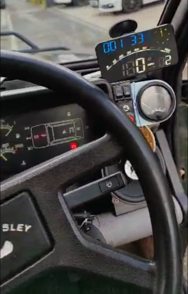

RPM gauge/tachometer can be fitted but it has to be an after market one. i did it in a Fiat Cinquecento and i took my reading from one of the 2 relays in the engine bay. i think one relay is for the fuel pump and one relay is for the fuel injector. it is that one i tapped into. sadly you would have to use an after market RPM gauge as it was never an option for a Fiat Panda to have one fitted.
my panda is old and uses a distributor so i can cheat and get my reading from the coil's earth (via distributor). the RPM gauge i have is a very old gauge from the 1940s but it does look good and just sits on the side of the dash pod on a bracket i made. i will see if i can find a photo... see attached.

sorry never attached the file!

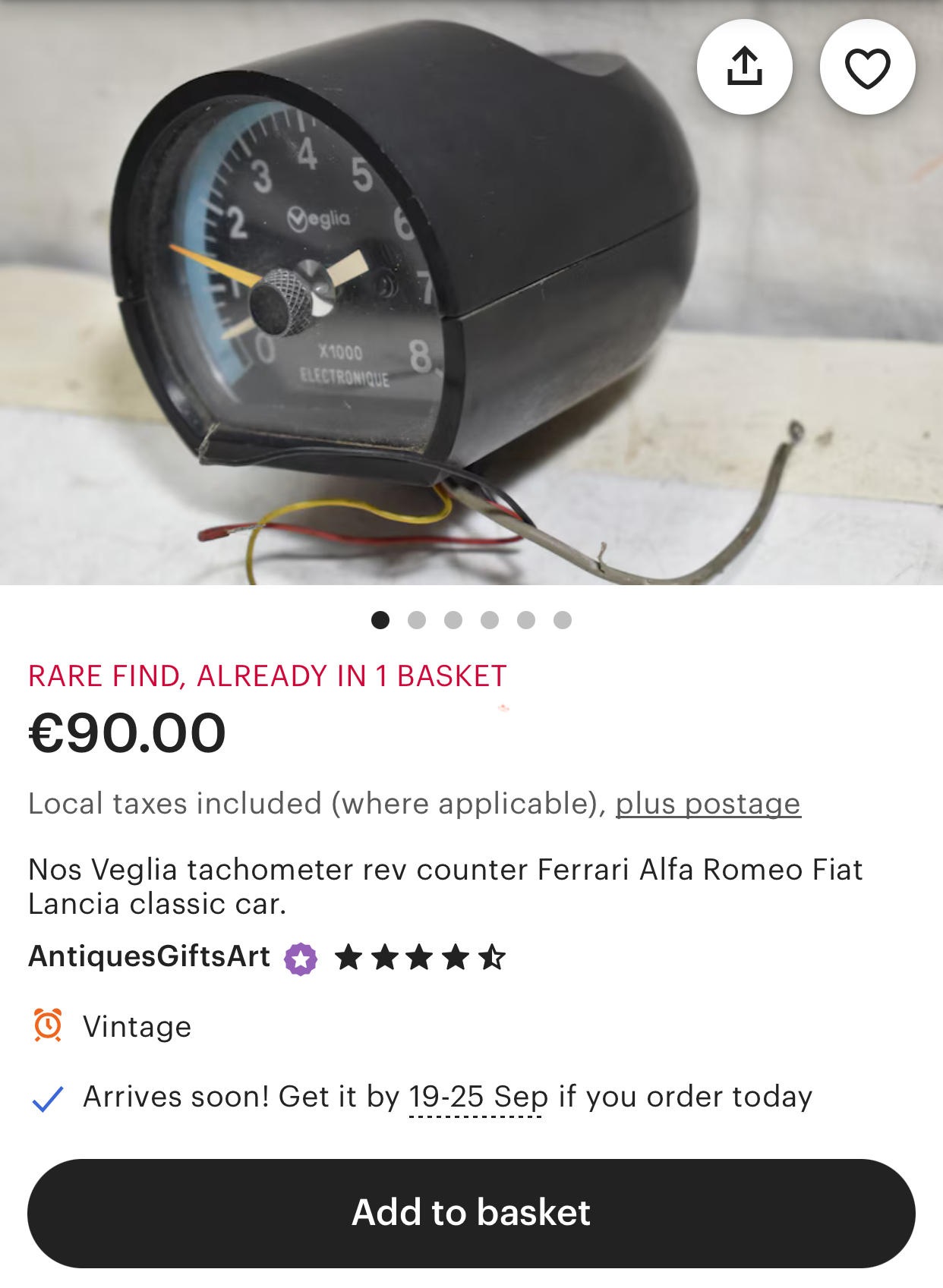

I bought a Veglia Tachometer some years ago off EBay but haven’t attempted to fit it yet, similar to the pic.
