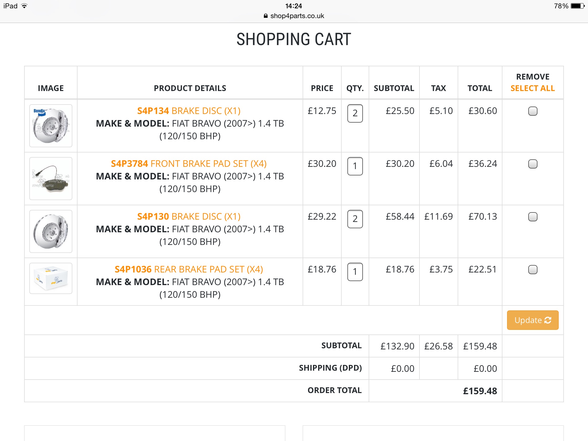

Yeh I tried shop 4 parts, they were actually quite expensive in comparison. Using their cheapest parts and not including delivery it came to £160
