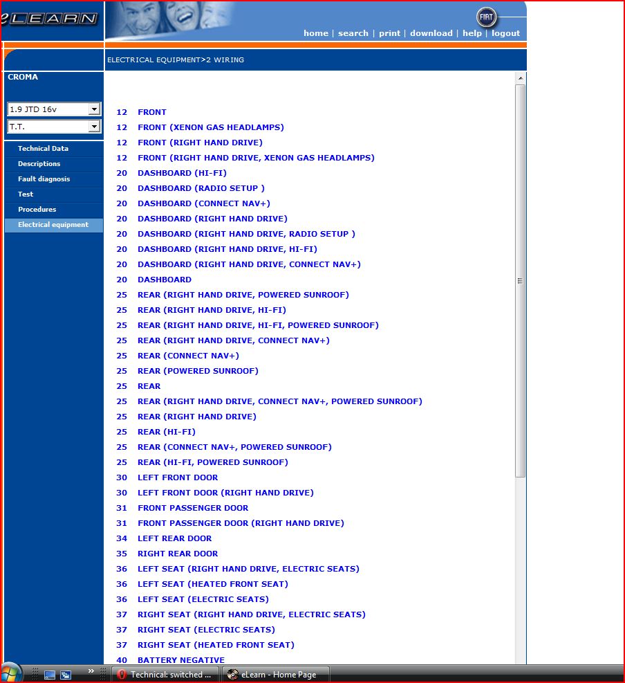

You need to download all 8 parts into the same folder, then point WinRAR at part 1. That will unzip all 8 parts into an image file named "Croma eLEARN.iso"
Use the image file to burn a disc, then install eLEARN from the disc.
yay think i've found it. an with no disc used at all :slayer:
