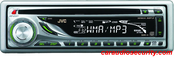

Ok, a JVC KD-G321 MP3/CD/RDS radio arrived from Fleabay, today, 4 x 50 wattsrated, or 4x19 watts RMS. Nice silver coloured unit, plays MP3 cds with up to 512 tracks, has disk and folder random MP3 playback. Also has a stereo pre-out on the back and mobile phone mute sockets if you want to add even more stuff to your ride. Total price £66.98 inc courier delivery.
Eagerly willing to go where no human eye has ever set foot I chopped up a wire coathanger into four 20cm lengths, pushed them fully into the four holes in the radio, and pulled out the Panda Blaupunkt CD radio. On the rear are two plugs for the power and speakers, plus a multi -coloured plug to feed the dash display with station and CD information. The JVC comes with an ISO adaptor cable, just plug this into the two power/speaker leads. Ignore the multi-coloured leads and tuck them away at the back of the radio.

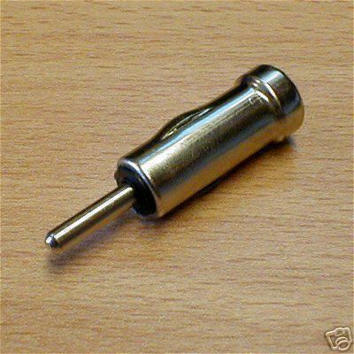

Next you need an ISO-DIN antenna convertor to convert the right angle Blaupunkt antenna plug to fit the back of the radio. (£1.70 inc postage). Then you need a fascia convertor (£16.99) to cover up the gaping hole left by the huge standard CD player. You gain a little cubby hole to put your shades in, too.
The JVC unit sounds noticeably better than the original unit, is louder with better bass punch and treble definition, and the ergonomics are much easier than the Blaupunkt. MP3 CD playback is excellent and folder navigation is easy, - as long as you've lablelled your folders 01,02 etc. If not the unit navigates through them with the <<->> button.
Excellent upgrade, depsite having to buy the extra bitz. Other single-DIN Jap radios might need the same fascia plate and possibly the antenna adaptor to upgrade the stock Panda CD player (but not the cassette radio - see Mark's post above for upgrading the Fiat Cassette radio. )
Total costs: £85.67 inc postage.

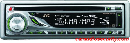

OK, here's mine, the JVC-KDG321 MP3/WMA CD radio in the Panda with the new fascia adaptor. The display is scrolling 'JIM MORRISON'
I don't know why.
4 x 50 watts music power! Yay! Seems much more powerful than the original Panda radio, more bass, more Wombles. Everything!
