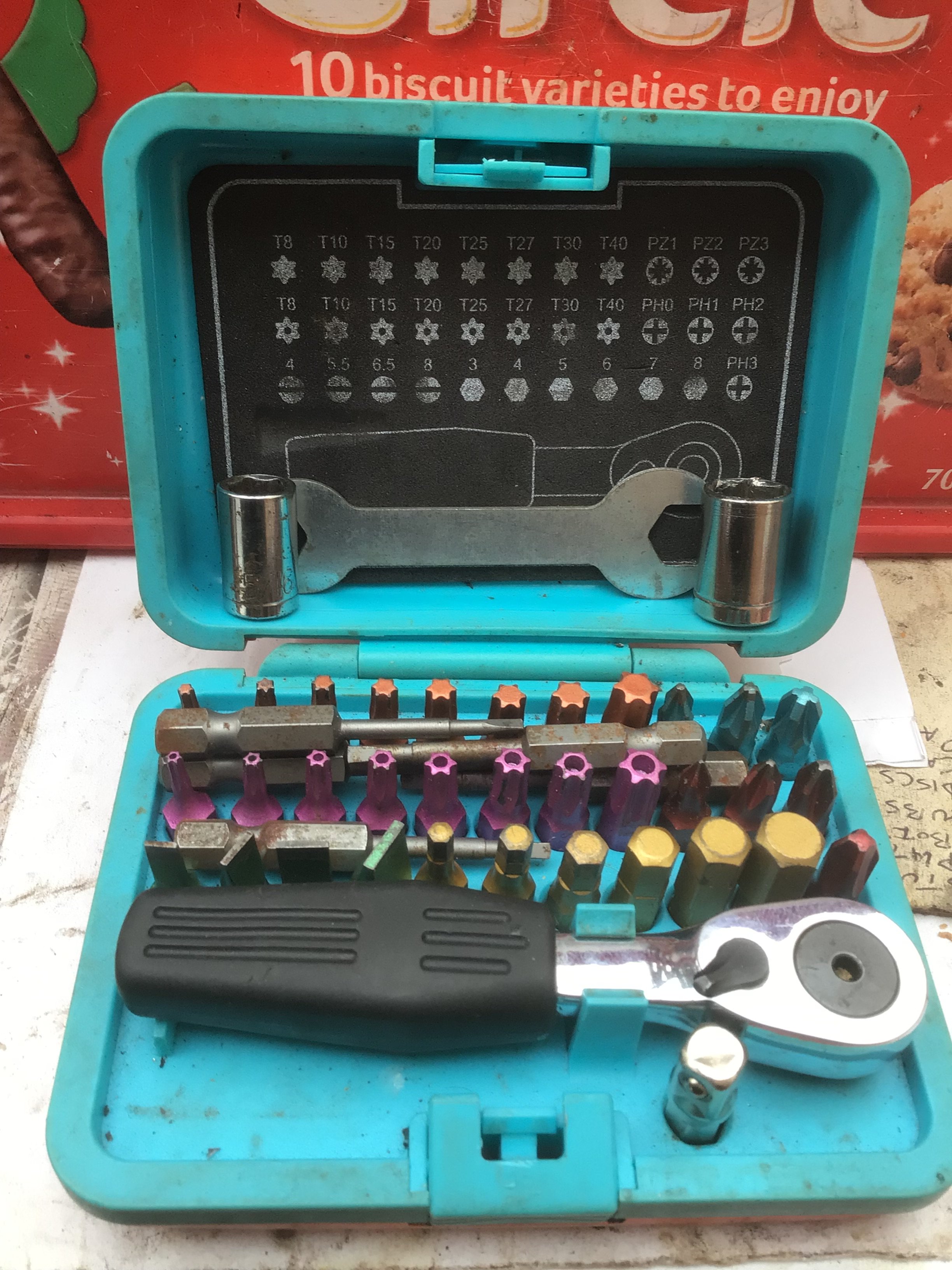

I agree with Peter---the first thing that I would look at would be the float. The top cover of the carb CAN be removed with the carb still in place--a (very!) small ratchet spanner and one of the little screw-driver 'inserts' being the best tool. Give the float a shake--if it 'ratttles, there will indicate that there is fuel in it, and you will have to replace it; they can't really be repaired. Before you re-fit the carb's top cover, you will have to make sure that the float is adjusted corrctly, again, not a difficult job.

My tiny set from Halfords, sooo useful 😀 especially when I fit a small 8/10mm sockets and spanner in the box.
