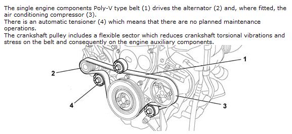

The auxilliary drive belt goes around the crankshaft pulley, alternator, air conditioning compressor, 1 automatic tensioner pulley and 2 guide pulleys as in the diagram below.
The power steering is fully electric using an electric motor mounted in the steering column behind the steering wheel. It will only work if the alternator is charging, so if the auxilliary drive belt breaks, the power steering will immediately stop working. (Not good if you're making a turn at the time).

Devren you've been a great help. Do you think you could point me in the right direction for what belt I need? A quick search on eBay and I found this: ht.tp://bit.ly/18wHczS.
(Please remove the fullstop between http as I am not allowed to post URL's due to my post count)
There seems to be so many variations, 815mm, 819mm, and other numbers that all seem different from one another. I'm at a loss as to which model I need.
Thanks a lot
819mm seems too short for the auxilliary belt for a JTD with air con.
If you want to PM me your VIN (left click on my username to the left of this post and select "Send a private Message to Davren", I'll get the Fiat part number for your belt. From that, you can get comparison numbers for an aftermarket belt.
