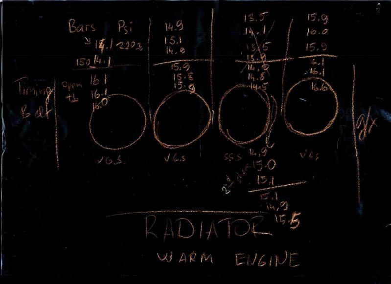

So folks, sorry, couldnt do test yestarday as promise, i was after nightshift, simply didnt wan gou outside, so did today.
Engine testing with tool like that - http://www.ebay.ie/itm/290377167798?ru=http%3A%2F%2Fwww.ebay.ie%3A80%2Fsch%2Fi.html%3F_from%3DR40%26_trksid%3Dm570%26_nkw%3D290377167798%26_fvi%3D1&_rdc=1
and went with results like that.:
third cylinder (from timing belt side) i was testing twice, as there was no room to tightening up that bloody thing, and second time manage get more tight.
Any suggestions, and comments about pressure ?
I have no idea about, how good or bad that pressure is.
First three readings with throttle closed, and under line with throttle fully open.
ive inverted your picture to make it more readable
what action did you do in relation to post 5/?
Thanks for re-doing my picture :)
Nothing yet with thermostat. will do tomorrow. :)
So, today got her till temp red line, even till middle of red line on temp scale. Checked pipes, strange, ... top pipe warm, botom barely worm, in same time engine on red line, and coolant on proper level on rad..... any idea, what could cause this ?
